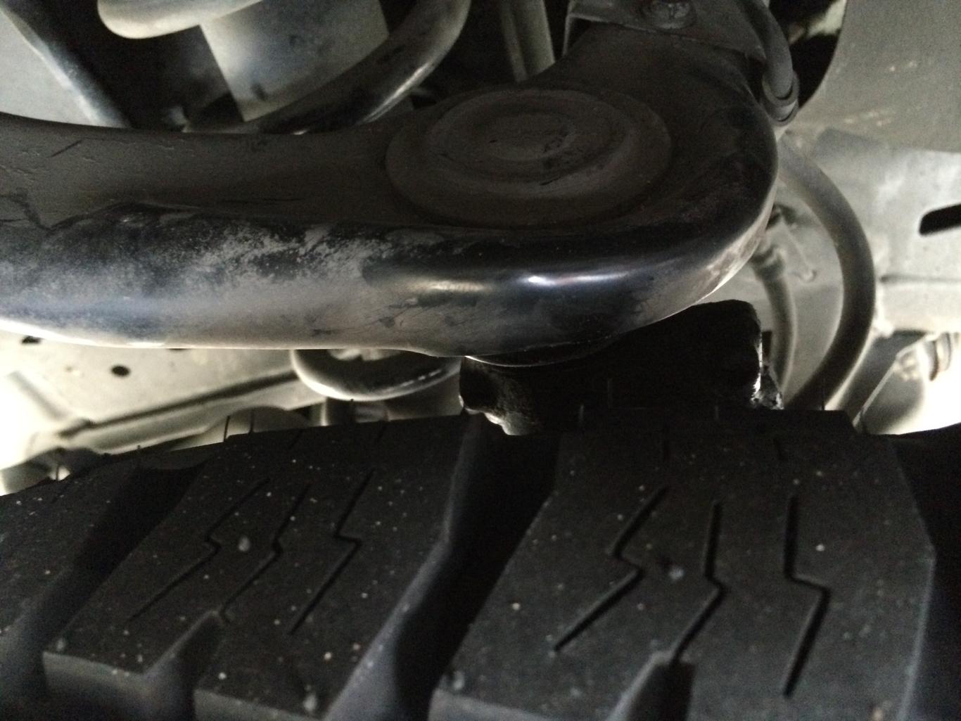

If you're trying to fit a 33 inch tire, it will rub. It will rub the front bumper, it will rub the front mud flap, it will probably rub the A arm.
with an 18 inch offset, which is wider than stock, my 285, 31.26 inch tire JUST BARELY clears my A arm

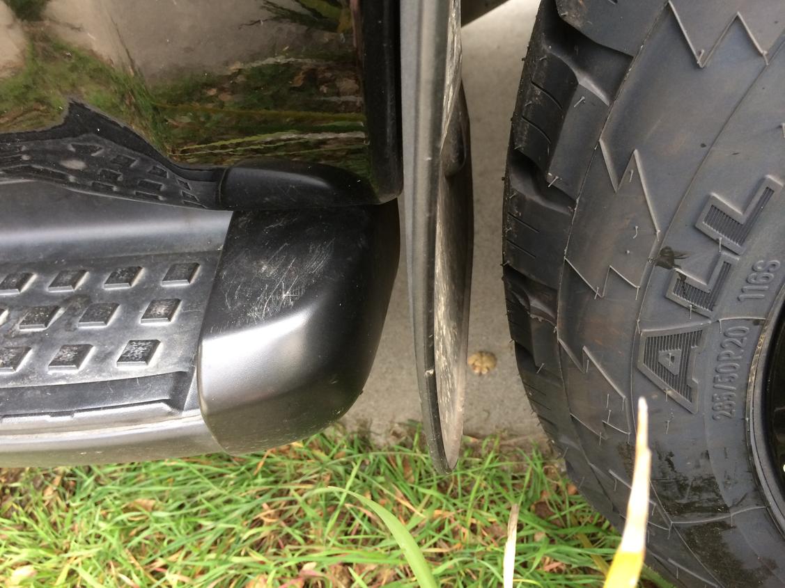

I had to trim about an inch off the corners of the front bumper, It's not difficult to do this and I made it look nice, and it does rub the front mud flap when I go in reverse and crank the wheel.
In my opinion, from my experience of what I went through with this lift and tires, don't go bigger than a 32 inch tire with the lift kit, and if you have stock rims, You just MIGHT need a little spacer to not rub the A-arm.
Here's some pics to show you- this is the clearance from A-arm to tire, NOT MUCH space, less than an inch

This is the front bumper after I cut away an inch, maybe an inch of clearance now

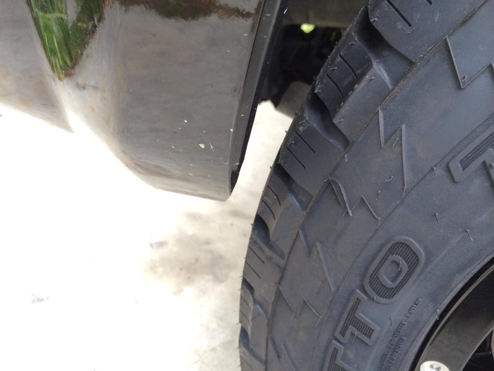

This is the front wheel well, the mud flap is really close! rubs just a little when I go in reverse and crank the wheel, I'm going to trim the part that rubs
