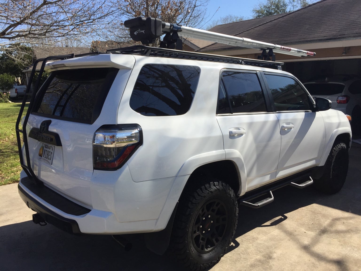

I go fishing every weekend with my brother and we usually bring about 8 poles between the 2 of us so I had to rig up something temporary until the rack I want is ready. Emailed the company last week and they are about 6 weeks out from releasing this.
ROD-UP interior rod racks for SUV?s, Wagons, Vans | RODMOUNTS
I will post pictures of if when I get it installed.

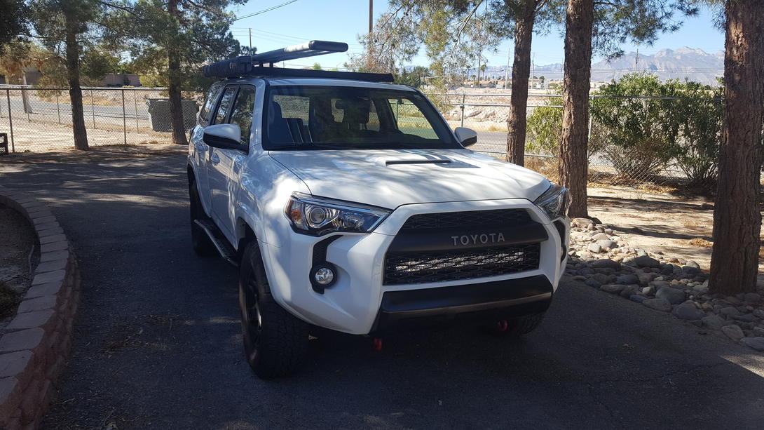

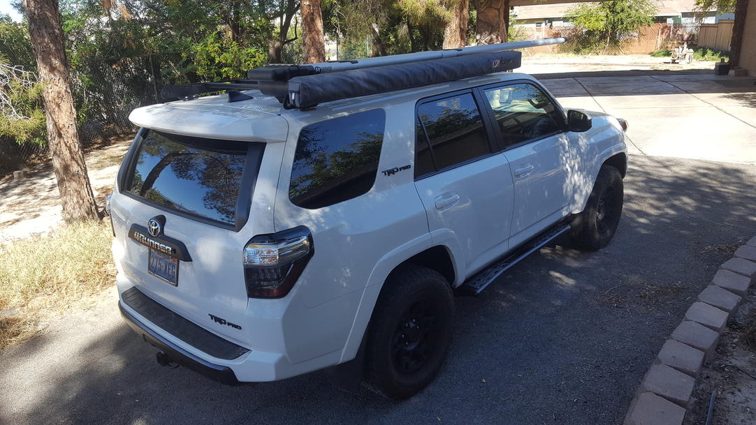

With my Prinsu 7/8 rack, the forward mount is just barely in front of the coupler. I also had to remove the last crossbar to get it to fit between the rack and the rear hatch when it's open.

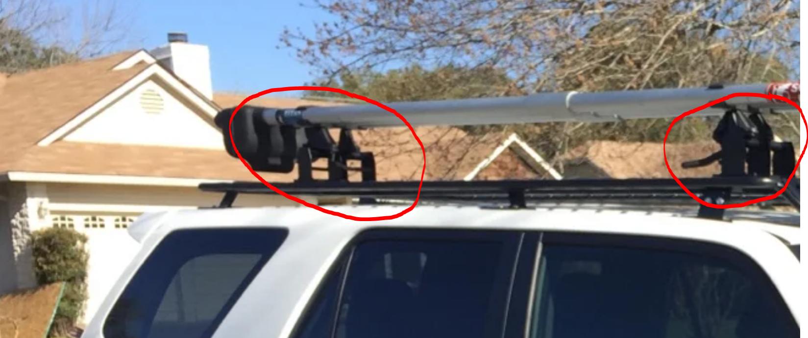

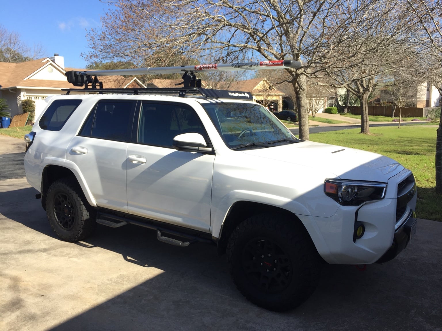

Picked up a refurbished Titan Rod Vault at their factory...perks of them being based in Denver! After plasti-dipping it anthracite grey, installed them today. If you use the stock TE cross bars, you'll need two spacers for the rear mount, and shorter bolts up front.
Guys at Denver Outfitters were awesome...they already knew what the 5th Gens needed, so he gave me four spacers, which are just the bottom part of the clamp with the threads drilled out. He drilled them out for me real quick. The spacers lift the rear clamp up about an inch so that you can actually open the case. Our 5th Gen cross bars are so close to the roof of the truck. This is the reason for shorter bolts up front...cost about $4 for four 1-1/4" bolts.

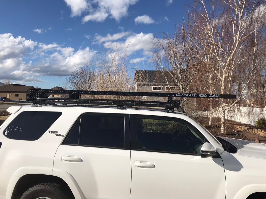

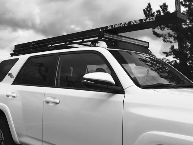

After a YEAR, yes, a freaking year, of Denver Outfitters holding onto my money, I finally asked for a refund. The refund process was full of lies, delays, and more lies, but I finally received a refund. The next day I bought an Ultimate Rod Case. Delivered in a week, exactly as promised, and it is AWESOME!
I finally bailed on Denver Outfitters and bought an Ultimate Rod Case.
It’s bomber and very secure.

Price was higher but the product is far superior and it holds four rods. Communication was exceptional. I had a lot of questions before purchasing because I was trying to ensure that it would fit on the Gobi Stealth rack and still allow the rear hatch to open. Earl was super helpful and sent me the right spacers to make it work.
Install was easy. It has a bottom plate that runs nearly the full length of the bottom on each side. You choose where you want to drill through the plate to accommodate your rig. I spent less than $5 on the mounting hardware. Fits perfectly and after a 16 mile dirt road excursion this weekend, I know it’s staying put.
Check them out at Ultimaterodcase.com
I bought the 10’ four rod model.

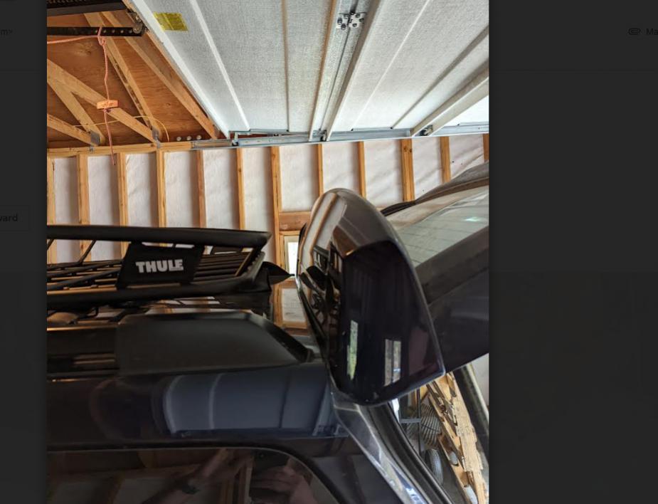

Hey there, it is a long shot that this gets you so long after your post but it is worth a shot.
I noticed your pics of your 4Runner with the titan rod vault. From what I have seen, it appears to be the first set up that might work for me.
My Problem:
I am very, very interested in a rod vault but I'm afraid I would have a bit of an issue with my roof rack and clearance with my hatch which opens upwards. Basically, the rear tailgate/hatch when in the upright position goes past horizontal. Clearance between it and the rear of the roof rack is only a couple of inches (see attached photo with hatch fully open).
Vehicle: 2021 Toyota 4Runner TRDRoof Rack: Thule Canyon Roof Mount Cargo Basket with Extension (mounted as far forward as possible)
What I am thinking:
I can still get at the crossbars (that the basket is mounted to) and I am thinking if I can get enough height, like yours, I might be able to just squeeze a rod vault in there.
My question to you:
What are these "risers" in your photos (see attached)? How can I elevate my vault that critical 3 or 4 inches so that I can clear the lip of my hatch?
