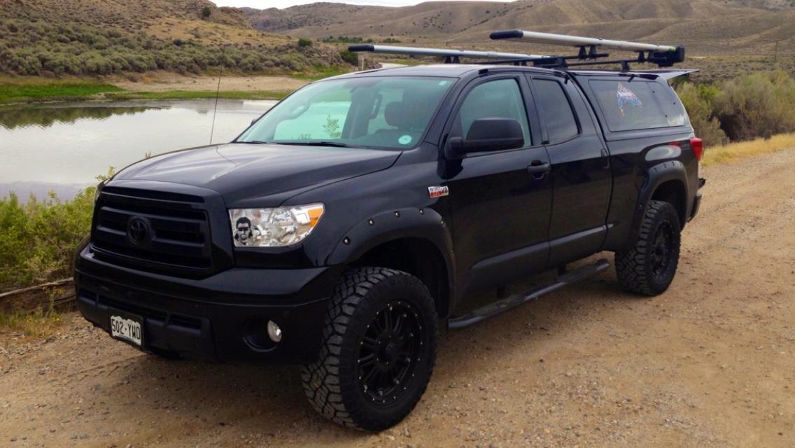

For those that aren't familiar with them

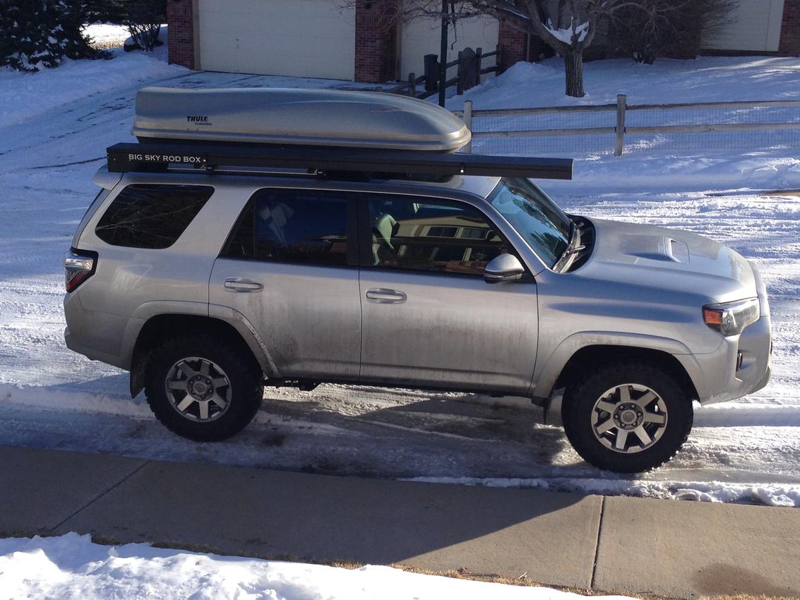

Bit the bullet on a Big Sky Rod Box. Very well constructed and going to get a lot of use this year.

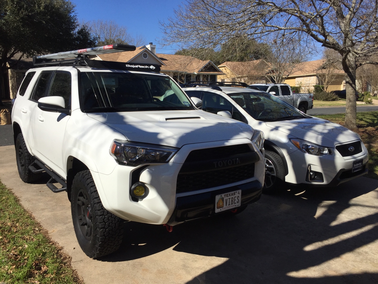

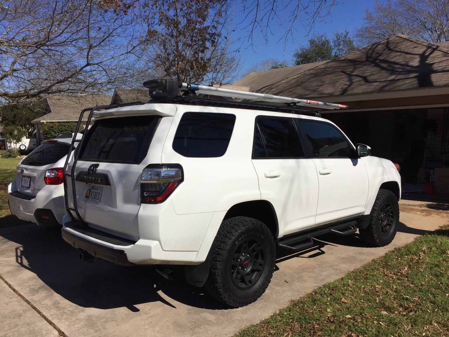

Update: the rod vault works with the Baja adapters but it's super high up. Decided to leave it off for my 2k mile road trip.

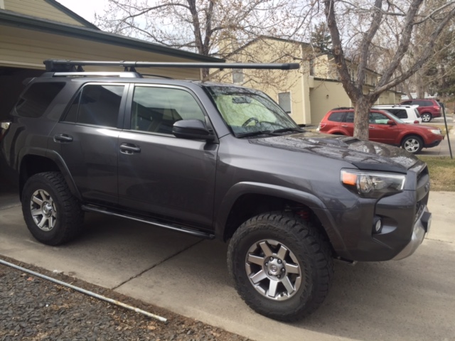

Picked up a refurbished Titan Rod Vault at their factory...perks of them being based in Denver! After plasti-dipping it anthracite grey, installed them today. If you use the stock TE cross bars, you'll need two spacers for the rear mount, and shorter bolts up front.
Guys at Denver Outfitters were awesome...they already knew what the 5th Gens needed, so he gave me four spacers, which are just the bottom part of the clamp with the threads drilled out. He drilled them out for me real quick. The spacers lift the rear clamp up about an inch so that you can actually open the case. Our 5th Gen cross bars are so close to the roof of the truck. This is the reason for shorter bolts up front...cost about $4 for four 1-1/4" bolts.
