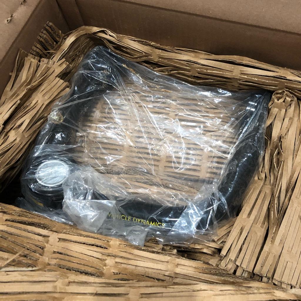

- Stoptech ST60 BBK (being rebuilt - 7/2020)

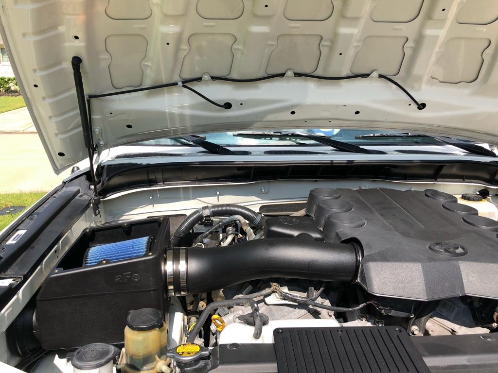

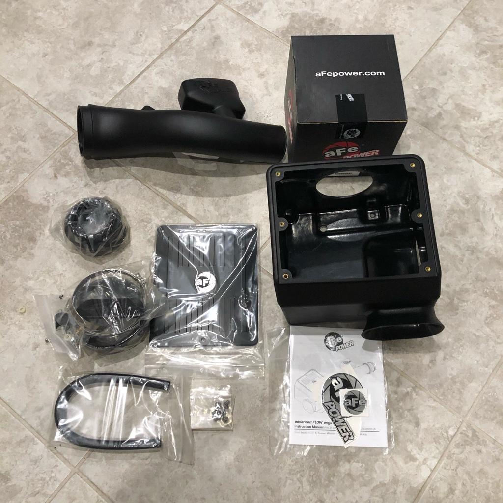

- aFe intake with "coupe" TRD aluminum cover

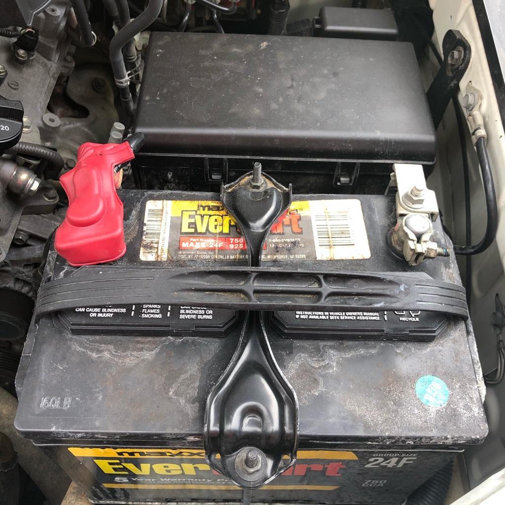

- 5th gen 4Runner positive terminal cover
- eBay negative terminal cover
- Fumoto F-133 oil drain valve

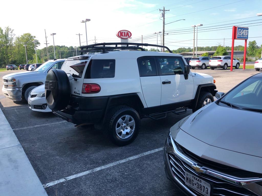

I went ahead and rented a car to drive up to Nashville and drive her back in the span of two days. Unlike the 4Runner road trip, I have much less pictures with the FJ on the road home. With the whole situation the world has been in, there wasn't really much time to stop and take in the sights. A lot of the trip was just eating in the car and some of the gas stations didn't even have open restrooms for the public.
Here was our rental, which surprisingly had more leg room than the FJ.
The small town dealer I ended up picking her up at.

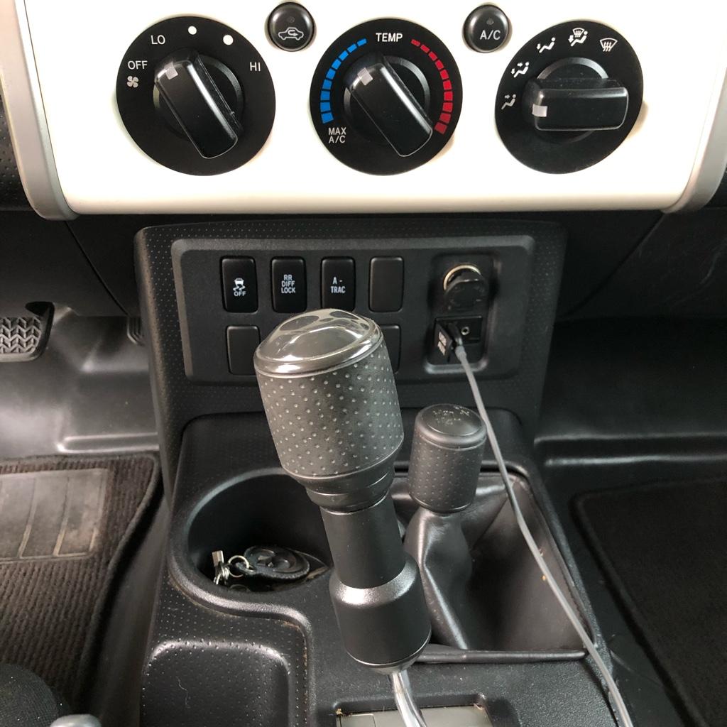

I also installed the TRD pro knob that did not really go well with the 4th gen interior but it still looks a bit out of place here. I'll probably end up giving it to one of my friends that owns a 5th gen. It really only looks right in that interior.

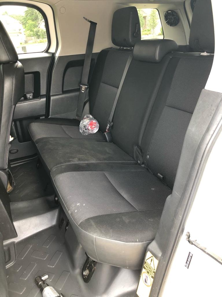

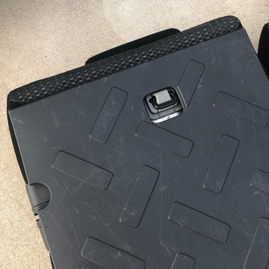

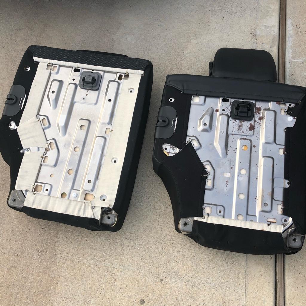

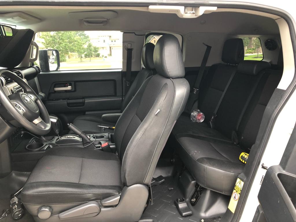

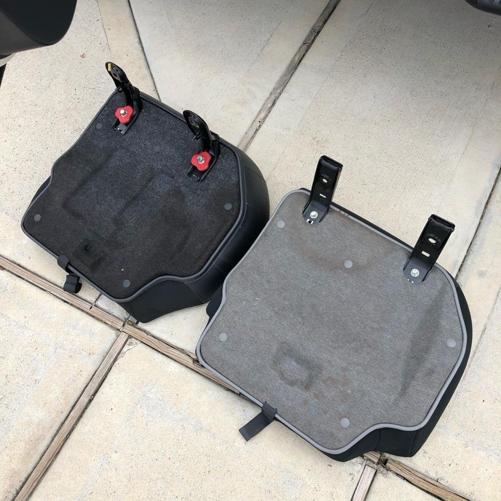

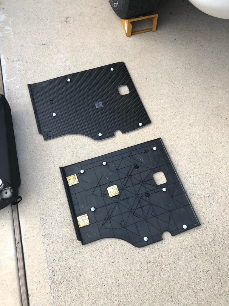

Also pulled the back seat pieces to see if I could swap the rear seat since the 4Runner has a center armrest with cup holders, while the FJ doesn't have the armrest and just cup holders on the rear "doors".
Ultimately, found out what others probably knew that they changes the bottoms ever so slightly so they won't sit flat when you install them. My friend did suggest to just swap the seat covers over, which I would have done but the back panels also do not line up.
Seat backs will bolt in but you would have to use the 4Runner rear panels which are carpeted, while the FJ panels are hard plastic. Swapping the panels wouldn't have worked either since the openings don't line up. Kind of weird that Toyota would recycle the platform but change up minor parts like that. So much for swapping over my seats. I also passed on the front seats even though I find them more comfortable. Mainly because the FJ seats have airbags while the 4th gen seats do not. I didn't want to mess with the SRS system yet. Another wasted 4 hours.

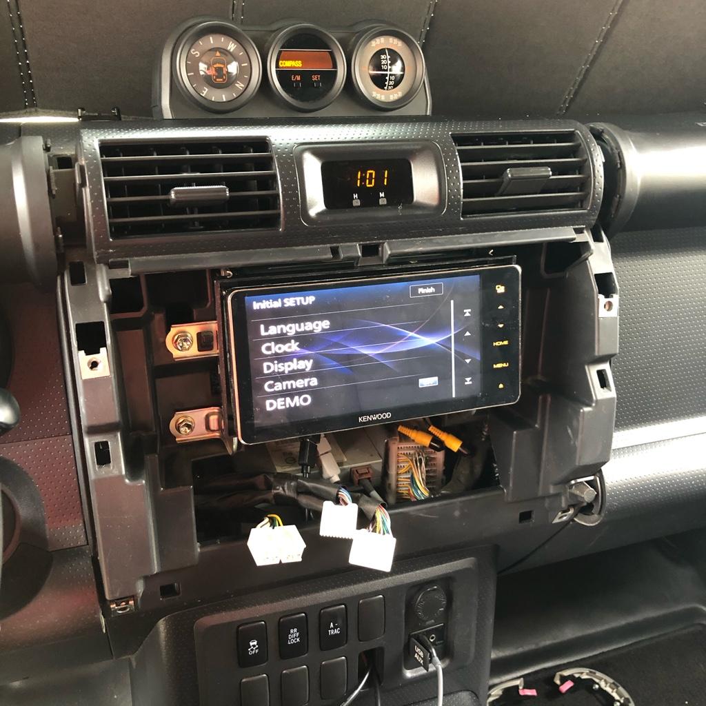

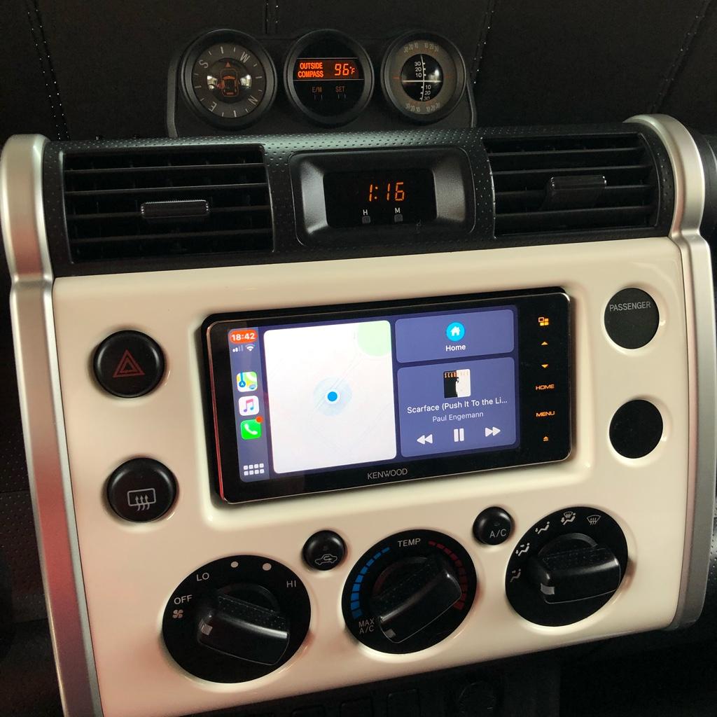

7/3/20 - DDX917ws install

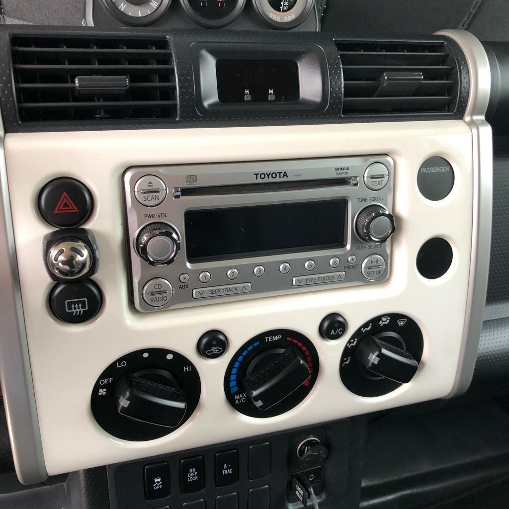

Not much to note here. Any details on the headunit itself can be found on my original install. Pretty much plug and play. I'm still working on the steering wheel harness. I never got it to work with the 4Runner but I got new plugs from fasmoto so I'll try to make them work on the FJ.

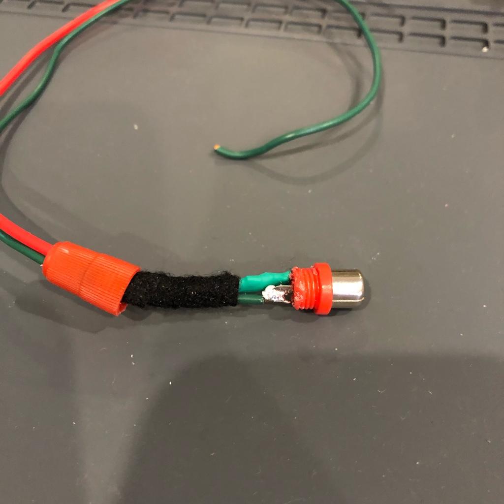

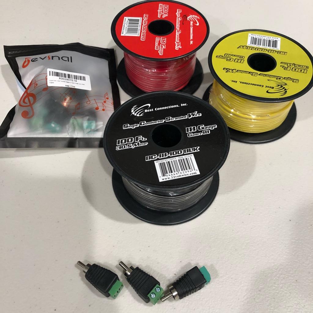

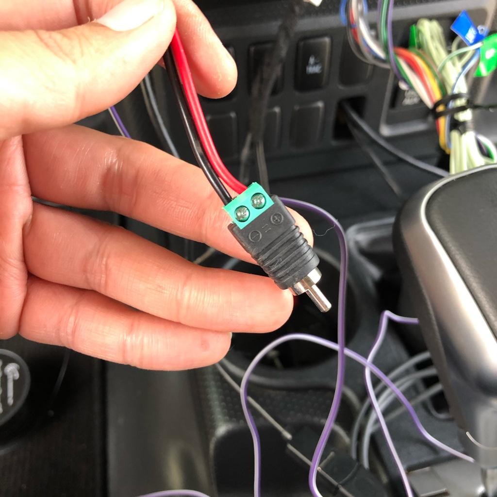

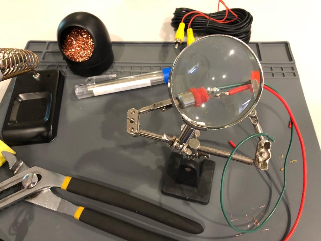

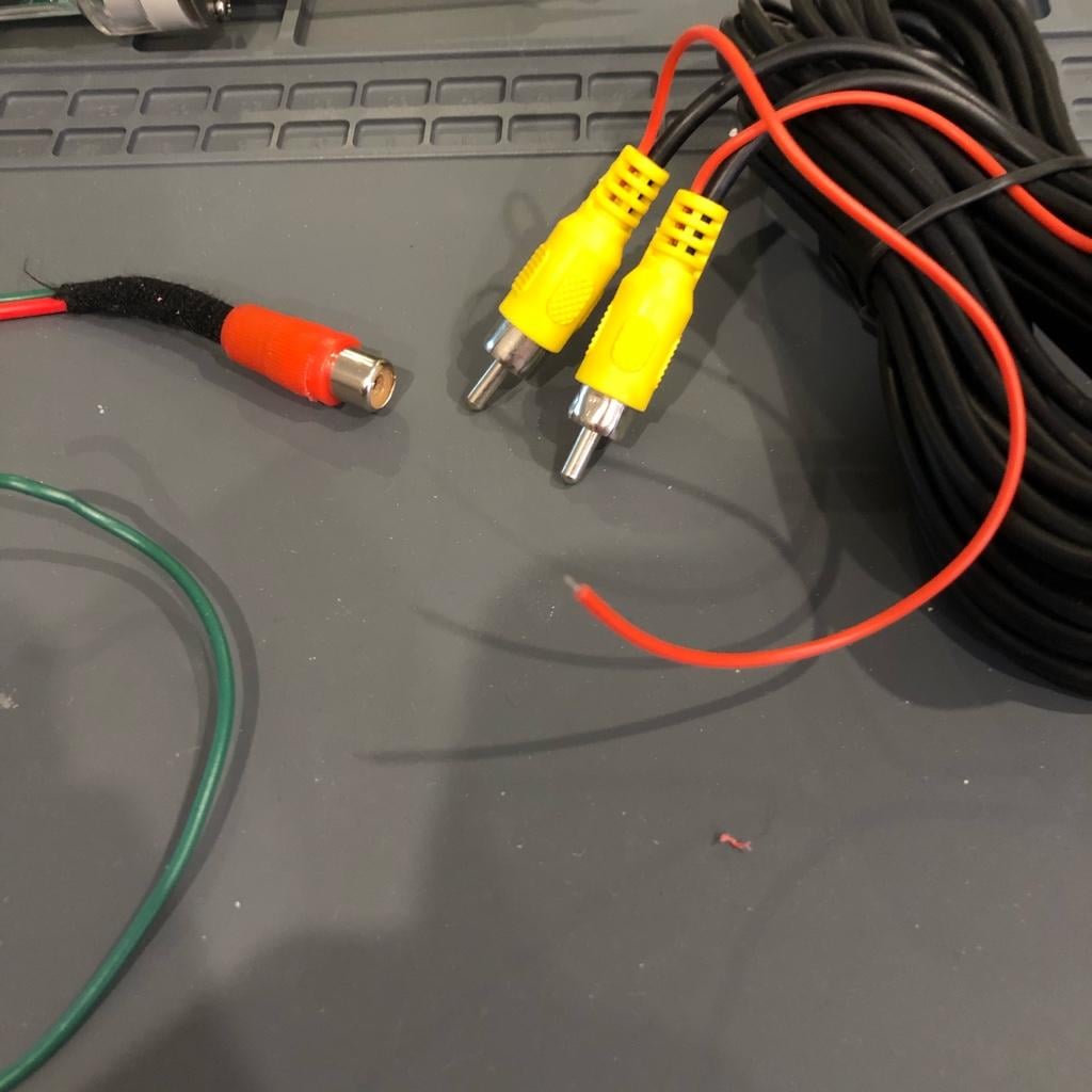

Also got a head start on making the RCA female plug for the reverse camera tap. I found a thread on which wires to splice into to get the factory reverse camera to work on my head unit.
Hoping to get some time to work on this soon. I haven't been able to drive the car much yet because I've been trying to work on the old rig and then getting this one up to speed for inspection. I did get in a covercraft vehicle specific windshield cover because it's the first car I've had where the windshield was so small none of my current covers would work.

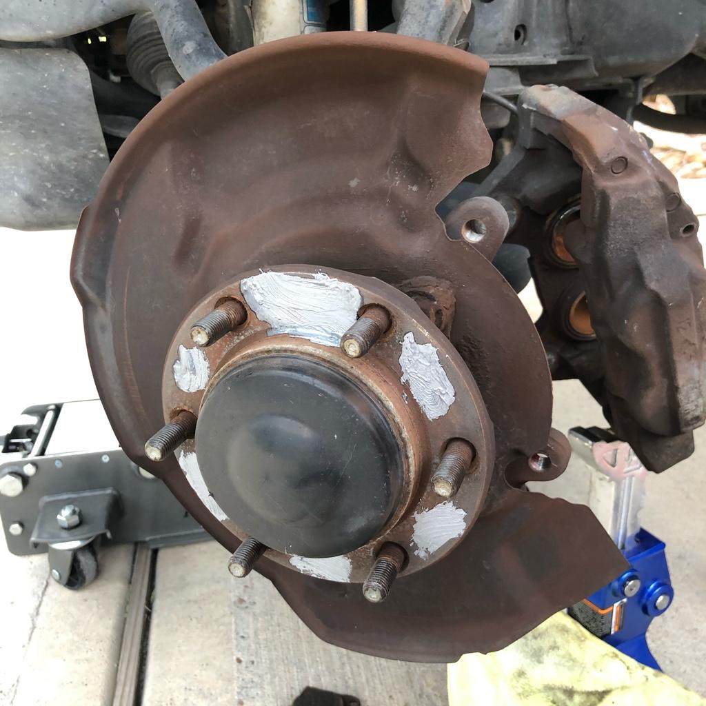

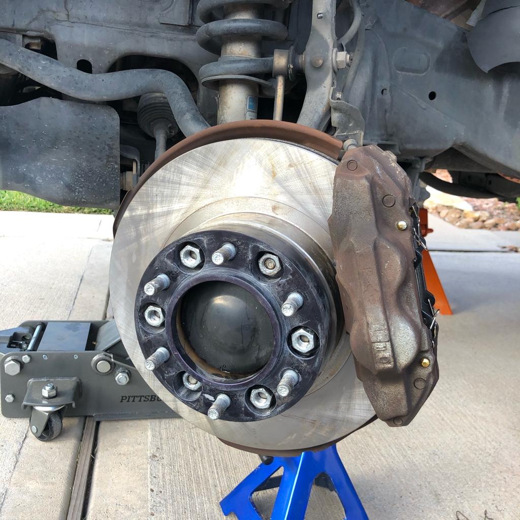

Decided that I would tackle the warped passenger front rotor today. To my surprise this set of wheels and tires showed up on my FB feed.

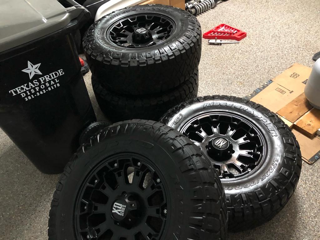

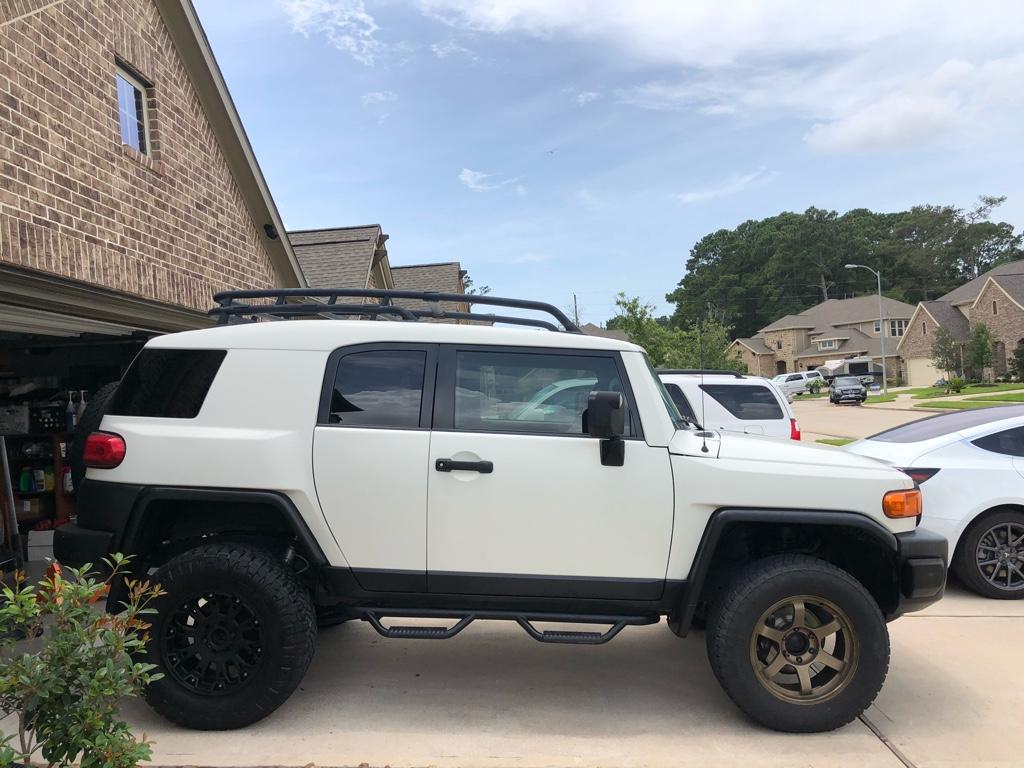

I was able to pick up this combo of wheels and Nitto Ridge Grapplers (295/70/18) for a decent deal. Person claimed they only drove on it 700 miles. The measurement isn't much off of my brand new single tire in my garage so it might be the truth. I bought these knowing that I wasn't going to keep the wheels. Once I get my front lift installed in place of the spacers and get a BMC done I'm going to swap over my Terra Grappler G2s and either my friend can take them or I'll just resell them.
Some people might criticize the way I removed the rotor but I definitely wasn't going to reuse / resurface the old rotors. Second, the brake job will only be temporary while my Stoptech calipers get rebuilt, I just kind of have a lot of my plate to work on side projects right now. I just want to get the rig inspected and registered.
Rust welded rotor removal with a MFH - disclaimer - don't do this to your rotors if you're planning to keep / reuse them
Added anti-seize to prevent the rust from welding the new rotor back onto the hub again.

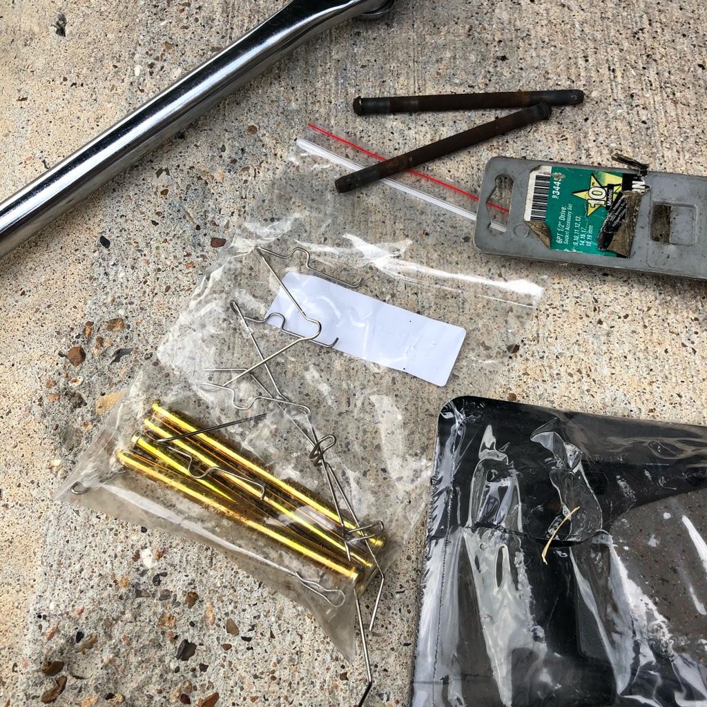

I bought a pad / rotor kit on amazon. It was nice that they included new pins / clips. The clips did not fit so I had to reuse some of the stock ones.

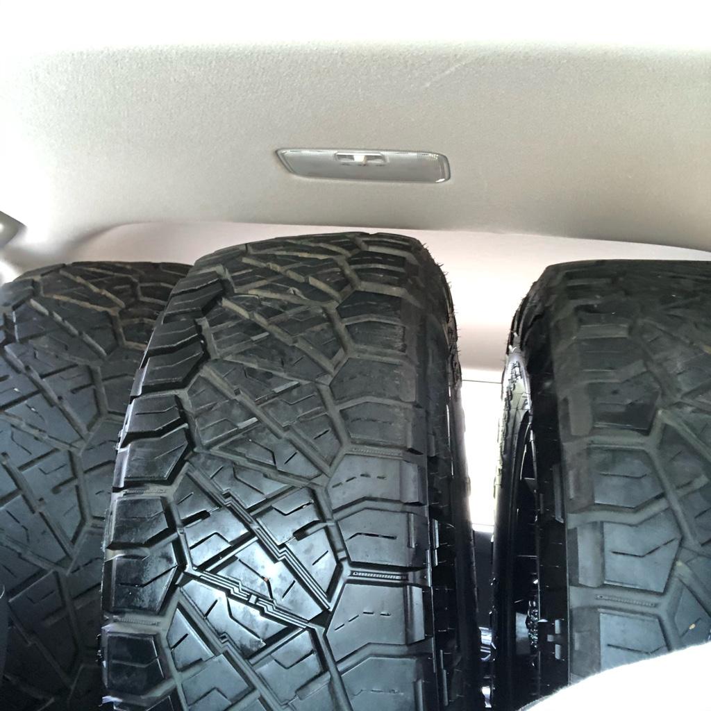

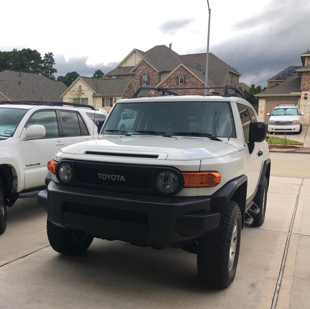

I did foolishly try to run the 34s up front but could not even leave the drive way. So 34s in the back...31s in the front :rofl:

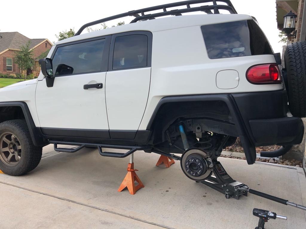

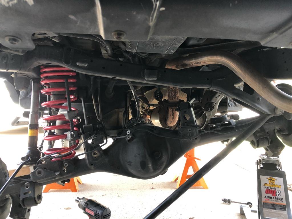

07/07/20 - rear suspension install

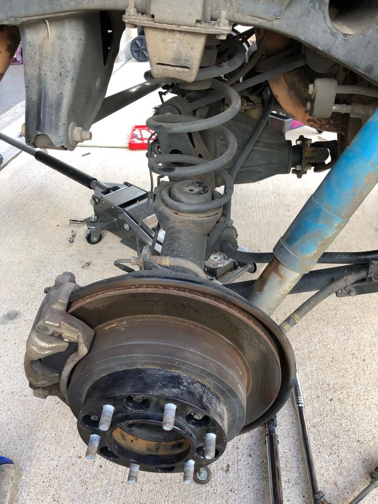

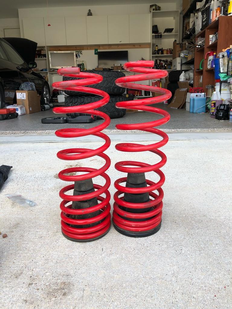

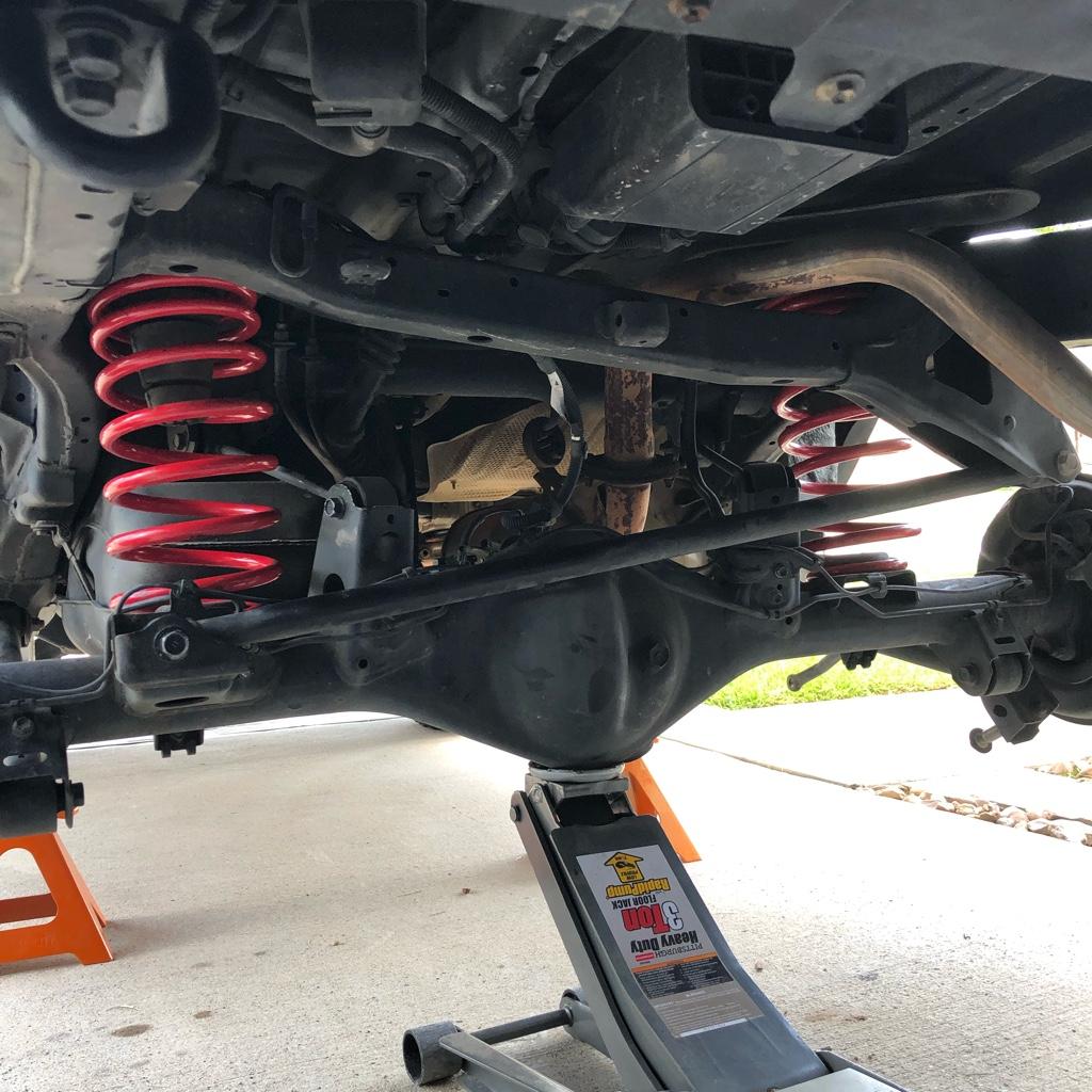

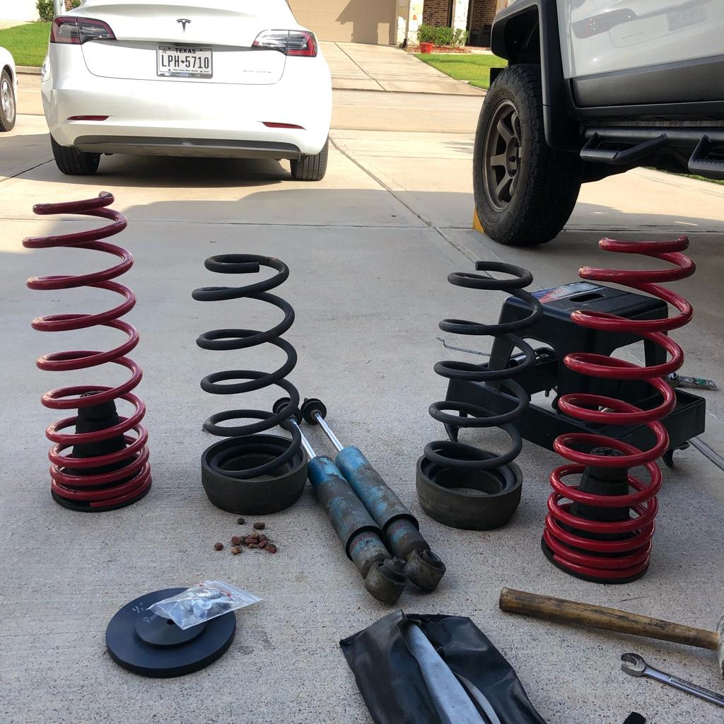

Initially I was going to pay a shop to do the whole suspension. Ended up deciding to do the rear since it wasn't too hard. I went ahead and bought some new tools for the occasion. Made the endlinks and shocks infinitely easier to work with. Also replaced a 1/2" socket wrench that some how got lost in the past 2 years.
I left the jack there in case of emergency but the jack stands are pretty solid.

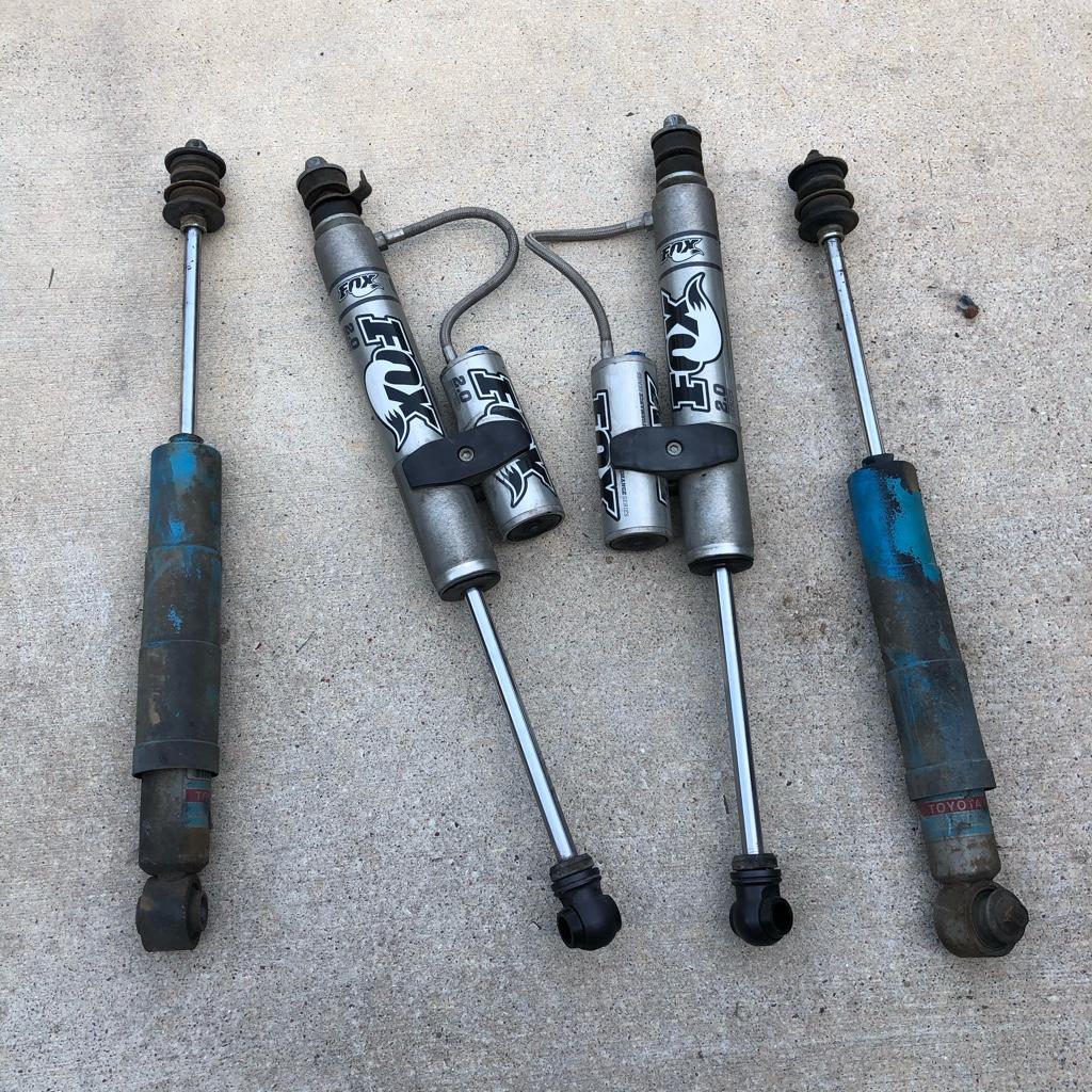

Original OEM shocks with over 150k on them.

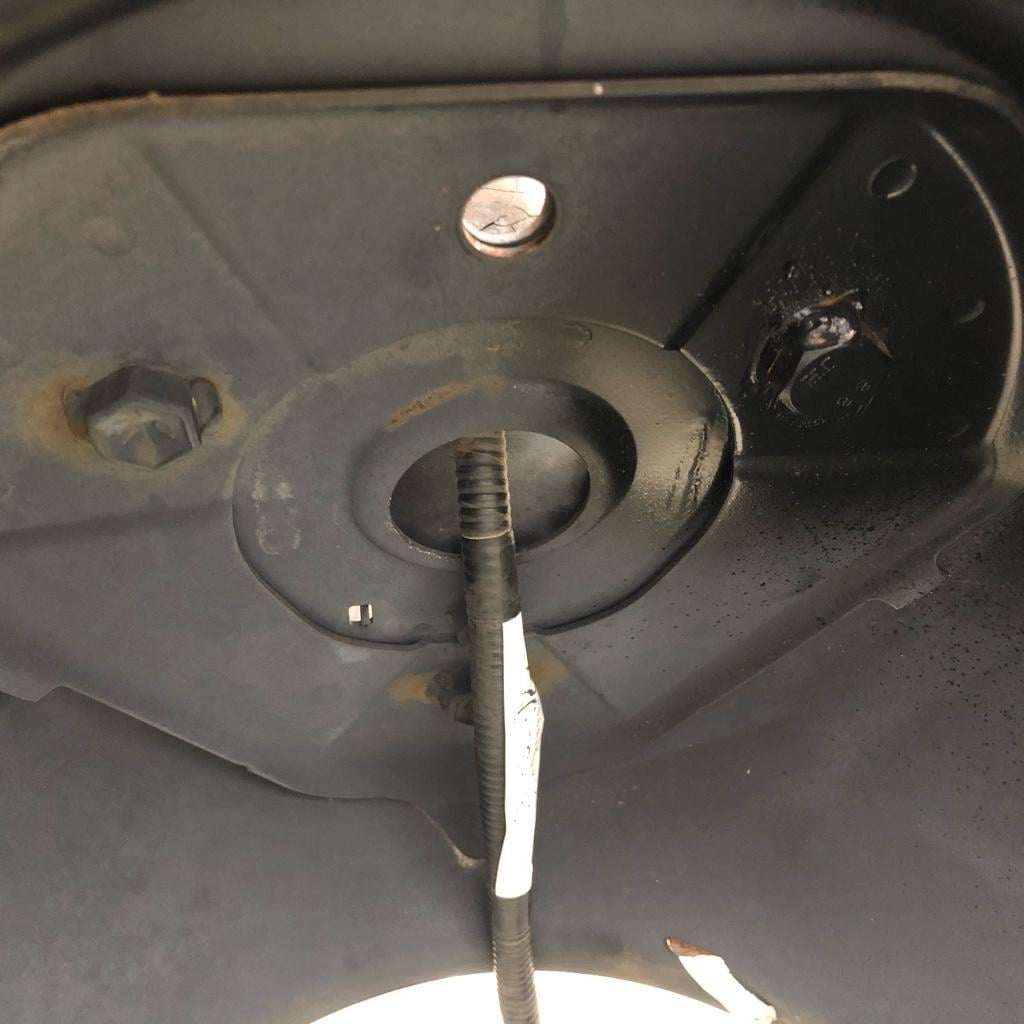

Dobinson 677 springs tower over the stock ones with the spacers on them. I found some dog food inside the bump stop...that was kind of weird.

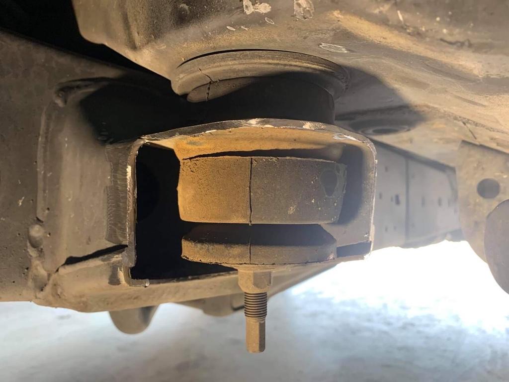

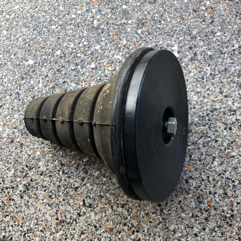

I installed this 1/2" cornfed spacer onto the bump stop since I had issues with driver lean on the 4Runner. Dobinsons sells a 10mm spacer and Wheelers sells 5mm trim packers to help with this too. I just decided 1/2" was the way to go.
Now it should sit without any lean. Stock springs should be setup where the driver side is slightly taller or firmer to account for the weight of the gas tank. The Dobinson's rep said their springs do not have a driver / passenger side.
I don't really like the use of spring compressors but it was the only way to get the spring onto the axle with the spacer plus the driver side being harder to install on. This was my issue anyway. I would recommend getting a portable hydraulic equipment kit from Harbor Freight for doing this instead of using the jack like I did. I did have the jack slip once from the passenger side but it didn't fly off like I thought it would.
Passenger side went in with less issues partly because there was no gas tank in the way. I was at the 2 and half hour mark by now. Pretty hot down here and took several water breaks and a couple of sitting / staring off into the distance breaks.

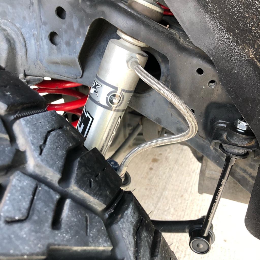

Fox 2.0 DSC resi shocks

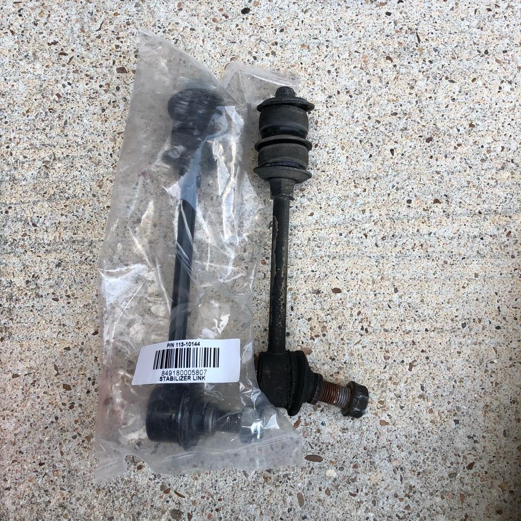

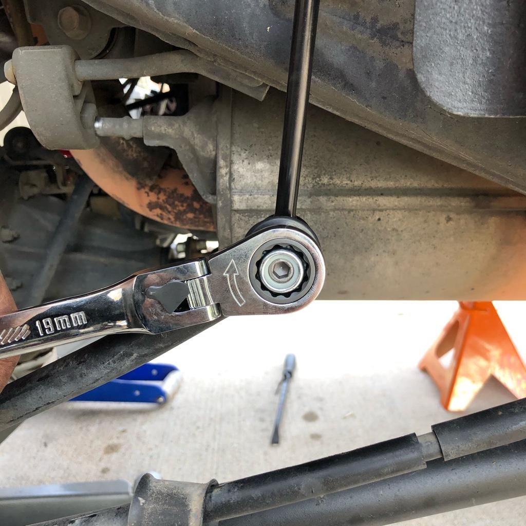

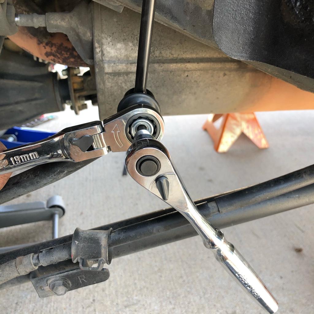

I have to thank [MENTION=63060]rickashay[/MENTION] for mentioning the use of 2nd gen 4Runner endlinks on his 4th gen build. I bought these Proforged 2nd gen endlinks from rockauto from before I installed the suspension on my 4th gen but never had the chance to. Partly because of all the rust and out of sheer laziness.
I really like that they have an allen key to lock the endlink while you tighten it onto the sway bar.
I forgot an after picture but I did have the endlink backwards earlier.

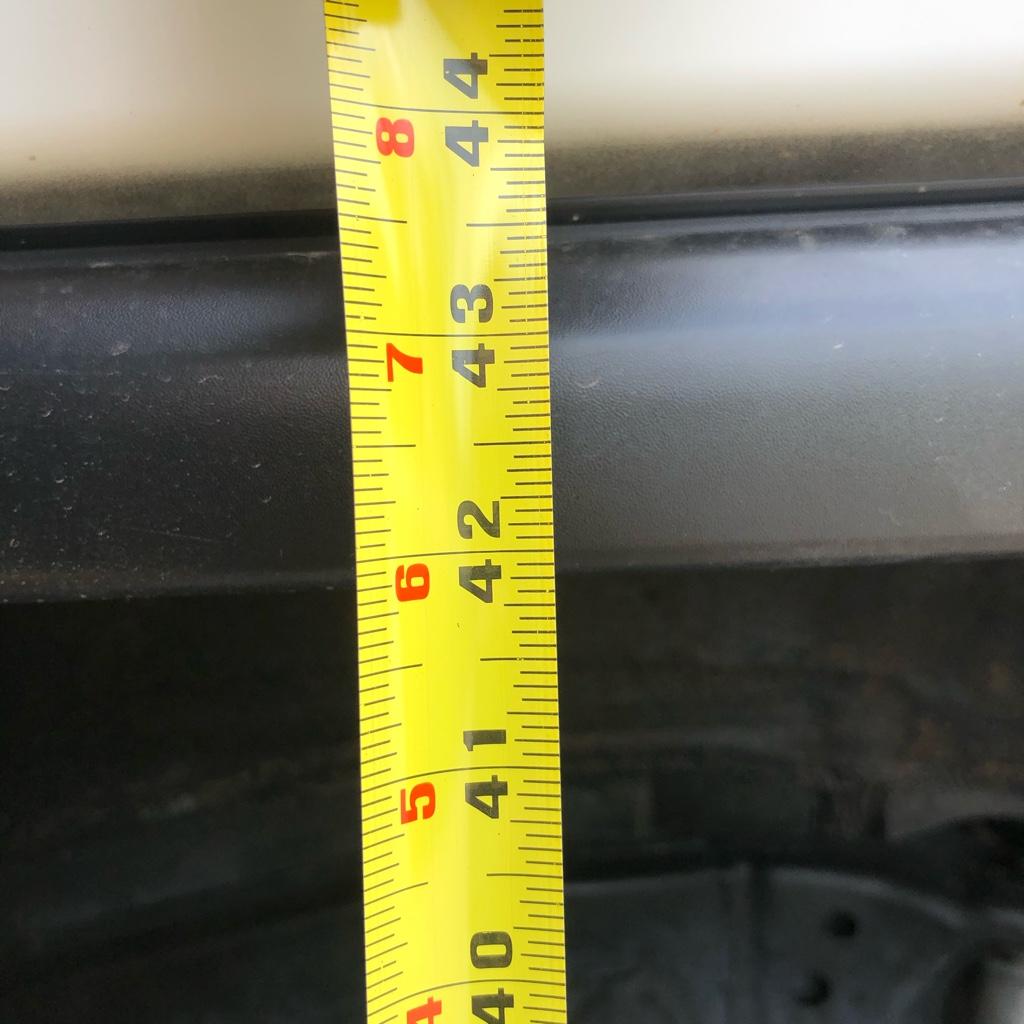

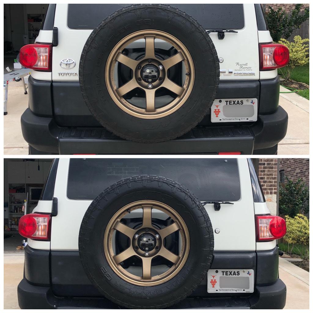

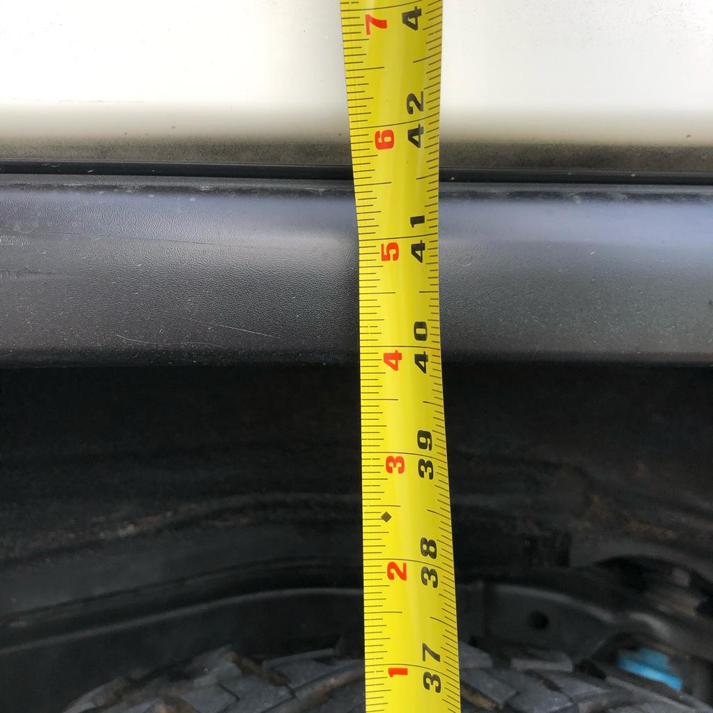

Driver side rear before measurement to ground.
Passenger side rear before measurement to the ground.

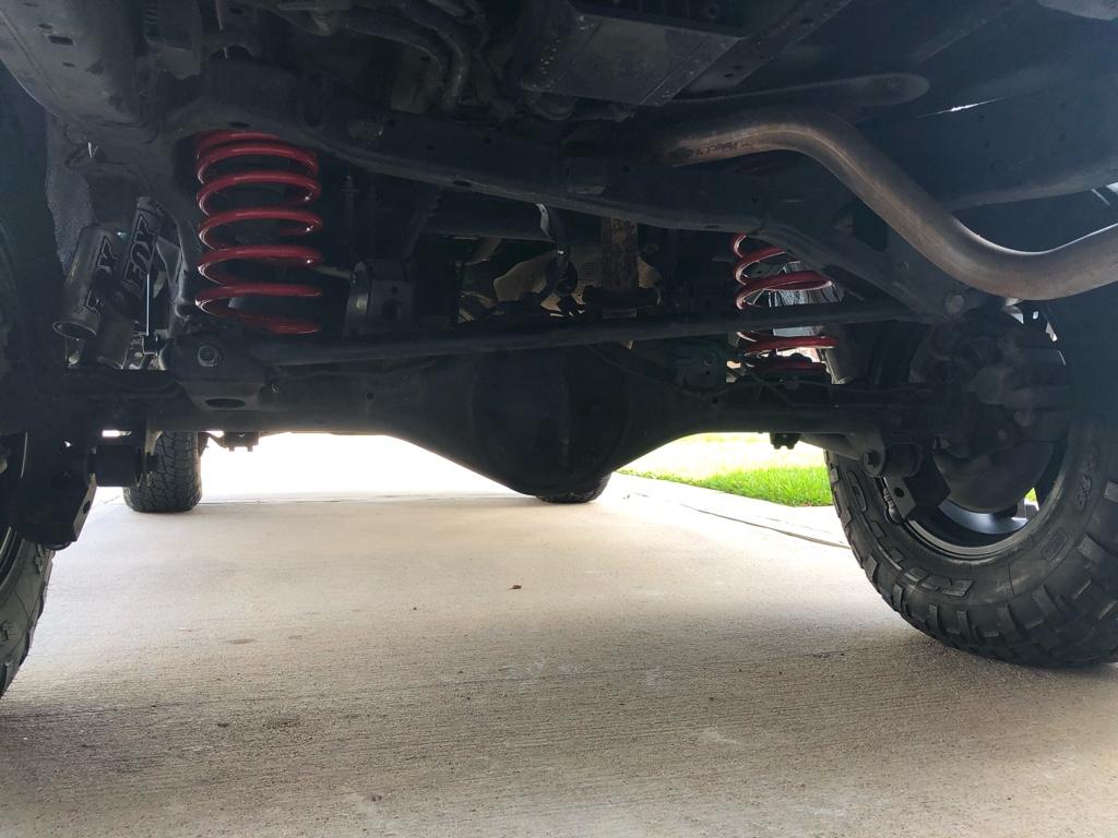

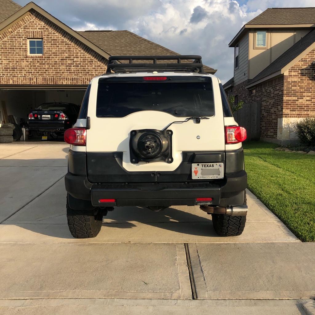

Measurement after install of springs / 34s to the rear. Both sides are within mm of each other so I only had to post one measurement.
So if it were questionable whether I would fit in the garage or not when I first got my rig, it definitely won't fit now. Even if I were to delete the roof rack, the skin would still scrap the garage going in and that's with my door maxed out. The install did not go without any hiccups though. I ended up cross threading the panhard axle bolt. No worries because I'll have to install the eimkeith PCK next week so I'll have my rig towed out to the shop. It'll be the same shop that'll install my front setup anyway. Ordered some new hardware that should be here by then. I'm just glad to start making headway on the rig and reaping some rewards. Have a trip planned next month to Austin already too.

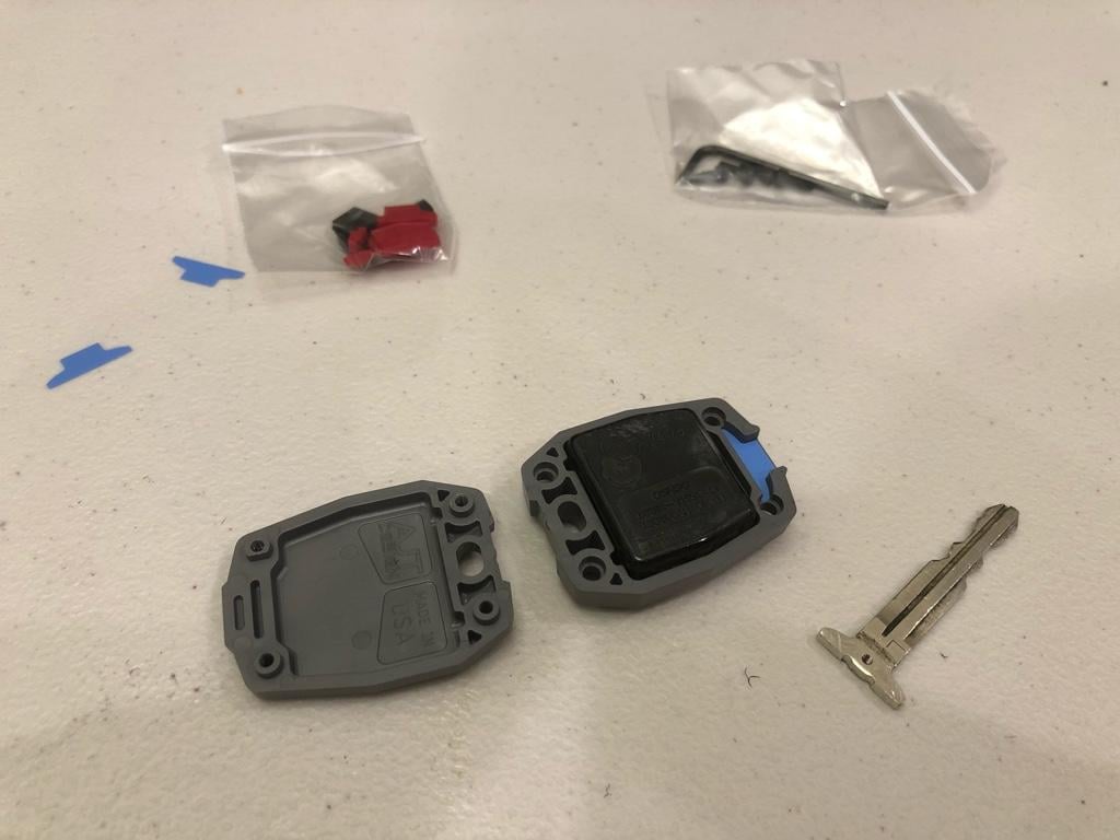

07/09/20 - AJT keyfob case / turn signal switch compare

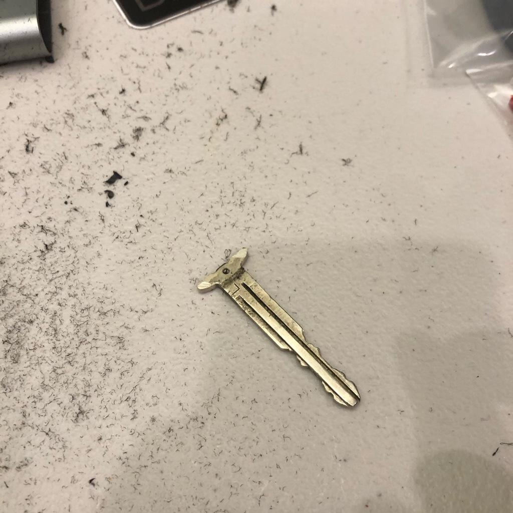

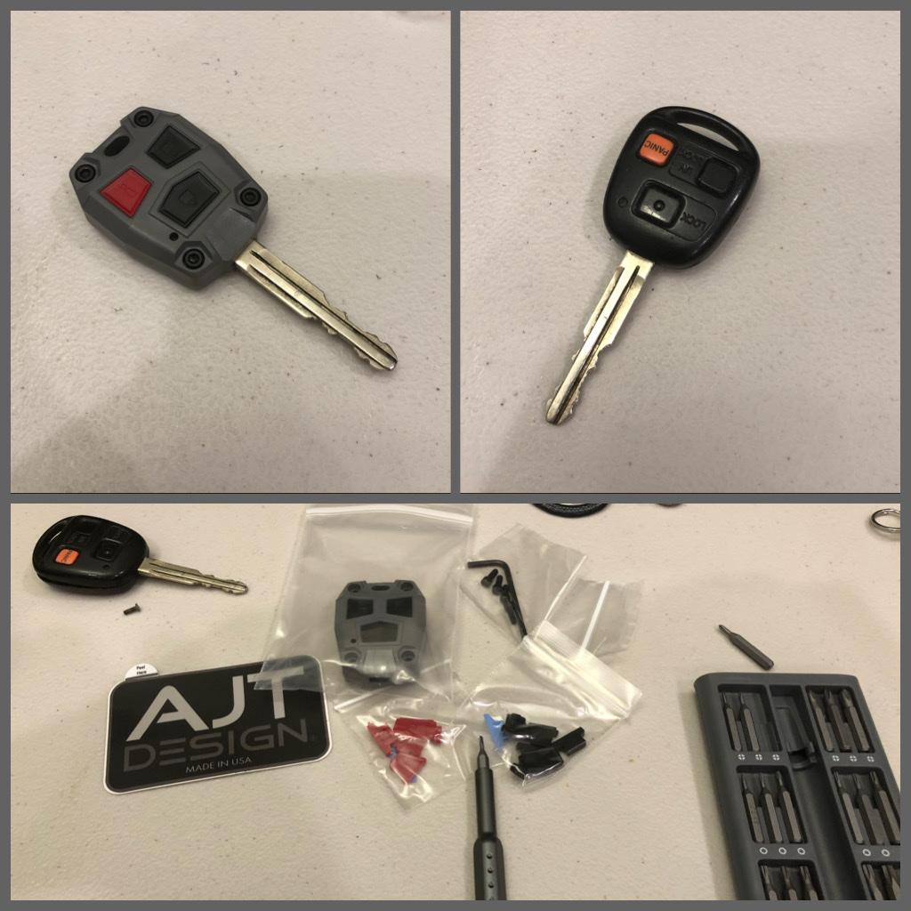

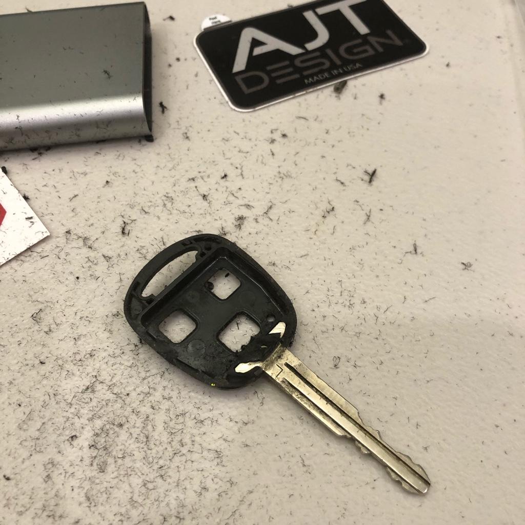

One of the parts I ordered before I even got the car here. An AJT keyfob case in cement grey. I would have done black but I wanted it a bit different, the only problem is that it blends in with my counter top.
Pretty straight forward process as explained by the video. I couldn't really use a knife to cut off the plastic so I resorted to a dremel tool. My key ended up needing two shims to properly seat without any wiggling. I bought two sets of buttons just so I could have the red panic button. Only thing I missed out on was the TRD etching in the back and that was probably an issue with Toyota. They used to have TRD engraved in the back but not anymore. The case also fits my IS300 keyfob but I thought it would look out of place on that so I will not be getting another case. I need a second keyfob so I'll probably buy the same 2-in-1 flip key I had for my 4th gen.

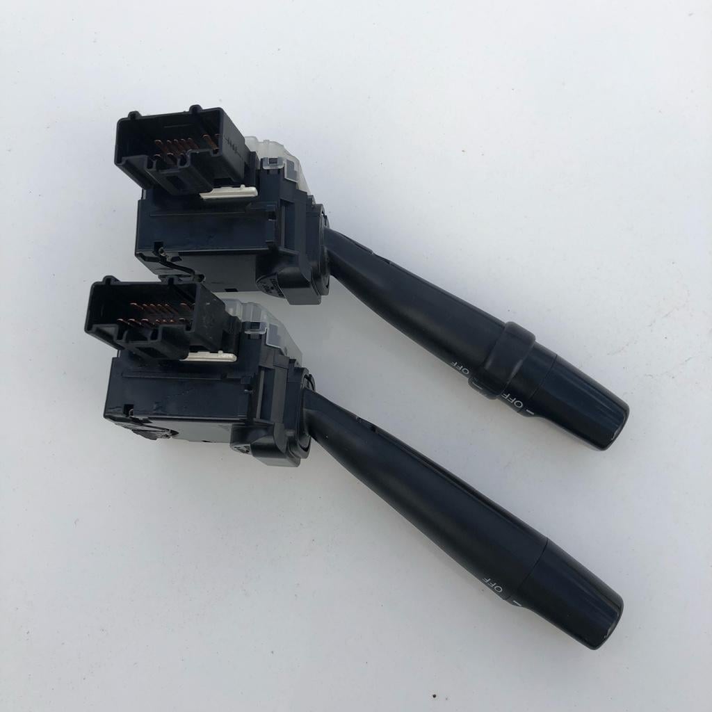

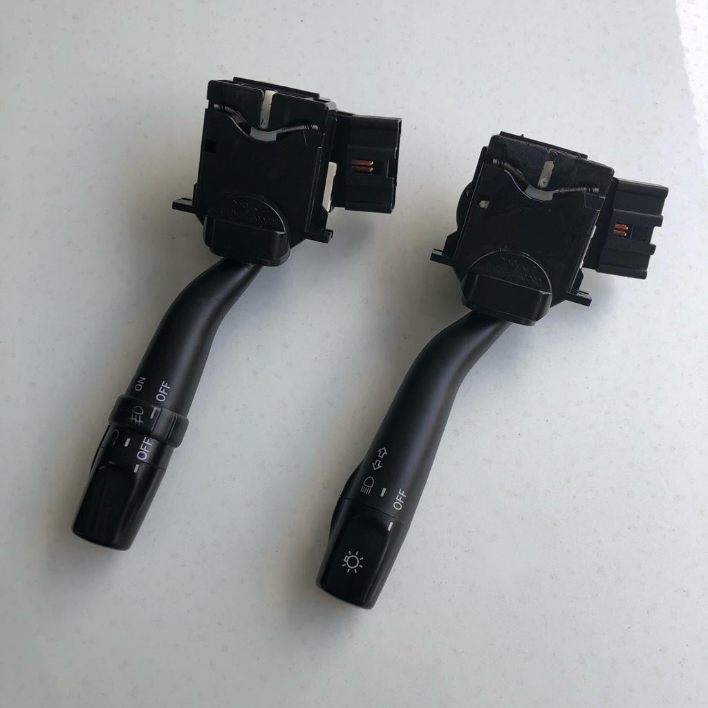

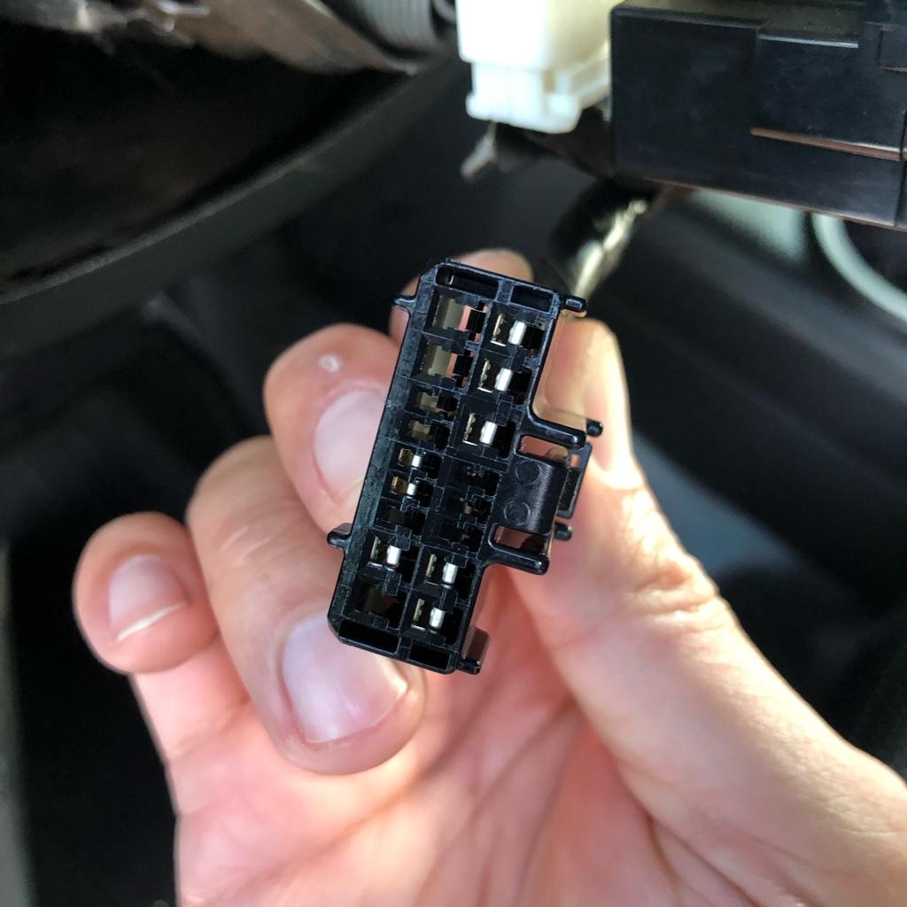

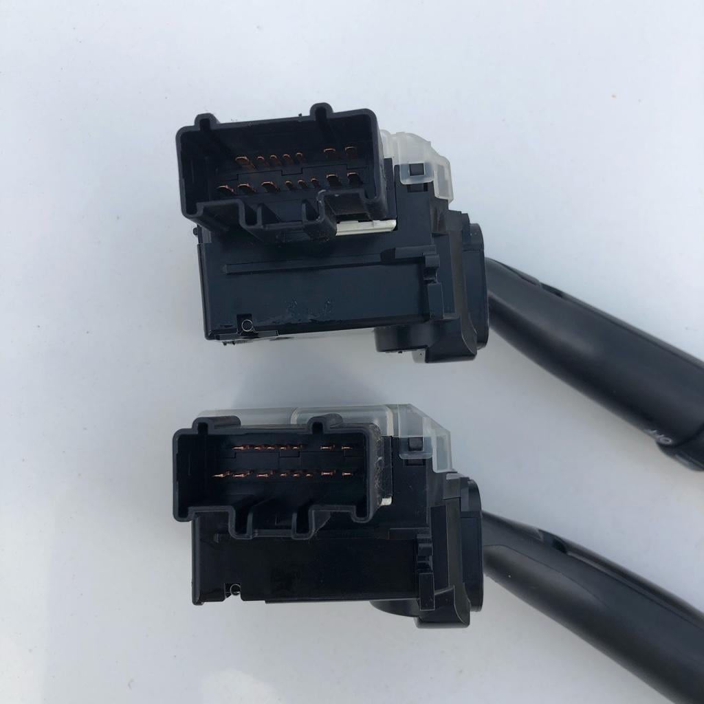

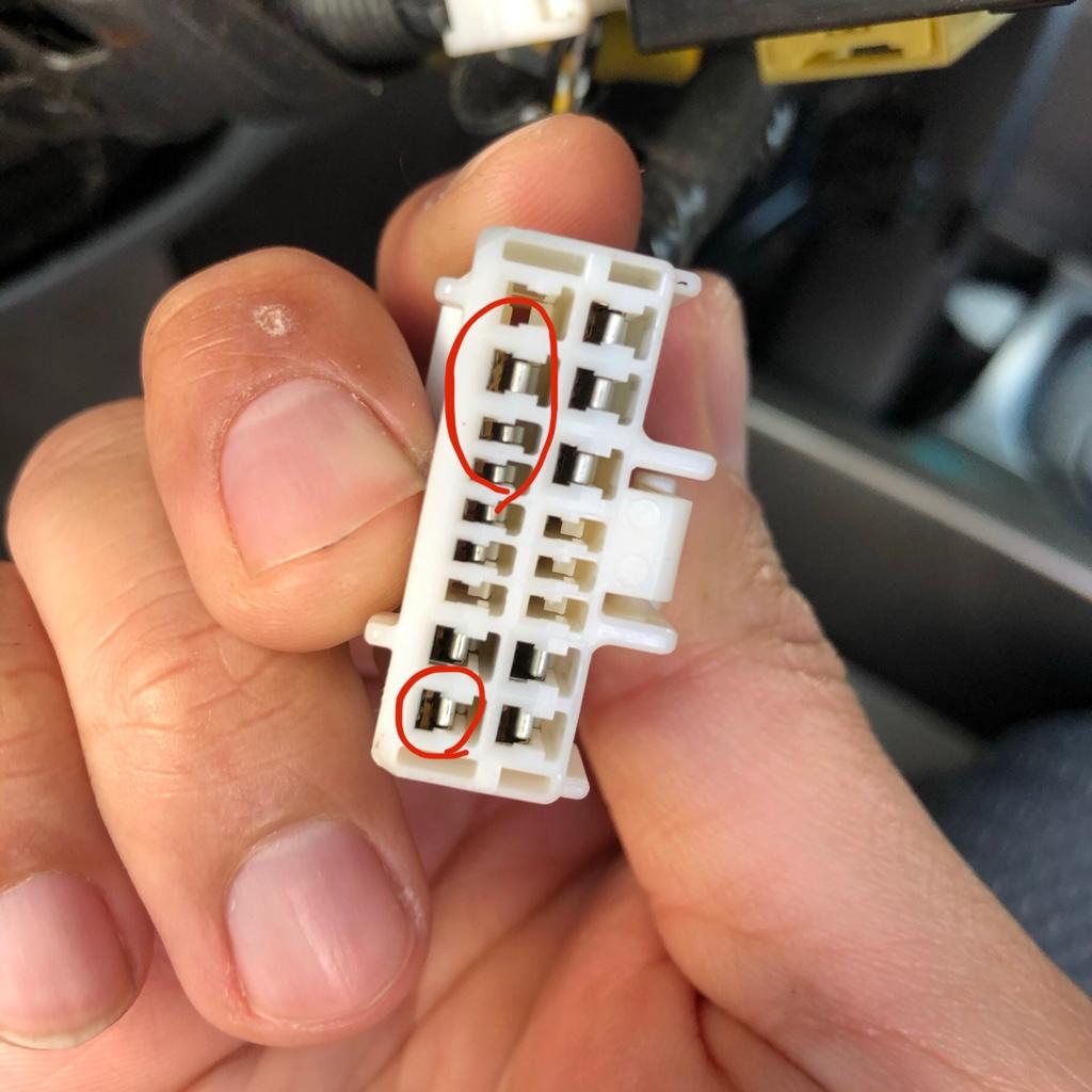

My next project at some point will be to wire up auxiliary / fog lamps and use a turn signal stalk that has the built in fog lamp switch like both my 4runners did. The FJ is the black harness, which is missing pins 10/11/12 and 17.
I circled the ones present on the 4Runner harness. I was able to figure from the constant on fog light mod page that pin 17 grounds 11 which ends up bridging to 10. In theory, this means all I have to do is wire up pins 10 / 11 with an aftermarket wire kit and should be able to use the fog switch on the turn stalk. I know the FJ has the 5 blanks available under the radio but I like the option of operating it from the turn stalk. I'm not sure if this is really known in the FJ world but thats the benefit from owning multiple types of cars. Can combine different worlds and make them all work together.
As you can see, they're pretty much identical. I found other hits online that point to similar ones that can be used from other Toyota cars too. I won't list them since I can't guarantee what will work. Just what I've encountered in my build so far. 5th gen parts from the steering column won't work here because of the different harness connection.

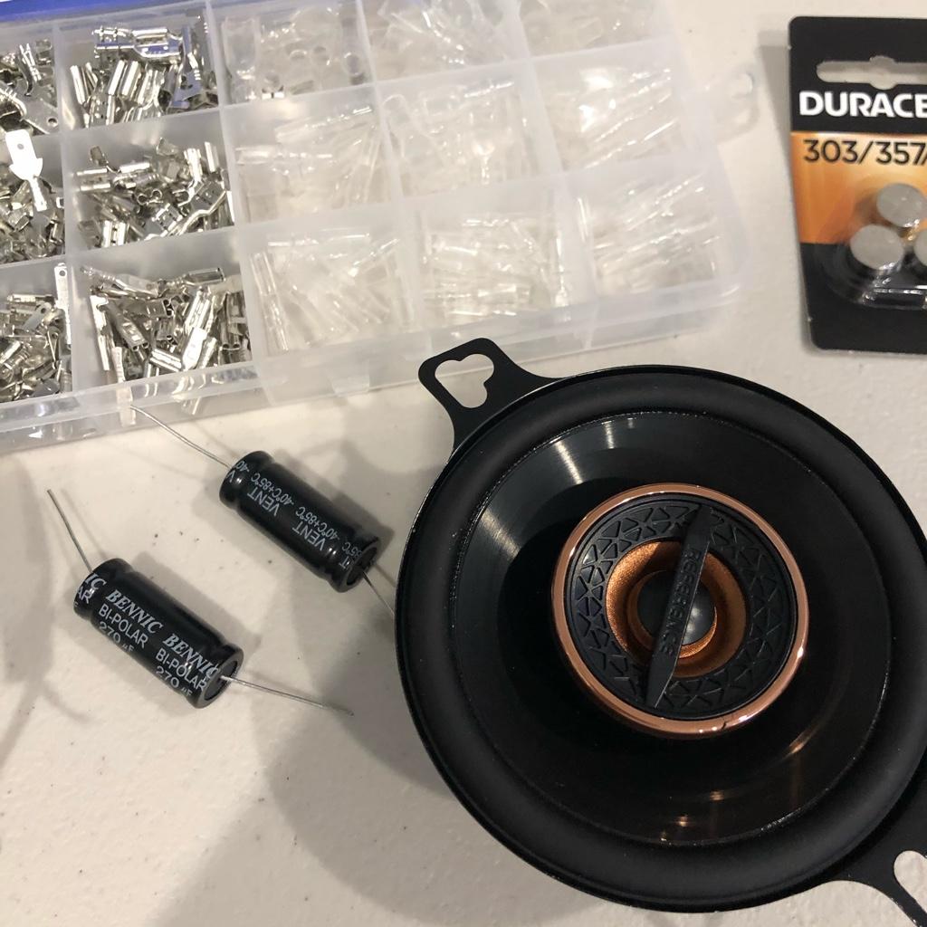

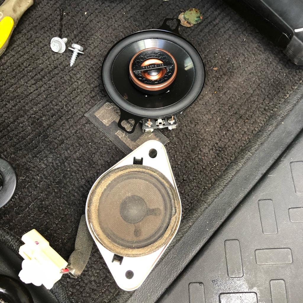

07/16/20 - Factory Tweeter Swap

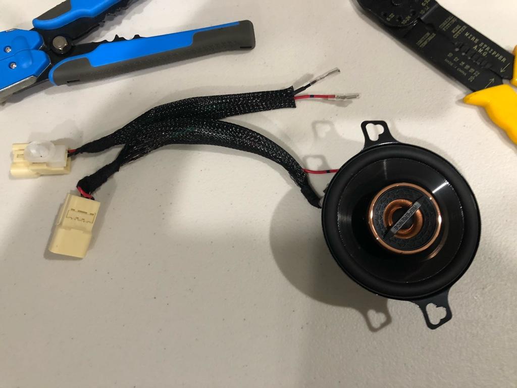

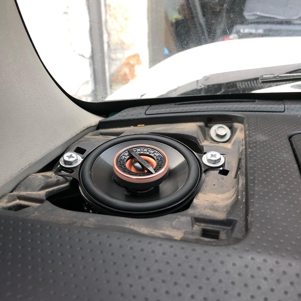

I originally bought these to install in place of the tweeter in the 4th gen doors but they also work in the factory location on the FJ. I know that a 3.5" speaker isn't the ideal sound staging for the dash panel, but without having to go into running new wires for a component setup, this was the best solution for now.

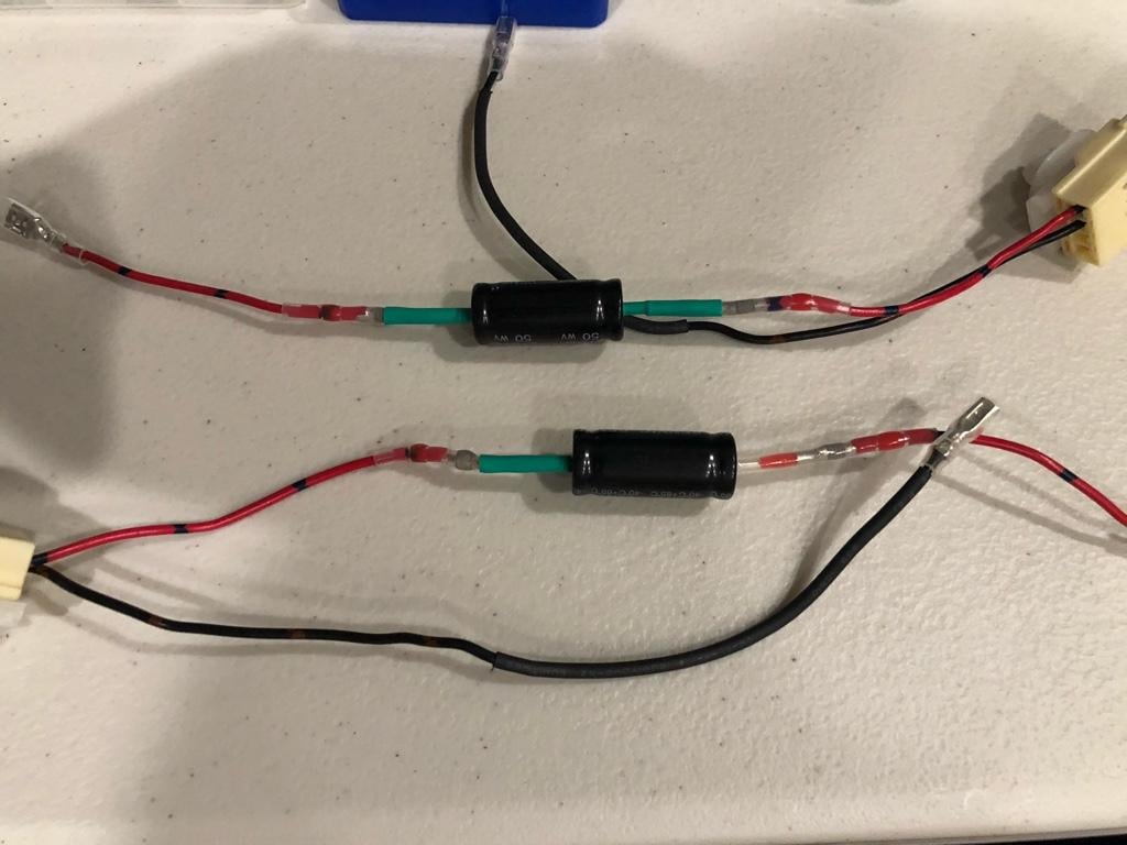

Went ahead and soldered up the bass blocker / "crossovers" that came with the speakers. Had some spare loom laying around to make it look sort of factory like.
I just have to drill out the factory tweeter cups to put the panels back on but they sound pretty good. I think the bass blockers may have deleted the bass to the 6x9s in the door panel though. Slightly more crisp highs than before and a bit more vocals coming through now.

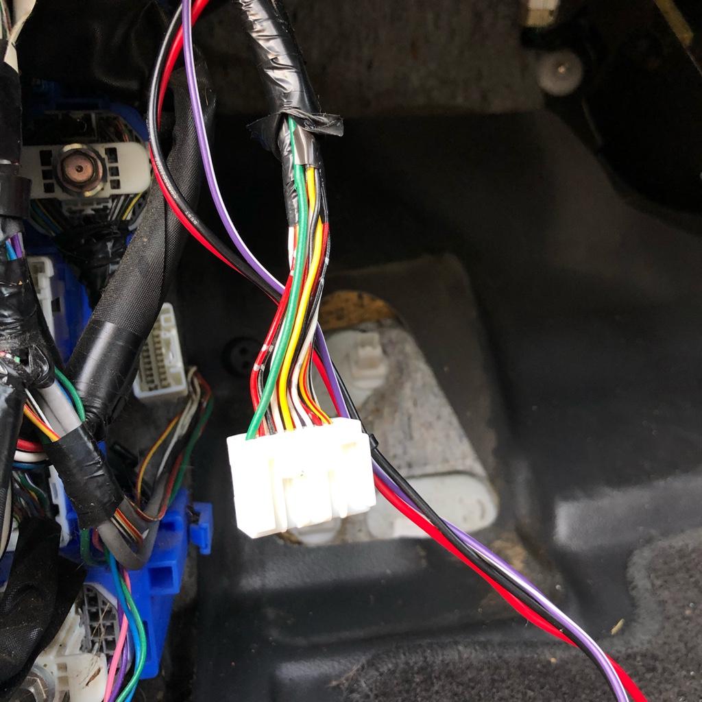

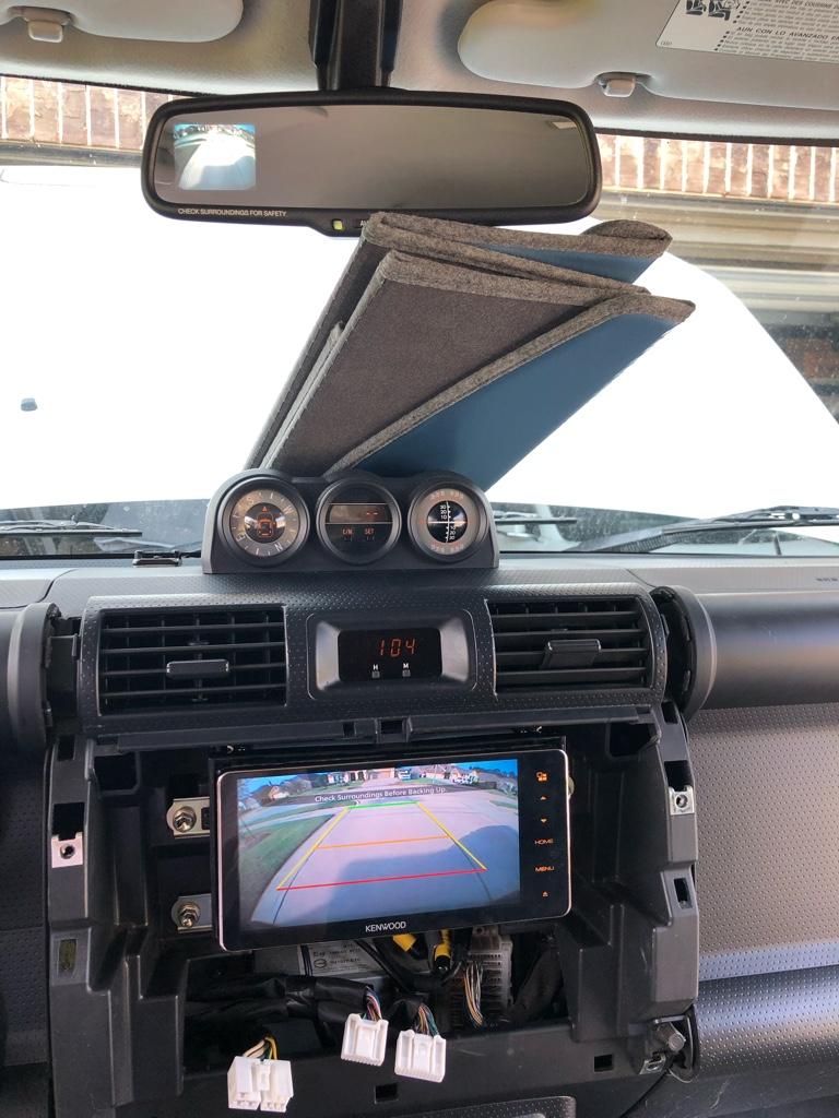

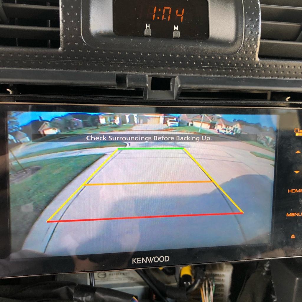

The next part I wanted to get out of the way was tapping the factory reverse camera signal to use on my factory head unit. Like late model gen 2 Tacomas, Toyota opted for reverse camera view in the rear view mirror. I followed this shops instructions on tapping the signal.
Using stock backup camera w/ aftermarket Nav system
Ideally I would have spliced and soldered the connections but I went for the traditional wiretaps. I'm sure they will have to be redone but it was too hot to spend time in the car with a soldering iron / heat gun.
I was able to get both signals to work. Apparently it doesn't work for everyone. It is advisable though, to disconnect the battery so maybe the rear mirror got shorted for some folks. I might switch out the rear view mirror down the road anyway for a rimless one like my 4Runner had.

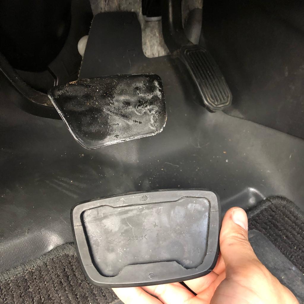

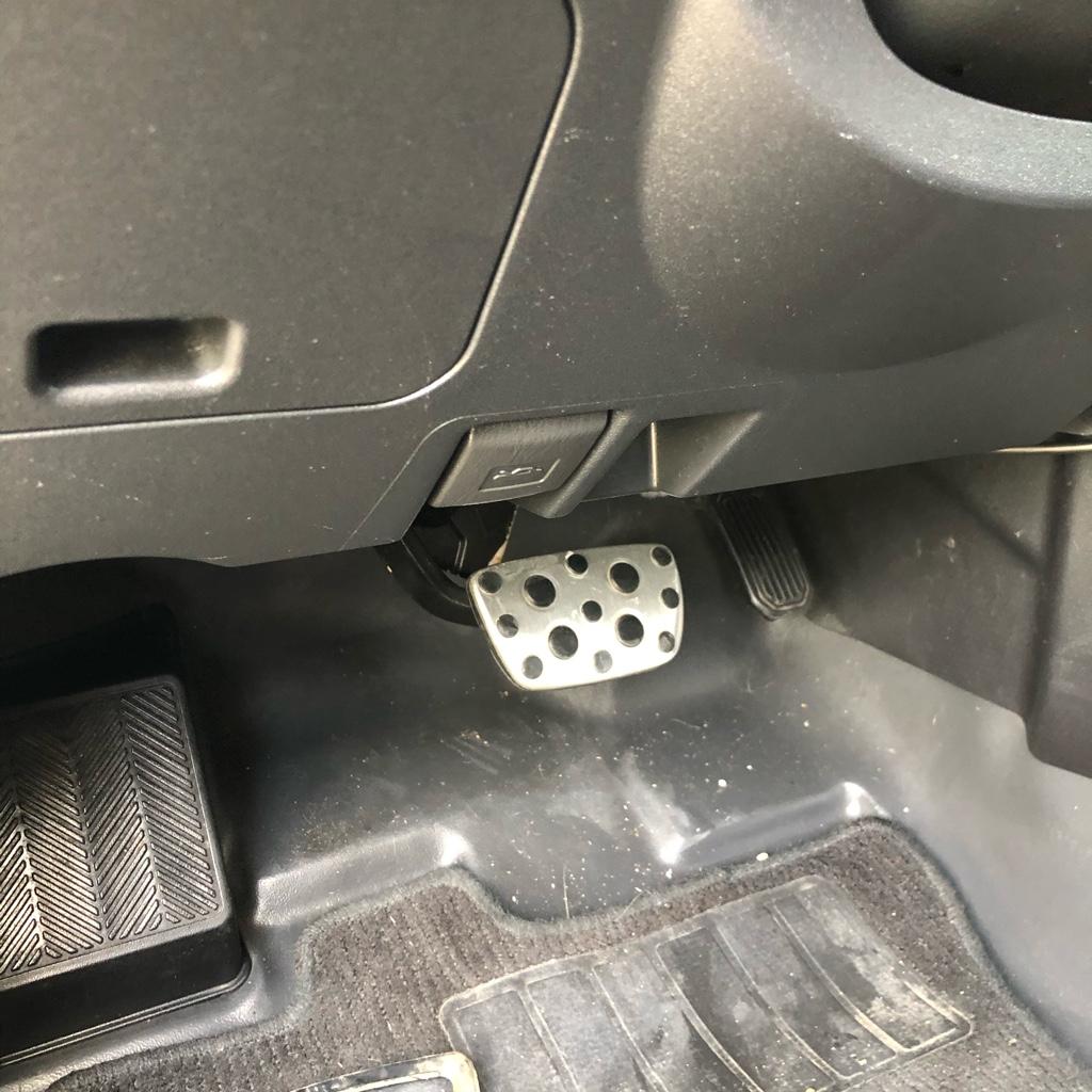

Also installed the "sport" pedal. It is just the stock pedal off of an IS300. Hard as heck to get on though.
I'll probably replace it with a newer pedal cover down the road. I also figured out a potential update for the gas pedal and dead pedal but I need to fact check a few things before I post anything on it.

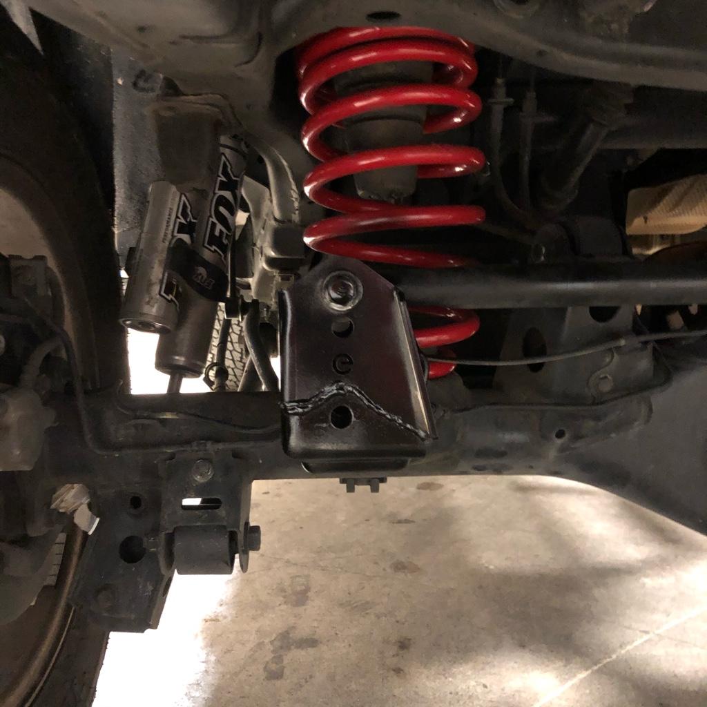

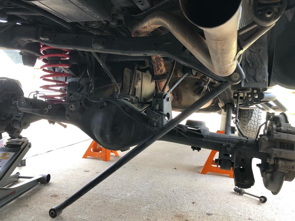

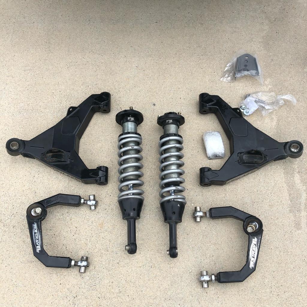

I decided to have a friend of mine do the install for the front since it needed some welding and he could get the alignment done all in one go. The [MENTION=28464]eimkeith[/MENTION] PCK, body mount chop, and rear reservoir install were originally meant for the 4th gen. Those were what I was headed to the shop for when I lost the 4Runner in the first place. In any case, figured I'd save myself the trouble and have him dial it all in for me.
I bought the eimkeith PCK after finding it in this thread: panhard correction kits 4th gen fix panhard bar angle Bought over 2 years ago... I remember telling him about how the bracket should fit 4th gens if he designed it for the 5th gen axle.

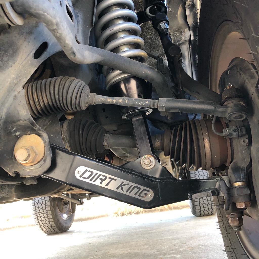

I got these Dirt King LCAs from the classifieds. They came off a 5th gen and I got the sleeves for the 4th gen to end up not even needing them. The other parts came off my 4th gen of course.

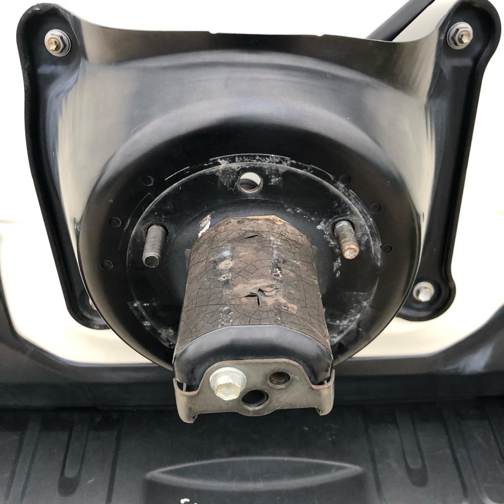

I discovered when I first got the FJ home last month, I was missing one of the studs for my rear tire carrier. Also scary was, I made the 800 mile trip with the other two lugs loose. I didn't think to check them prior to getting on the road. Was lucky that it didn't come off. This will also be fixed. I got a bag of black brake bolts (M12-1.5 x 35mm) off eBay meant for a BMW brake job for this. That was the closest length that matched the stock ones. I didn't want to get a hardware store variant because I didn't want to hunt down a black one (didn't want to constantly have to paint it).

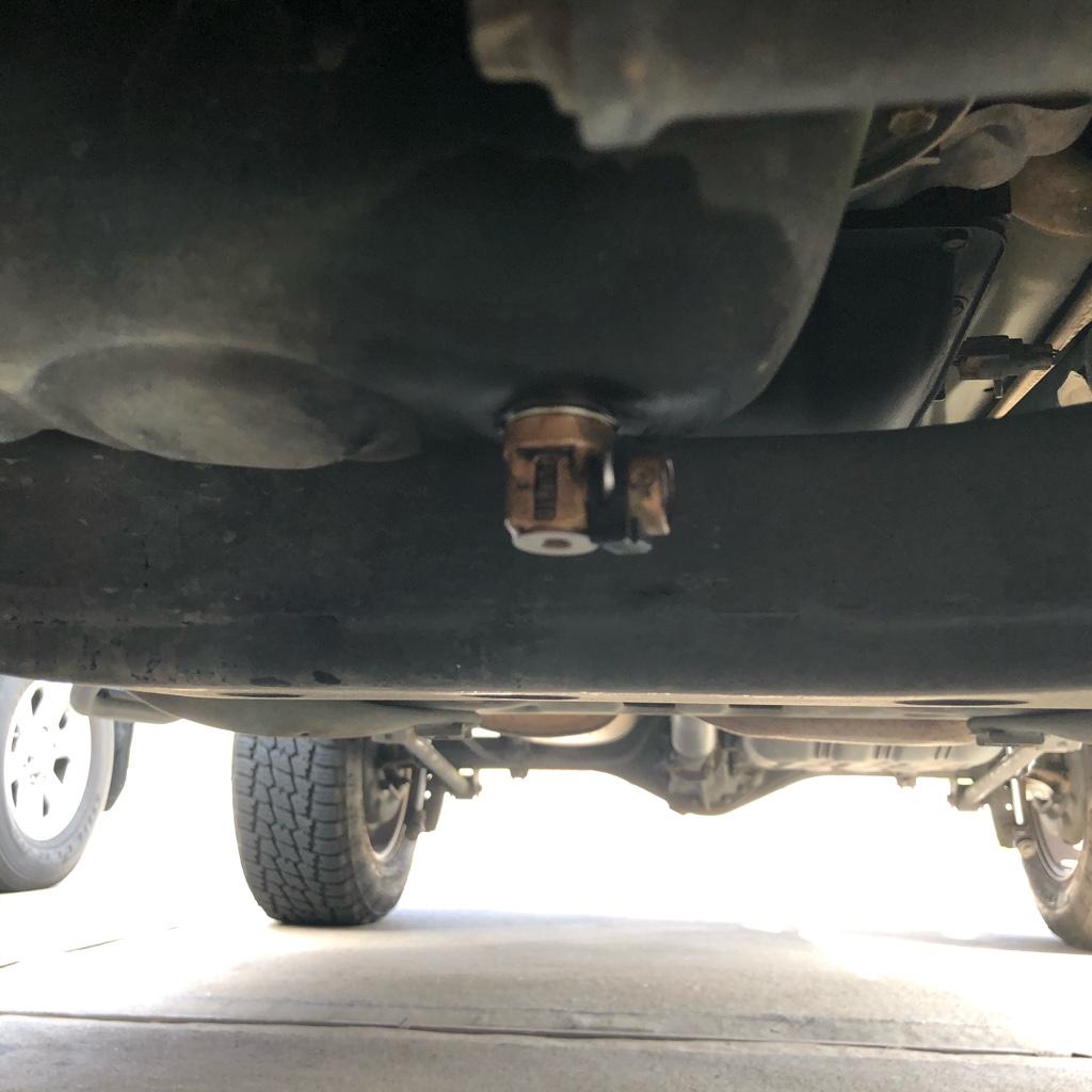

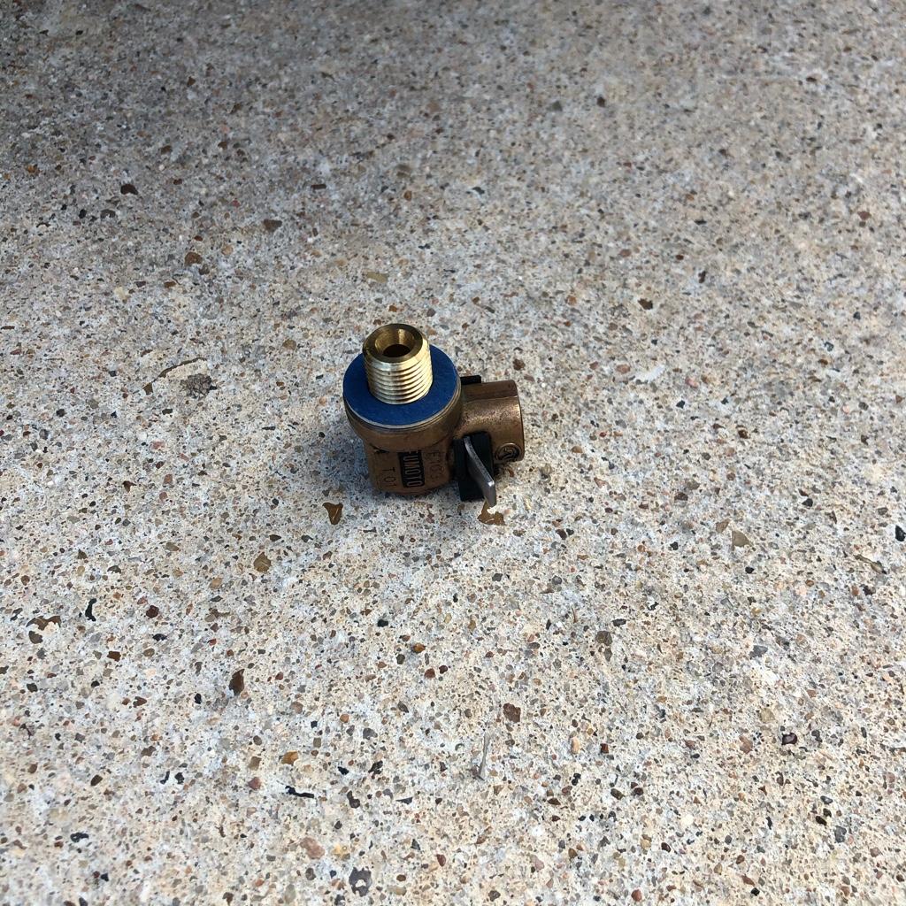

Prior to sending her off to the shop I did the first oil change for her in the driveway. Installed my F-133 Fumoto valve that I took off my 4th gen. Same size as most Toyotas since my IS300 also uses the same one. Won't get too deep into it but its a great product.

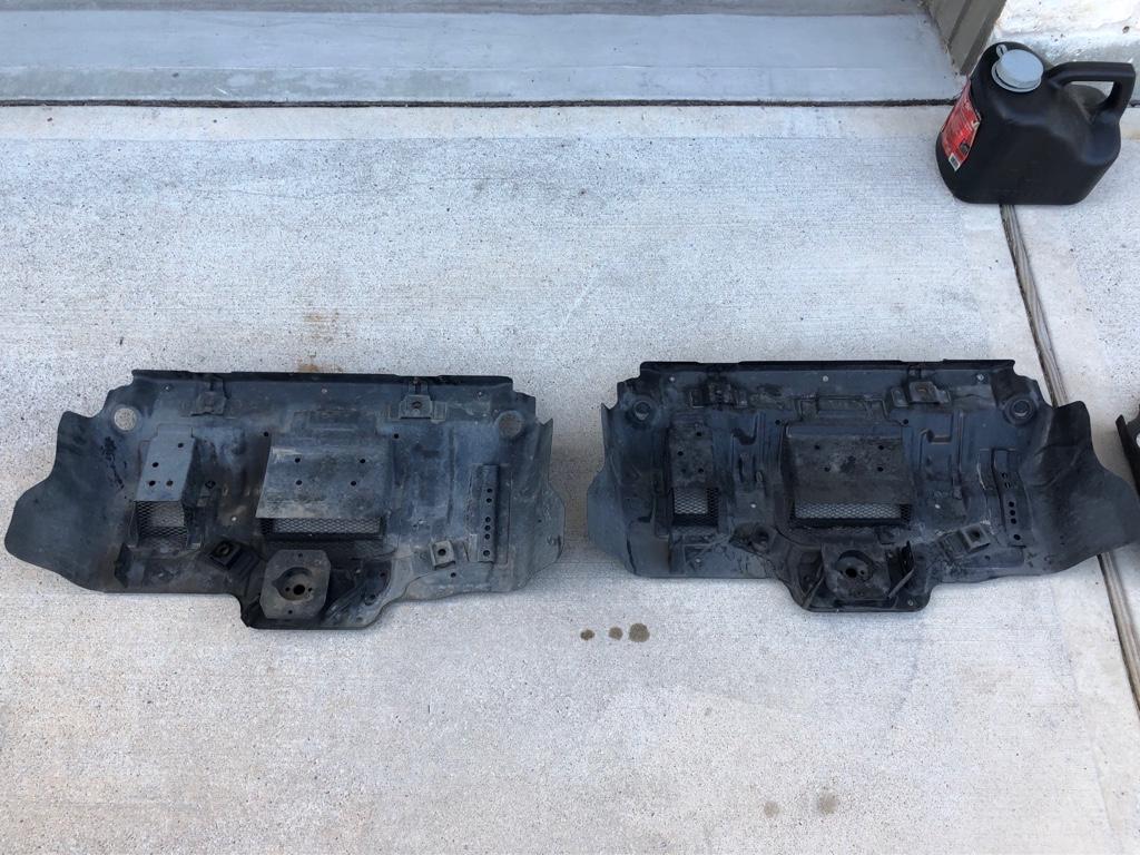

I did a comparison between the skid plates on my friend's 5th gen and my FJ. Pretty much the same thing. I wanted to see if I bought 2010+ skid plates for a 4Runner, if they would work on my FJ.
Parts are being installed quicker than I can update the thread. That is if I was on as often as I was before.
Part Installed
- Fumoto F-133 valve

08/01/19 - PCK installed / new Icon DJ UCAs

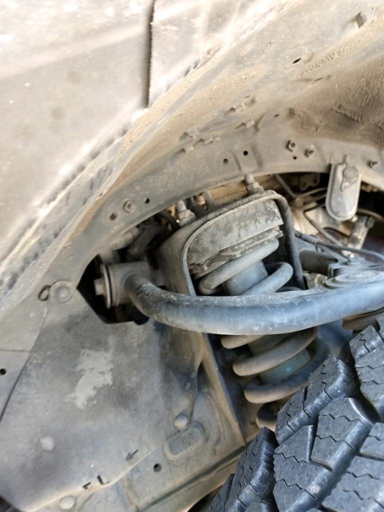

I dropped it off the week before but it's been slow going because we discovered that the UCAs needed new uniball bearings. I decided to just order a new set of Icon Delta Joint UCAs because I prefer the bushings over heim joints that my TrueTravels had. I also dropped off new uniball bearings for the Dirt King LCAs. Glad I did too because the old ones were real frozen on their and required a 100 ton press to get them out. New ones were pressed in with antiseize to prevent issues in the future.
The panhard bar is now horizontal thanks to the eimkeith PCK.

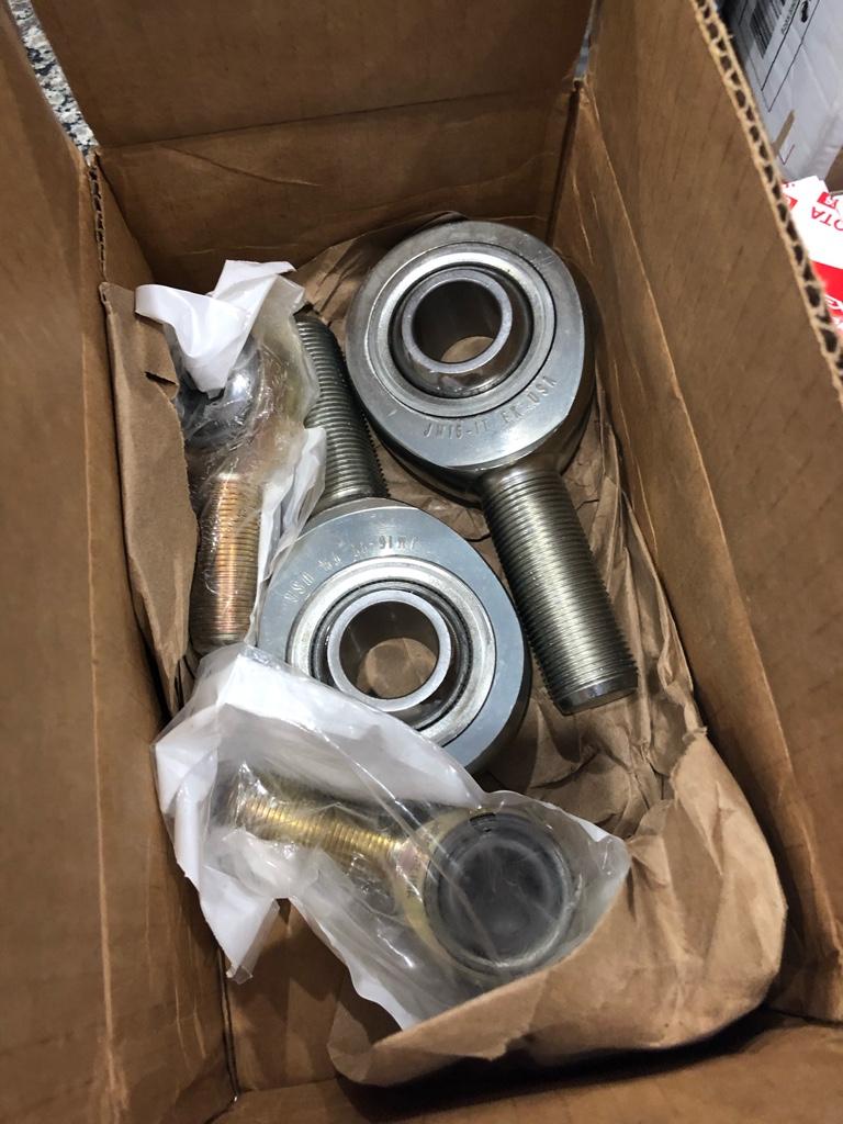

Also received some new rod ends for some parts I haven't listed on the build thread yet. I'll be posting them once I get around to replacing the rod ends and subsequently installing them.

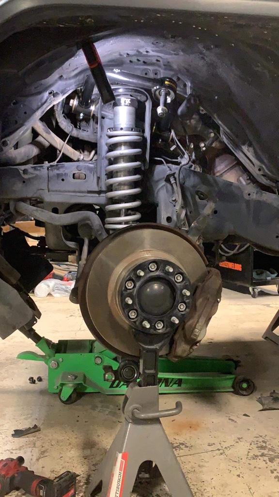

08/18/20 - almost done
A month had almost passed but between other shop projects and getting parts in by snail mail, the job was almost done. My friend had sent off the shocks to be rebuilt by ORW but they said the wait til would be 3-6 months because of COVID. I'll need a rebuild down the road but I might just get 2.5 adjustables by then.
I didn't have a clean before picture except for this one showing the spacer that was on there prior to me getting the front end done.
I had trouble a while back trying to adjust the height on my coilovers and it turned out for some reason the collar had to be spread for it to even move without the spring on there. Looked like an issue that he was able to fix once he had the coilover on the bench.

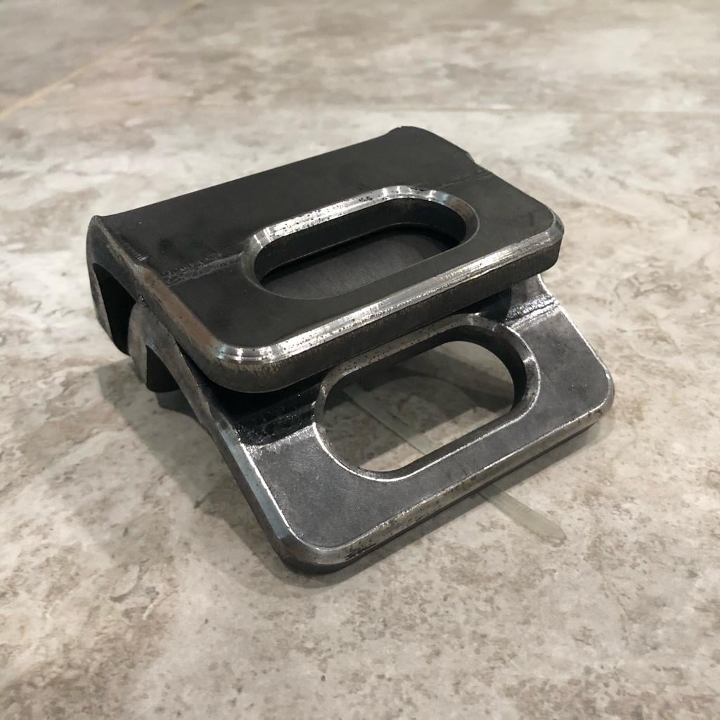

Originally I had ordered the RSG BMC because I liked the design, but there were a few forum posts showing that there could be issues running 34"/35" tire setup with it. I had him go ahead and just fab up a slightly different design.
All he has to do now is drive it around, dial in the height, and get the alignment done.

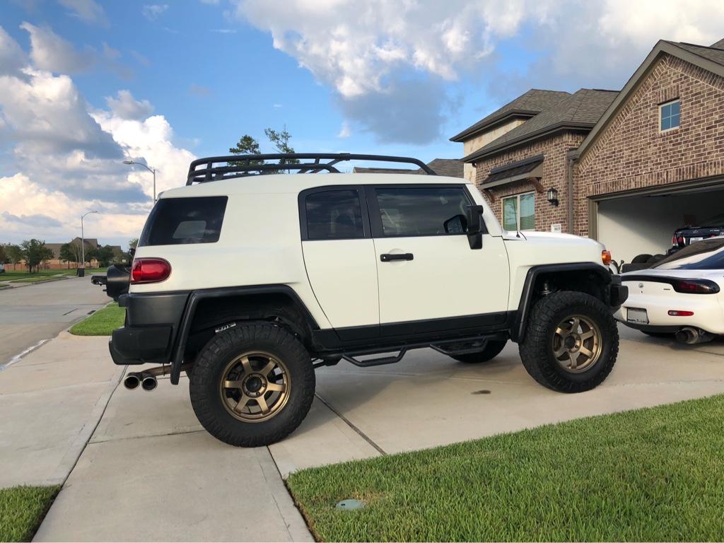

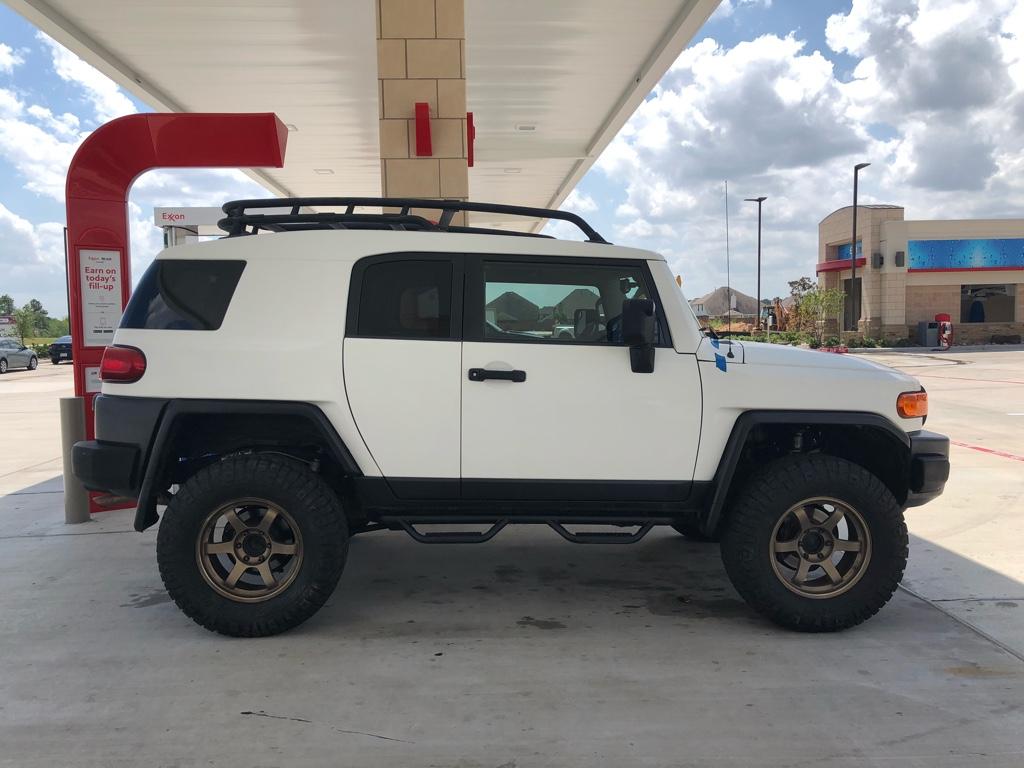

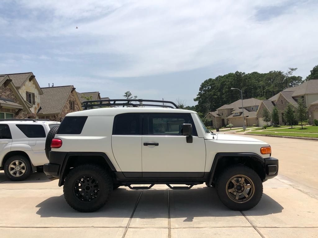

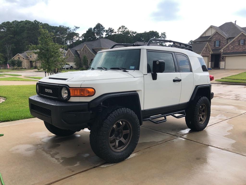

08/30/20 - suspension completed...for now
It took a bit longer than expected but I was glad everything was done and double checked. Any other place would have installed the parts without going through the check process he put everything through. He spent almost a week trying to dial in the lift to clear the 295/70/18s. I almost forgot I had an FJ cruiser since it had been gone from the driveway for so long.
The "money" shot.

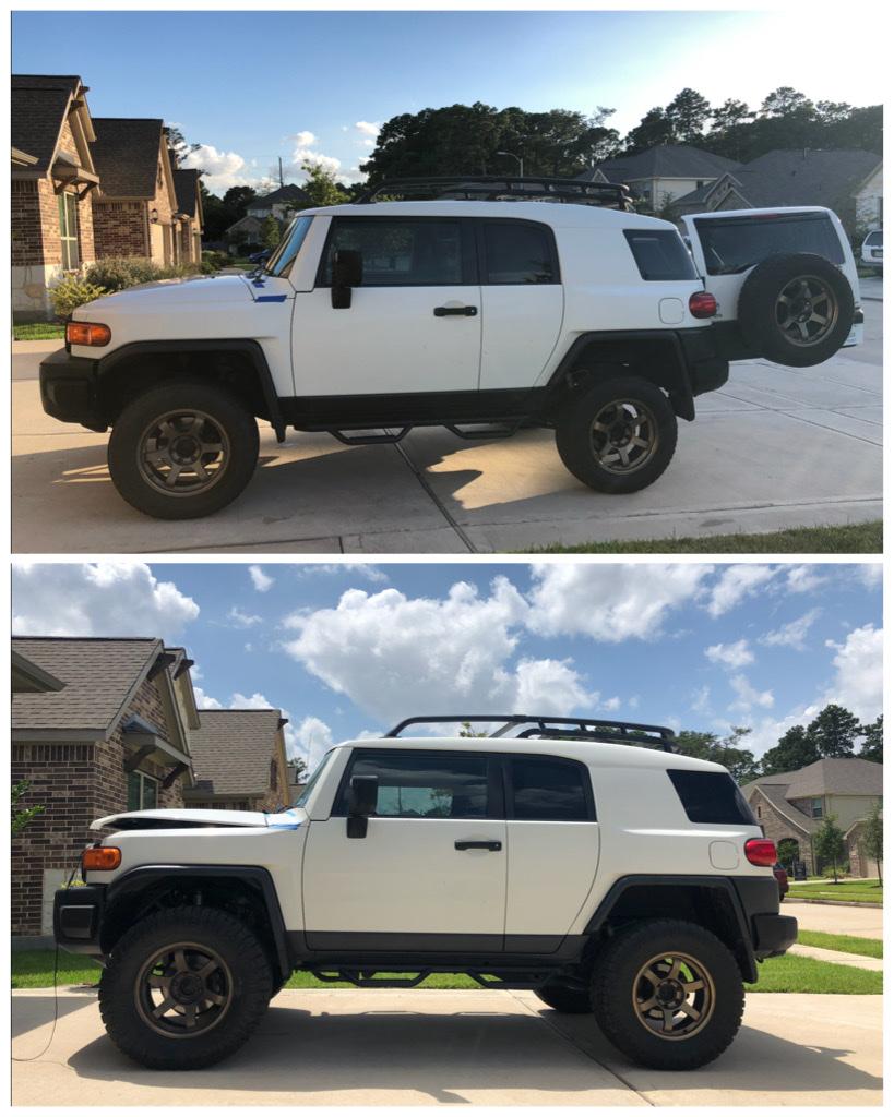

The "money" shot. I still have to install the sway bar spacers, but that's like a tiny part of the big picture.
A couple shots of the completed work including a before and after. It may not look like it changed much but the 34s really complete the project. Can't wait to take her wheeling next month. I'm just glad to have a major chunk of parts out of my garage.

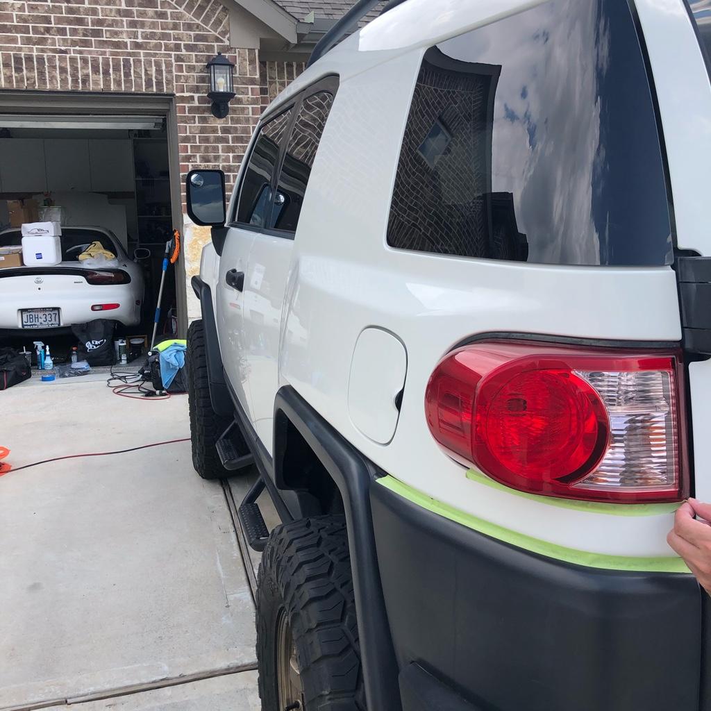

09/11/20 - 1 step correction / sealant
I know some folks will say its a waste to spend on a nice detail job for a trail rig but I wanted a good baseline from where I can keep up with maintenance for paint. There's also the argument that white doesn't show changes as well but I can say it does.
I had the guy debadge in the rear as I was either going to leave it blank or put on black emblems.
I got these off eBay. Not really sure if they're real or not because they're in generic plastic bags without any Toyota part numbers. Look good enough though.
Here is a before and after. I might roll around with it blank for a little while at least.
After the first section of the hood was done, the iceberg white some how became whiter than it was before. I wanted ceramic coating but I knew the rig would be sitting outside so I didn't want to spend 3x the base price to get ceramic coating put on. Luckily I did not because a short 30 min rain storm came in right after he finished putting on the Meguiar's Fast Finish. Still looked great in the drizzle though.

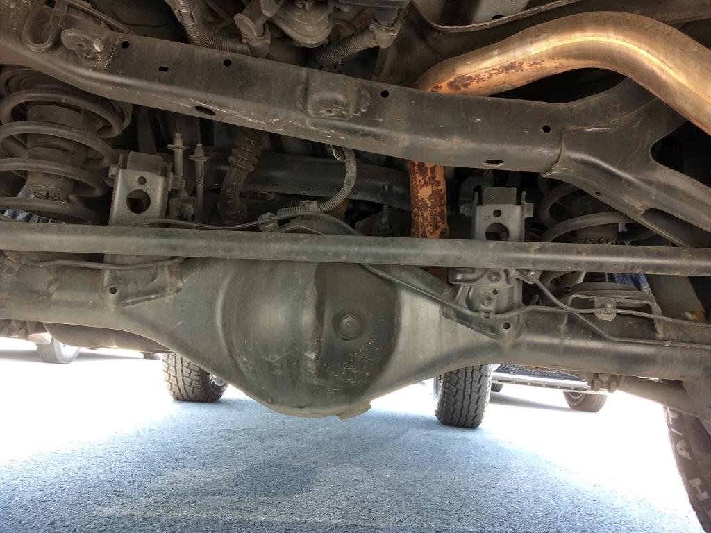

09/12/20 - PDR / Gibson 4th gen exhaust hack

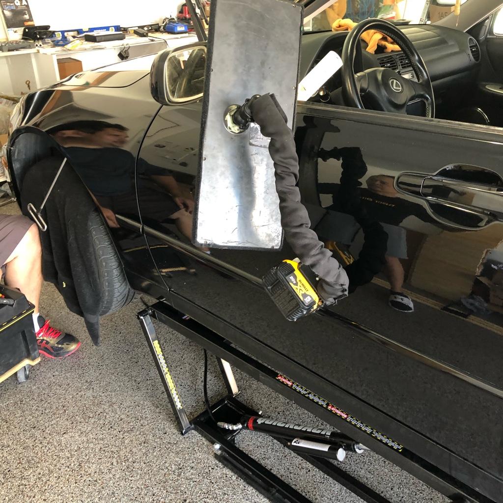

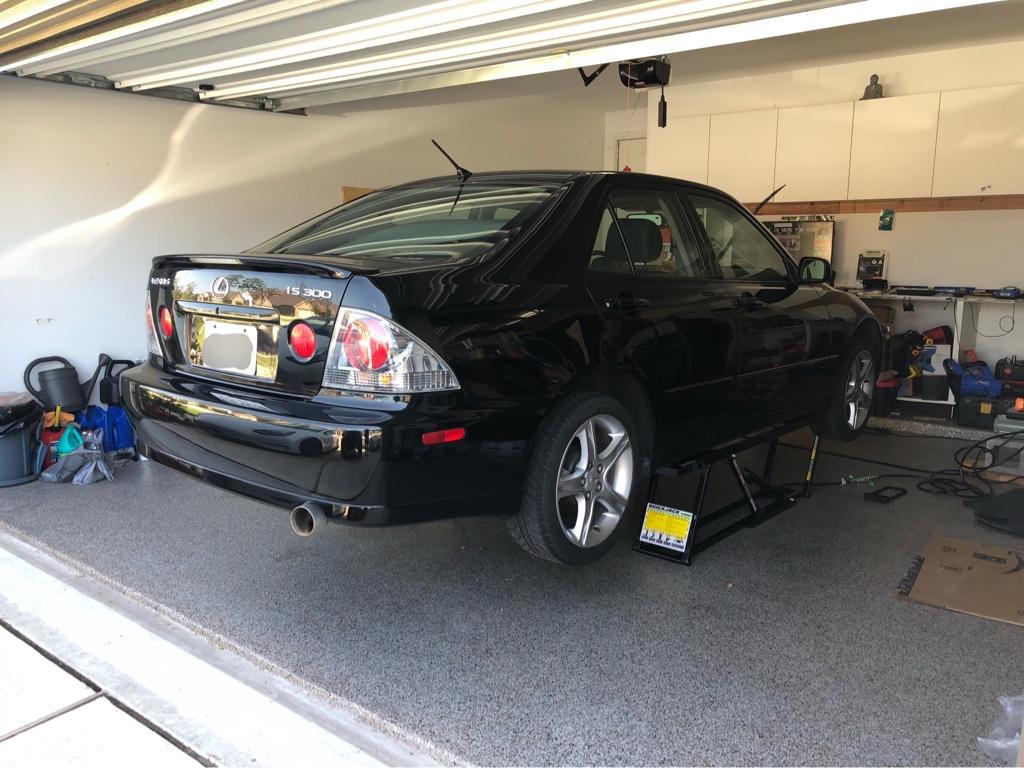

I had a local guy come by and do some paintless dent removal on my IS300. I went ahead and had him perform it on the FJ as well. The FJ had probably 15+ dings on the driver side door. Most likely parked next to the same car that put in all the dings with the previous ownership. They were all in the same region.
I also put together my QuickJack 5000SLX yesterday so it was a good day to test it out. I was going to do some height adjustment on the coilovers later in the week.

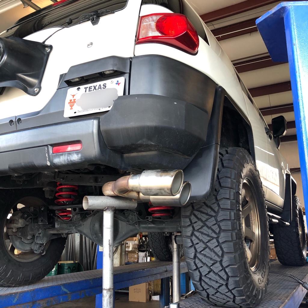

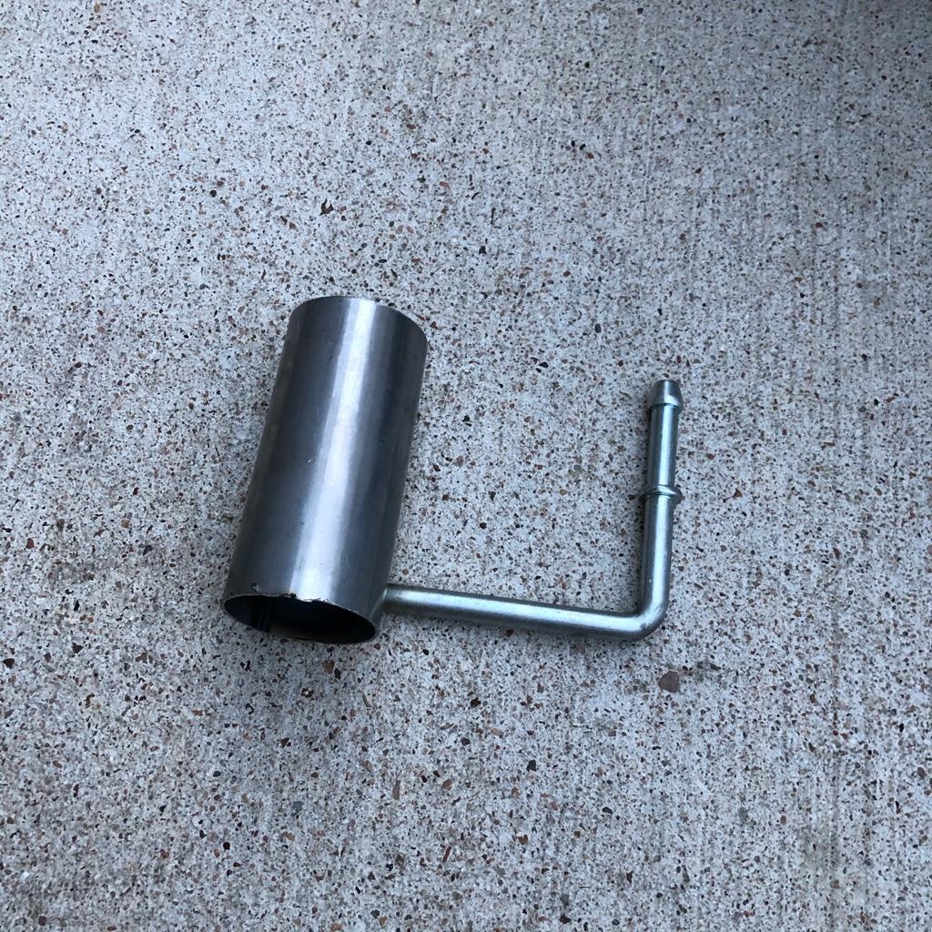

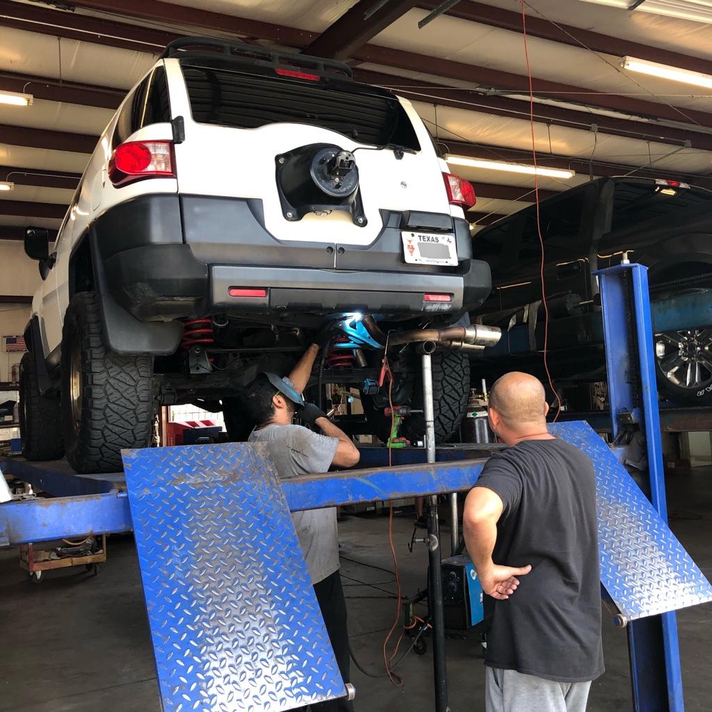

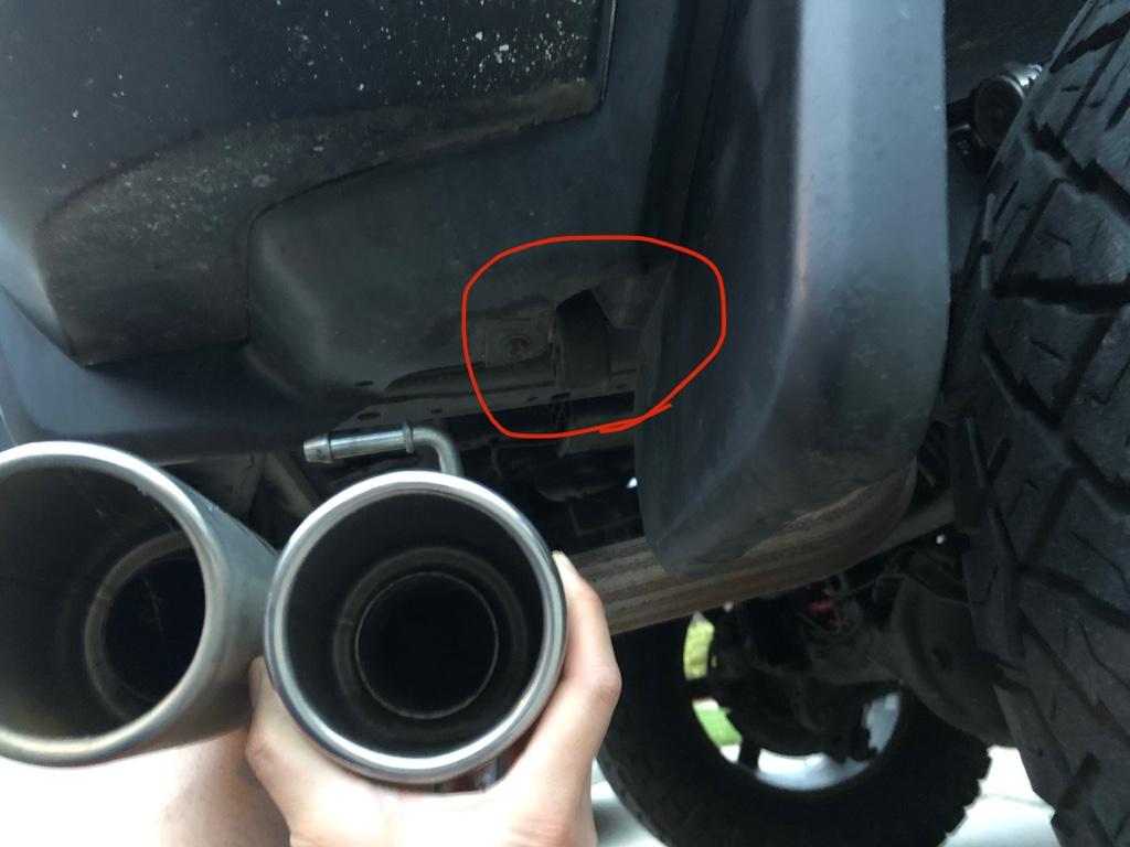

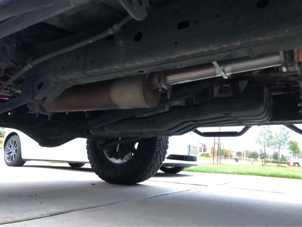

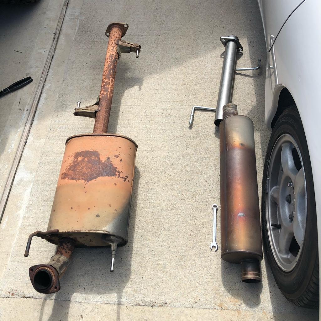

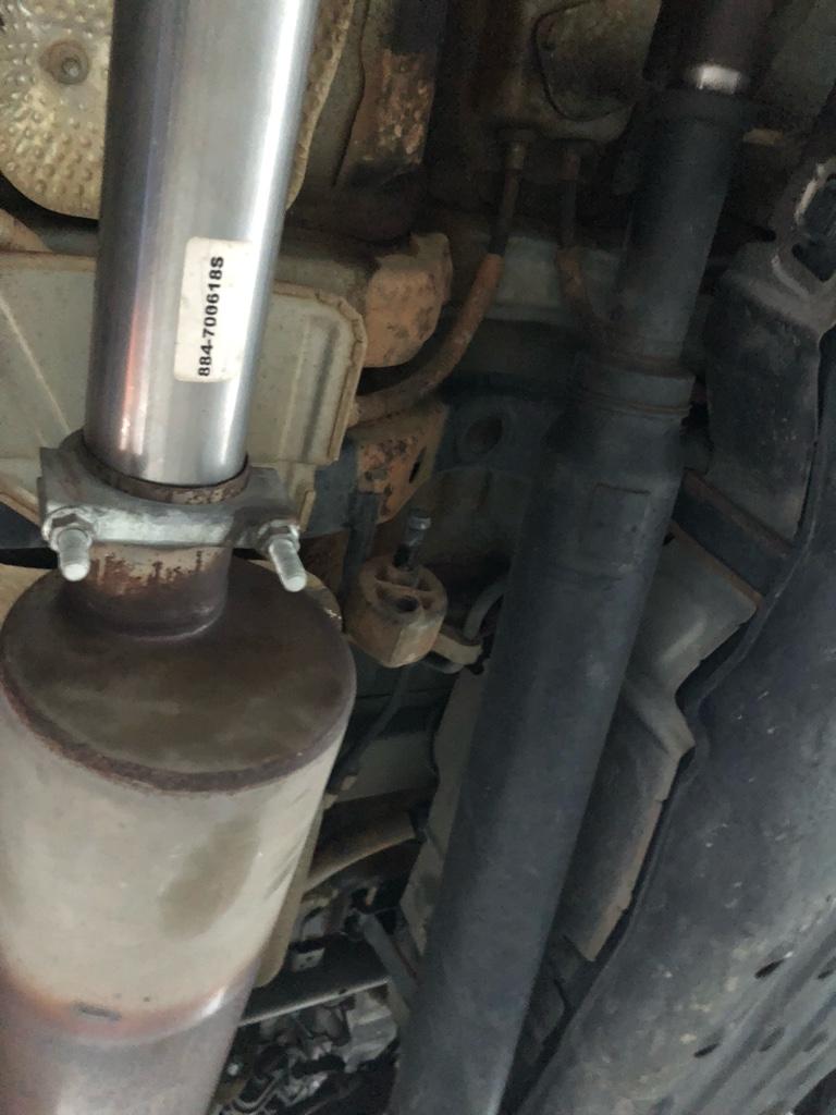

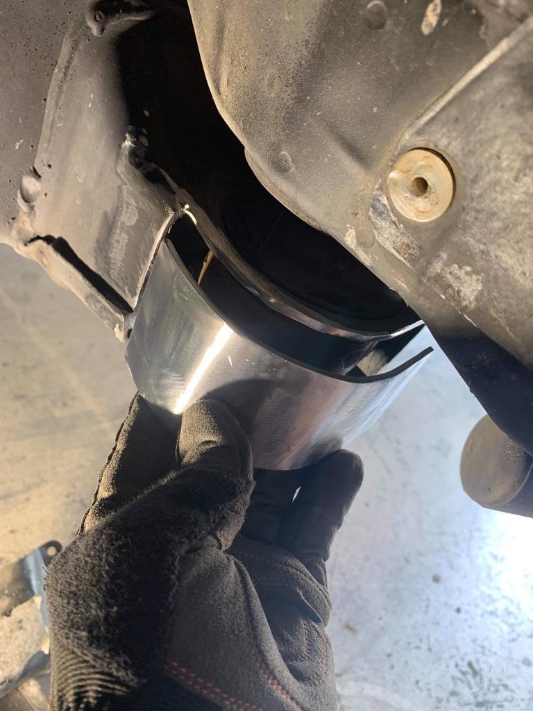

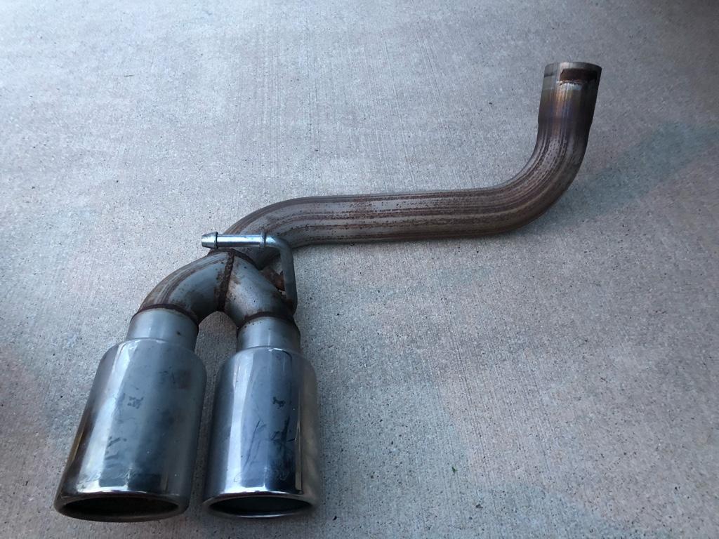

While he was at it, I tried my hand at installing the Gibson exhaust I removed off of my 4th gen V8. They looked slightly off side by side.
Gibson included the midsection for both the V8 and the V6 for some reason, with the V8 being longer. Turns out it was slightly longer than it needed to be for the FJ. The second hanger for the mid section didn't reach the stock FJ exhaust hanger so away it goes.
So from the Y pipe to the axle, it fits now. I almost had to go to a shop to get the mid section cut, but the PDR guy lives in my hood and let me borrow his sawzall. Cut through the pipe like butter, even with the old ass blade.
The stock FJ exhaust hanger sits a bit too far foward despite the wheel base being the same. A trip to the shop is in order for the install to be finished. For now I guess the exhaust will end slightly above the axle.

I went to this exhaust shop I went to almost 18 years ago for my first 4Runner to get a new hanger installed.

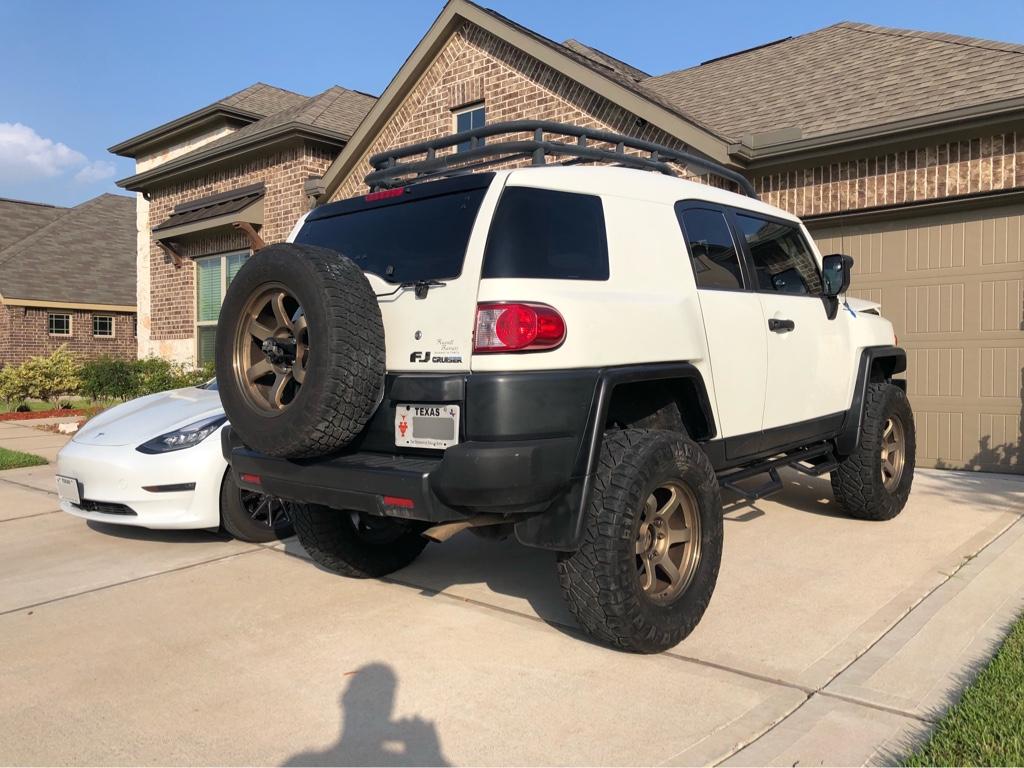

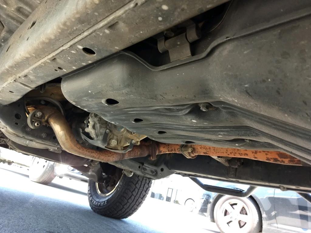

I couldn't tell from the angle I was at but it definitely hangs too low. I also understand why most aftermarket setups come out at an angle because the side exit shows too much of the exhaust piping. I'll have to return to the shop to get it modified again. It still ended up being much less than how much I was originally quoted (~$200) at another unnamed shop. I would have just bought a completely new setup for that price.
2011 FJ Cruiser with Gibson exhaust
Sounds great though, no not very raspy and no drone on the freeway. Can't ask for more than that. I also bought a couple of things last month that I didn't get to post til now.
I bought these recovery points off a thread I found on the FJ forums titled "Iconic Recovery points" but it turns out it was our own [MENTION=130999]Inv4drZm[/MENTION]. Same ones from this thread: Rear Recovery Points
I have had this sitting around for two months now. Will be doing the install soon...
Future Parts
- Inv4drZm / Iconic rear recovery points
- some TRD plate looking thingy

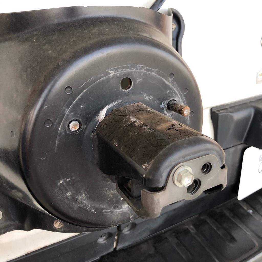

Small potatoes first. I never posted the fixed spare tire stud.
Pretty straight forward. Looks almost stock unless you look out back where you can see the new welds and paint.

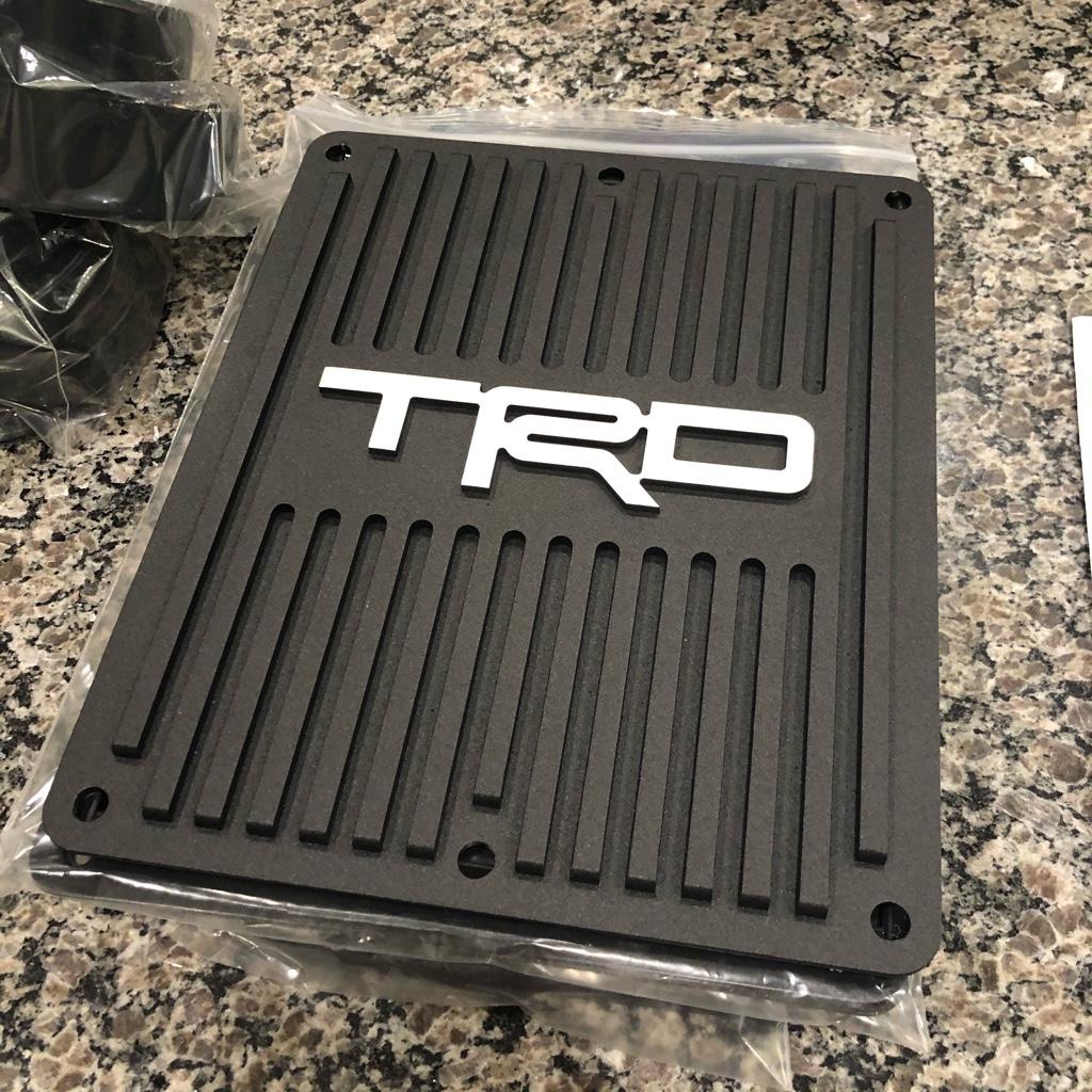

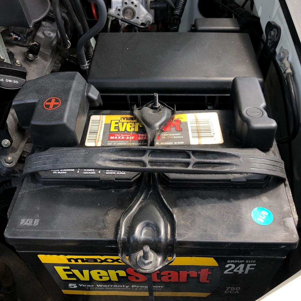

Thanks to [MENTION=171043]kingofthehill[/MENTION] I bought a positive terminal cover from a 5th gen to replace my positive cover. I actually installed this back on 7/18/20 but forgot to put it in the update. Part number is 82821-60270 and costs around $10-15 depending on where you source it from. Also bought a negative terminal cover to "match". It was only $3 dollars on eBay but took about 3 weeks to get here.

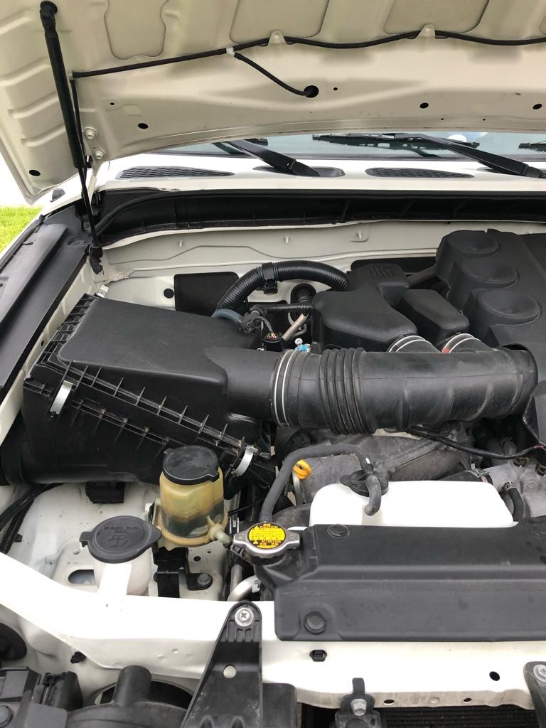

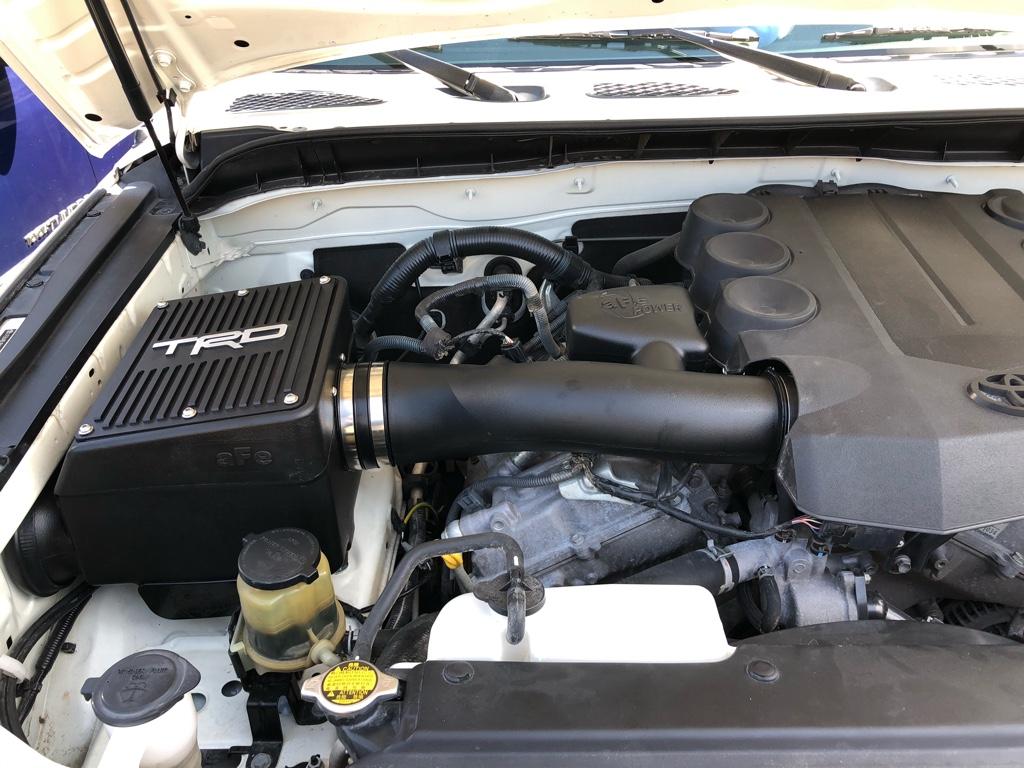

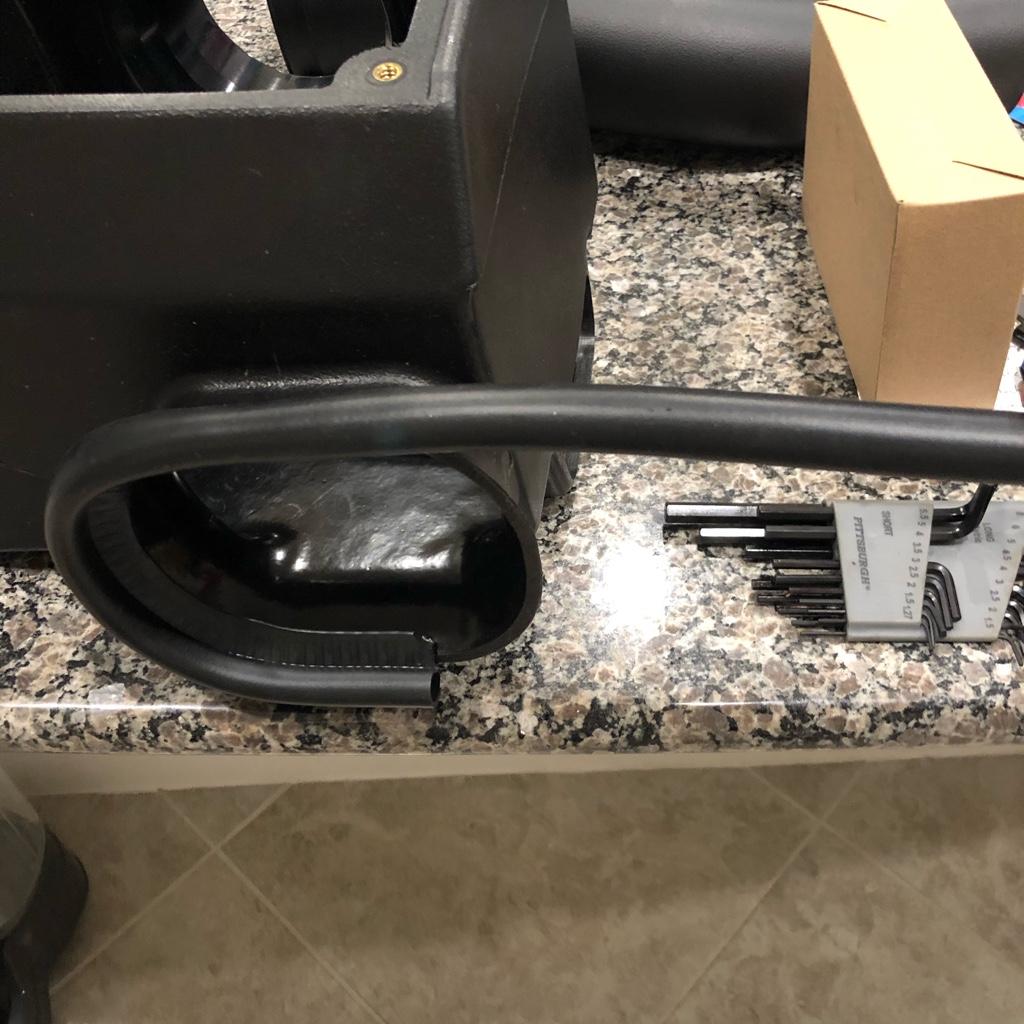

I got an aFe intake and they used to make TRD intakes pre-2010 before TRD decided to just reuse the OEM box with a drop in filter / intake tube. If I knew about it I would have passed on the volant setup for the aFe. I know intakes don't do much but I like the induction noise.
I do have to say that the plastic is nice but it doesn't feel like the price the intake retails at. I didn't pay retail but I did get a brand new one.
This gasket for the "cold air" access is pretty stout. Took me about 30 minutes to get it onto the intake box.

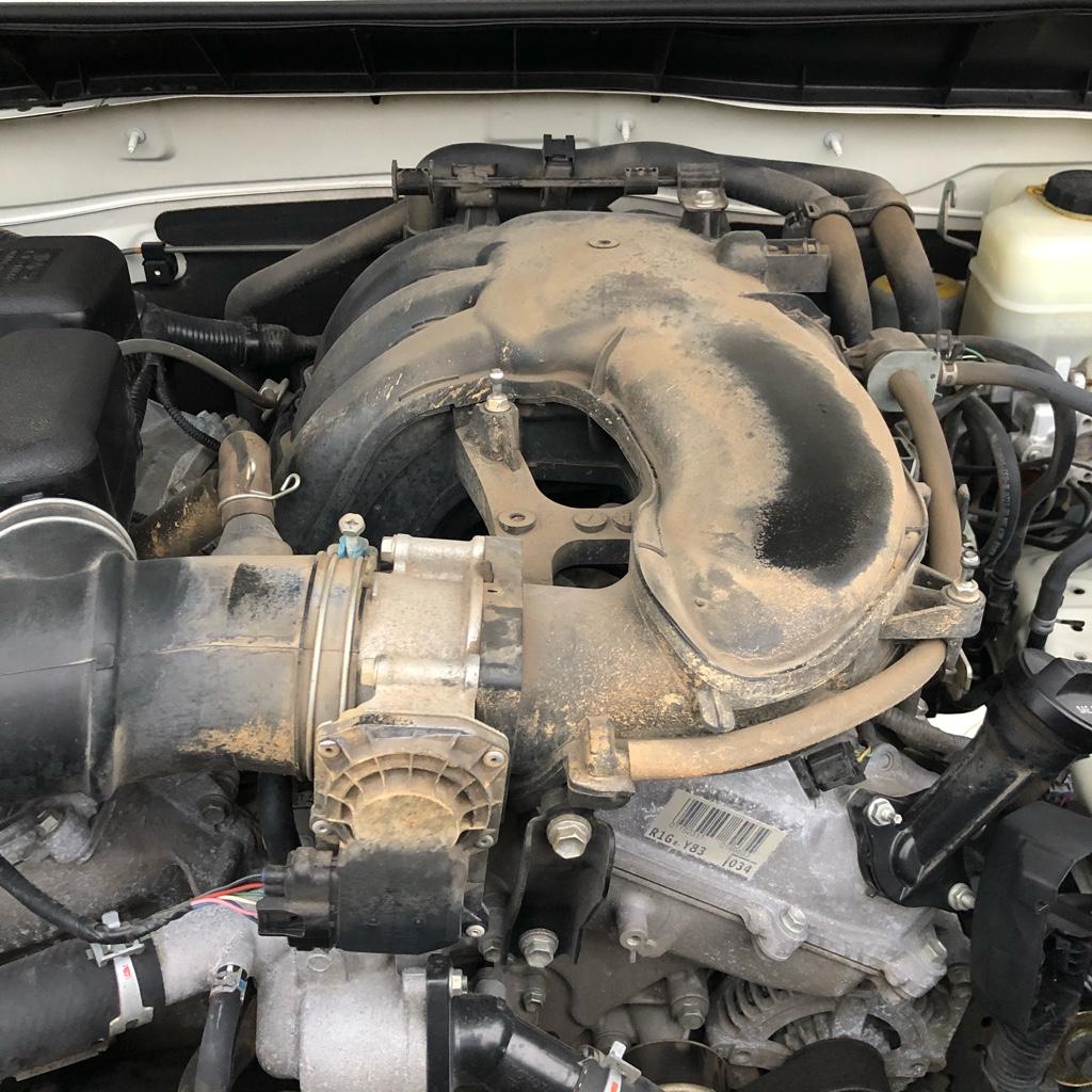

The person that had this car before may have did light off roading or lived on a dirt road because there was a lot of caked dirt under the engine cover and deeper into the engine bay. I noticed it weeks ago when I was working under the car as well. I did clean all of this but didn't take a picture of the aftermath.
Nothing special here. Just the final engine bay pics for now.
The TRD cover I got from a guy that used to custom make them on TacomaWorld. He stopped making them unfortunately. Maybe a cease and desist after 5+ years of making them. I wanted the clear window variant he made prior the the powder coated aluminized version, but he ran out of them so I settled for this version. It's a nice look over the aFe cover and makes it look more OEM+.
Parts Installed
- aFe 54-81932 intake with TRD plate cover
- positive 5th gen 4Runner oem terminal cover (installed 7/18/20)
- negative terminal cover
