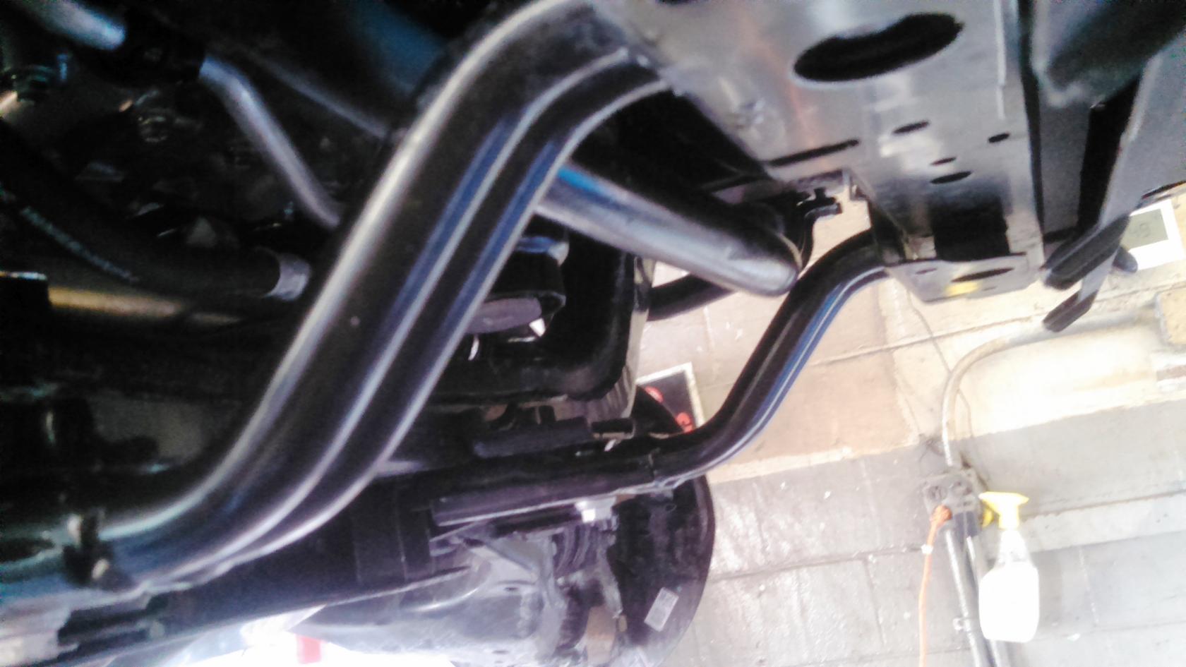

I will say this after just completing a Toytec Boss installation - the instructions were lacking in one crucial area for the sway bar. They supplied an RSDK kit with the struts and a spanner wrench… I downloaded the instructions from their web-site and proceeded accordingly…
All was good. Installed the relocating brackets for the sway bar which are required for my vehicle year and shit – the sway bar would NOT bolt in. It was interfering with the lower radiator mounting assembly. I was completely unaware that the RSDK was not just for the Diff drop (which I decided not to do) but also contained spacers for the (2) radiator support brackets that run from the radiator to the frame. See in picture. The instructions did not mention any of this and when I called Toytec technical they immediately sent me a PDF of the install... which I’m also attaching – which calls out installation modifications for FJ Cruisers… not necessarily 4Runners. Weird. But after install of the spacers everything was fine.
Just a FYI here. Don’t know what vehicle year you’re talking about installing your Boss system to; hopefully your install goes without my little glitch.

Wow. Thanks for all the replies, fellas. I don't expect to do much hardcore wheeling right away, so I'll likely keep the swaybars. Sounds like that's the consensus here. My 4runner is also my daily driver, and sees far more road miles than trail miles right now (something I hope to rectify in the next few years). And thanks to Waterman for that informative pic and PDF. I would have likely struggled with the same issue. You just saved me some headache, my man!
