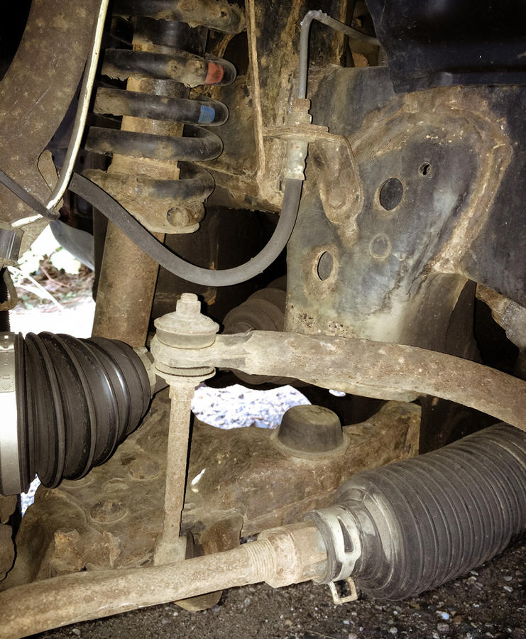

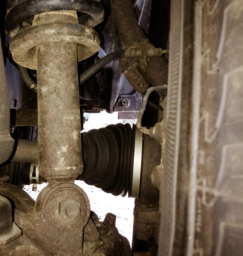

I have a '97 Limited, and I use it as a DD, but rarely any off-roading. Right now it jumps quite a bit on any small bump or even going over manhole covers. It bounces 2x cycles when pushing down on the rear bumper.
I noticed that my rear sag issue was fixed in 2002 (before I got the vehicle). So my car sits at a fairly stock stance. (20" front / 20.5" rear—from center hub)
I don't really need a lift, and so I think just replacing all my shocks with OEM Tokico Trekmasters is the way to go.
Is there anything else I am missing? Are springs something that should be done at the same time?
FYI: I decided on the Tokico because I've read that the Bill's are a bit stiffer of a ride, and not necessary for my style of driving. I decided on these instead of KYB's just due to the OEM quality of these. Correct me if I'm wrong. Thanks guys.

You didn't specify how many miles your 4Runner has, but you may want to replace your springs if you have a lot. Mine has 200,000 on it and the first thing I did when I bought it was put new shocks on the rear. This helped the ride a little but my springs were so shot that it was sitting on the bump stops (it had the TSB done in 02 as well) and bucked whenever I hit dips because the rear was bouncing off the bump stops when the rear tried to compress. I added a 1 1/2" spacer to the rear to get it off the bump stops and it made a huge improvement until I can get a lift. I'm ordering new springs and front struts in the next couple of weeks.
251k. If your springs are soft, do they normally sag? Is there another way to tell if they are wiped out? I measured the distances from hub to fender, and they are precisely the same as they came from the factory, so I didn't think I would need to replace them. Maybe that's not a symptom though... For now I think I might just replace the shocks and see how that feels.
Well I just replaced all 4 shocks, new front/rear sway bar bushings, and two front end links (One broke off while trying to get it off). Left the original springs on, and reused the coil overs on the front. It rides fantastic!
We ONLY had to cut off 4 bolts off due to rust, so it wasn't an easy job, but it rides GREAT! Thanks for all the advice.
