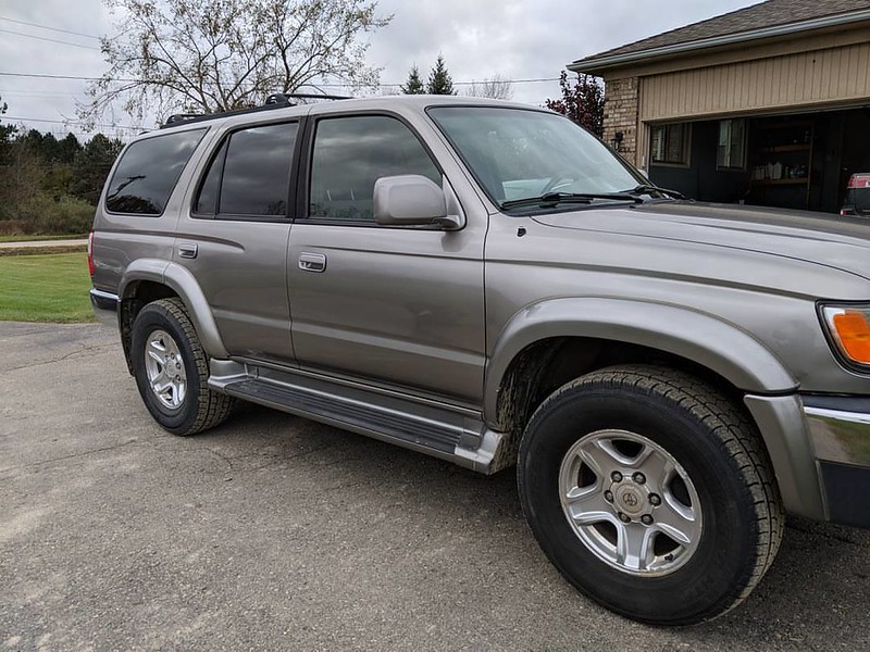

Picked up a 2002 SR5, 4wd, w/ center diff lock yesterday. I've been shopping third gen's in an attempt to get a cheaper daily driver while I am back in school.
I currently drive a 2011 Nissan Xterra built up for off road camping. I have been very happy with the Xterra, but it's really more than I need, and I have always liked the older 4Runner's for a compact DD/trail truck. I plan to use this thread mostly to document my maintenance, and get ideas/answers from you guys.
The 4Runner runs and drives as is, but it's due for some maintenance and TLC.
Vehicle:
2002 SR5, 4wd, Center Diff Lock, 222,000 miles. This was a one owner vehicle purchased for a friend-of-a-friend's wife. They have a pile of maintenance history with it. It has been parked for the past year or so since she got a new car, and have only driven it monthly just to keep it running. I paid $3800 after a bit of negotiating, which I was happy with given the condition and history.
My goal is to freshen it up for DD/light trail use, and save another one of these great trucks from rusting into a field somewhere.

Got the running boards off tonight, only broke one bolt.

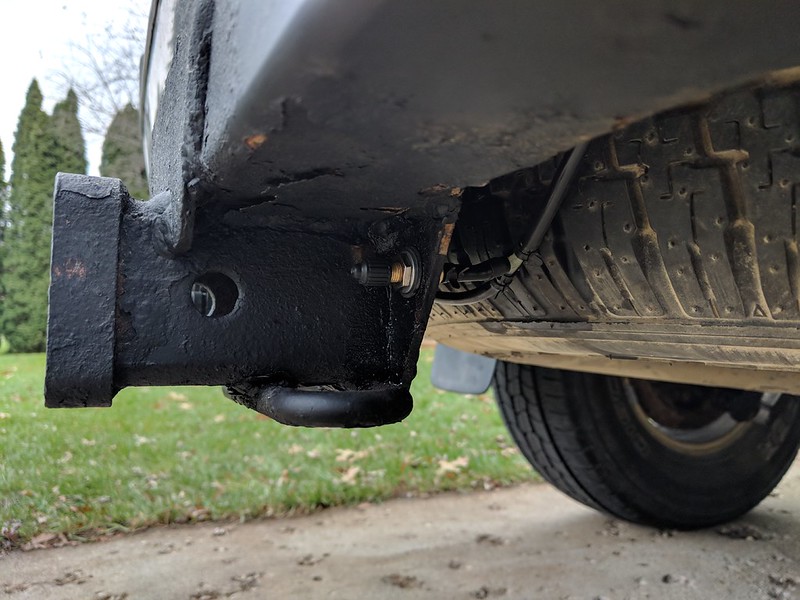

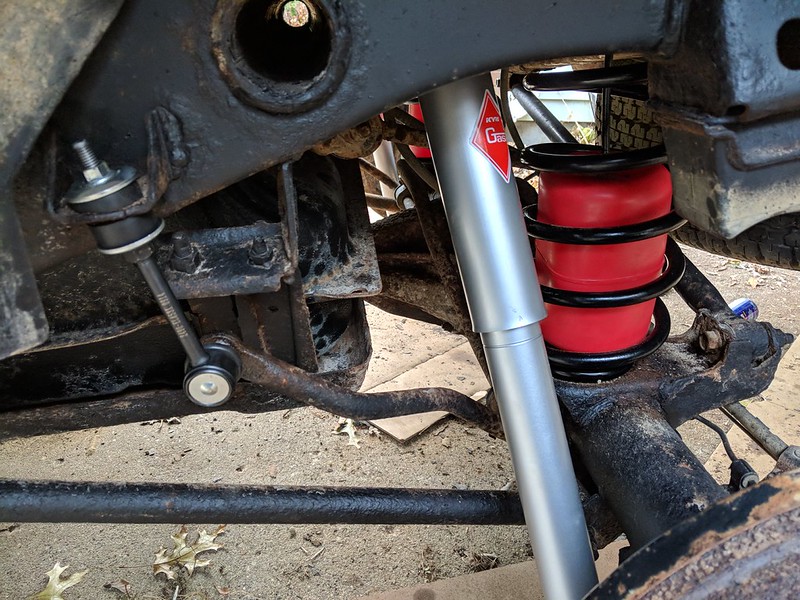

Rear suspension done, and a bunch of rust wire wheeled and painted with Seymour rust converter aerosol. Pretty happy with the paint so far after a few weeks of driving.
The whole thing is kind of riding like a drag car now with my clapped out front end and fresh rear end, but I hope to have the front end done in the next week or so.
KYB Gas A Just shocks
ACDelco 99 springs
Airlift 1000 airbags
ACDelco sway bar links
I'm a little nervous for you with that rust bubbling I see. Check the frame where the rear lower control arm mounts are welded to. They rust from the inside out so you need to poke with a screwdriver or similar. Good luck with her, I love that color. :dancin:
I'm near Howell.
Regarding the rust, I looked it over well before buying and I'm familiar with the rear control arm mounts. There is surface scaling but it all felt solid with the screwdriver test. I am in the process of cleaning, converting, and covering with Fluid Film as I go. It's a process, but such is life with old Michigan cars.
