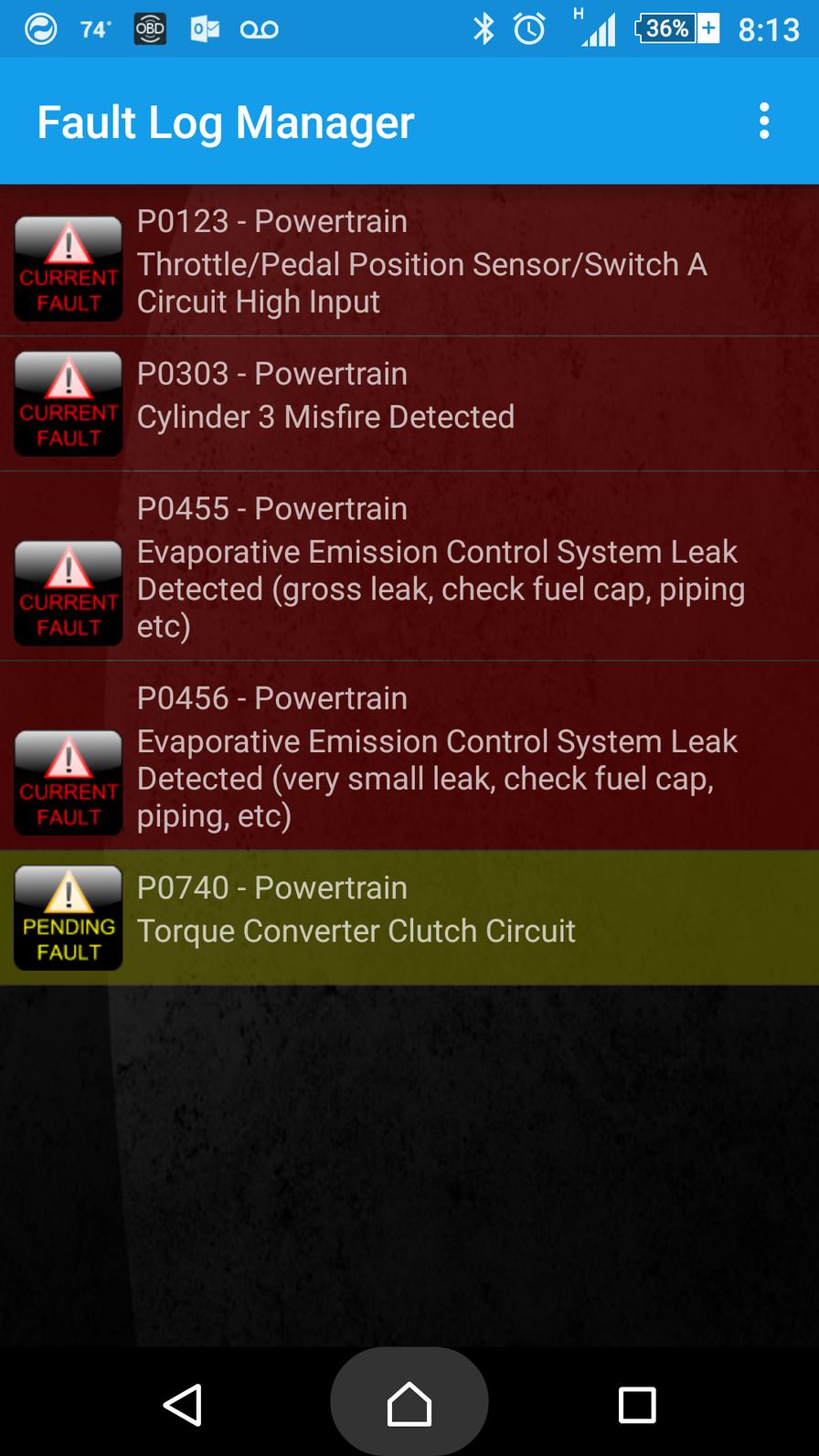

So I apologize in advance because this is not about a 4runner but instead about a 2000 jeep Cherokee. I'm asking because it's my new girls and since this seems to be a ton of transmission problems, which is a realm u never had to indulge in I'm coming to you to ask. I feel that the Jeep forums lack the knowledge many of my fellow 4runner enthusiasts do. So if you don't mind help would be appreciated. I'm getting a ton of codes, I'll share the picture. I'm wondering if a lot of these power train codes are the result of one specific problem that's making multiple ones pop. I have to fix her whole cooling system because it's shot. She has a huge coolant leak that I did a temp fix for now until I can dig in and find the source but I'm pretty sure I know what it is. When I opened up the coolant reservoir and saw a ton of sludge I figured it's been neglected from its previous owner as well since that doesn't build up that quick in a year. The engine is dirty and I can only imagine what the inside looks like.
Help is appreciated!!!!

There are a couple of Jeep forums that aren't too bad; remember Chrysler codes often overlap so if one applies to a Grand Cherokee, it should apply to others:
I take it this one has the 4.0L.
1. TPS, but make sure the clock spring is OK.
2. Injector more than likely, they get hot being over the exhaust manifold.
3. No idea.
4. No idea.
5. Here is the FSM tests for the PO 740. My neighbor's torque converter went south on him which threw this code:
Po740 code problem - Jeep Cherokee Forum
If this is a Cherokee and not a Grand Cherokee you should be asking this at naxja.org
The technical knowledge is there.
P-codes are mostly universal by federal mandate. Anybody here, or on any board, can help.
1. TPS
2. Injector as stated above could be it, but a spark plug failure is much more common and easier to check. Swap plugs between cylinders and see if the code moves with them. If not, swap injectors.
3 & 4: same problem. You have an evap leak. Check that the gas cap is sealing and all hoses and fittings between the gas tank, charcoal canister, and intake manifold.
5: not sure. I've heard of sensor failure doing something similar in Chrysler transmissions. I'm an engine guy, not a trans guy though.
