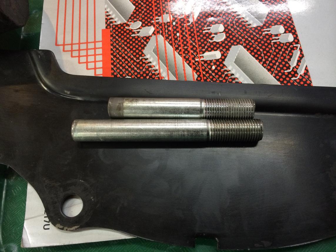

Staging studs
make two studs, one a wee tad shorter than the other to align things so you dont have to do it with the torque converter pilot,
insert studs into a couple bolt up holes to ease that trans on

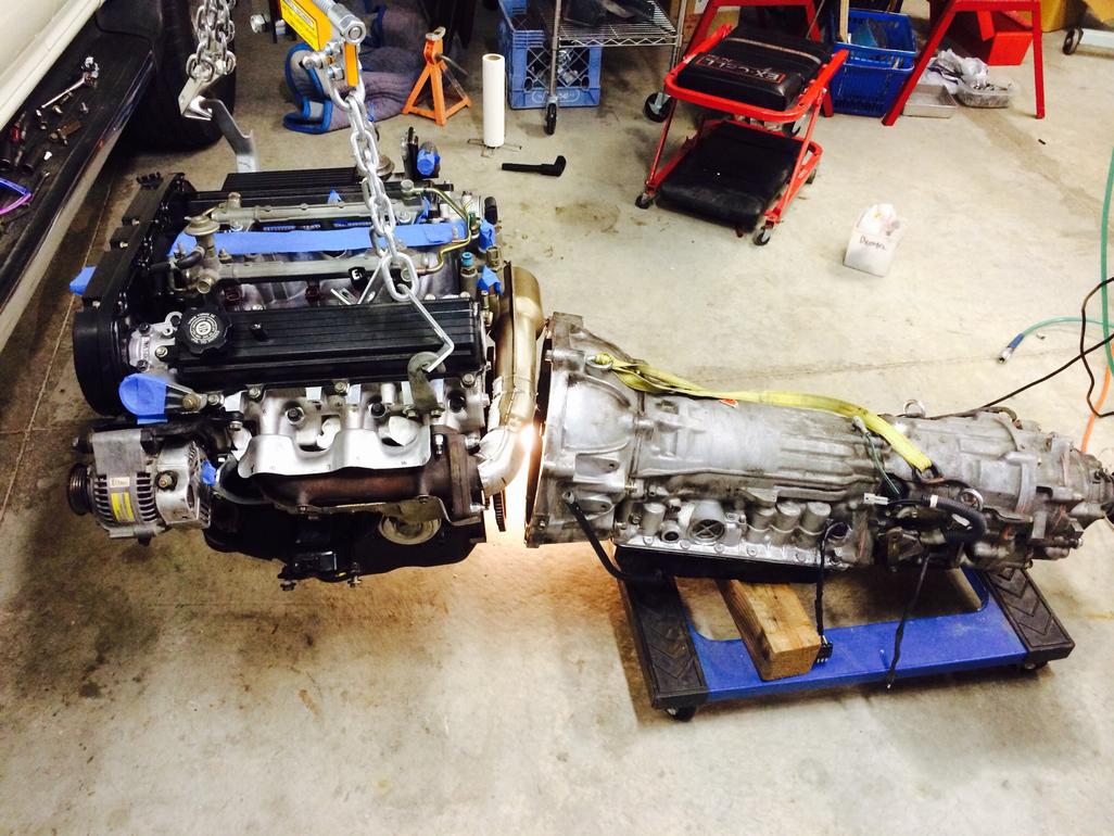

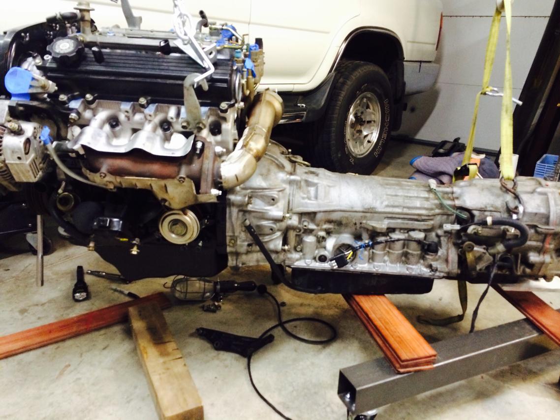

on the level
I really have no clue how I leveled ( off leveled as a matter of fact) this 8 foot long monstrosity when pulling it awhile back.
I'd be tempted to install in separate pieces but the monster A340 overwhelms my trans jack. Has to go in coitus.
Probably hit the pickypull for a couple more eng lift hooks so I can grab it by four corners, to get that necessary angle.
I lift using a sling & chain fall over a beam over the garage bay, so I actually have to slip the TRUCK around the eng/trans, not the more common process to move / maneuver eng INTO truck. Not unlike holding a lightbulb, while the world spins around me.
I picked up another set of HF car dollies (tire roller skates) yesterday to put all four corners on casters.
Could be mighty embarassing if it slips away from me and rolls thru the gar door down the driveway
