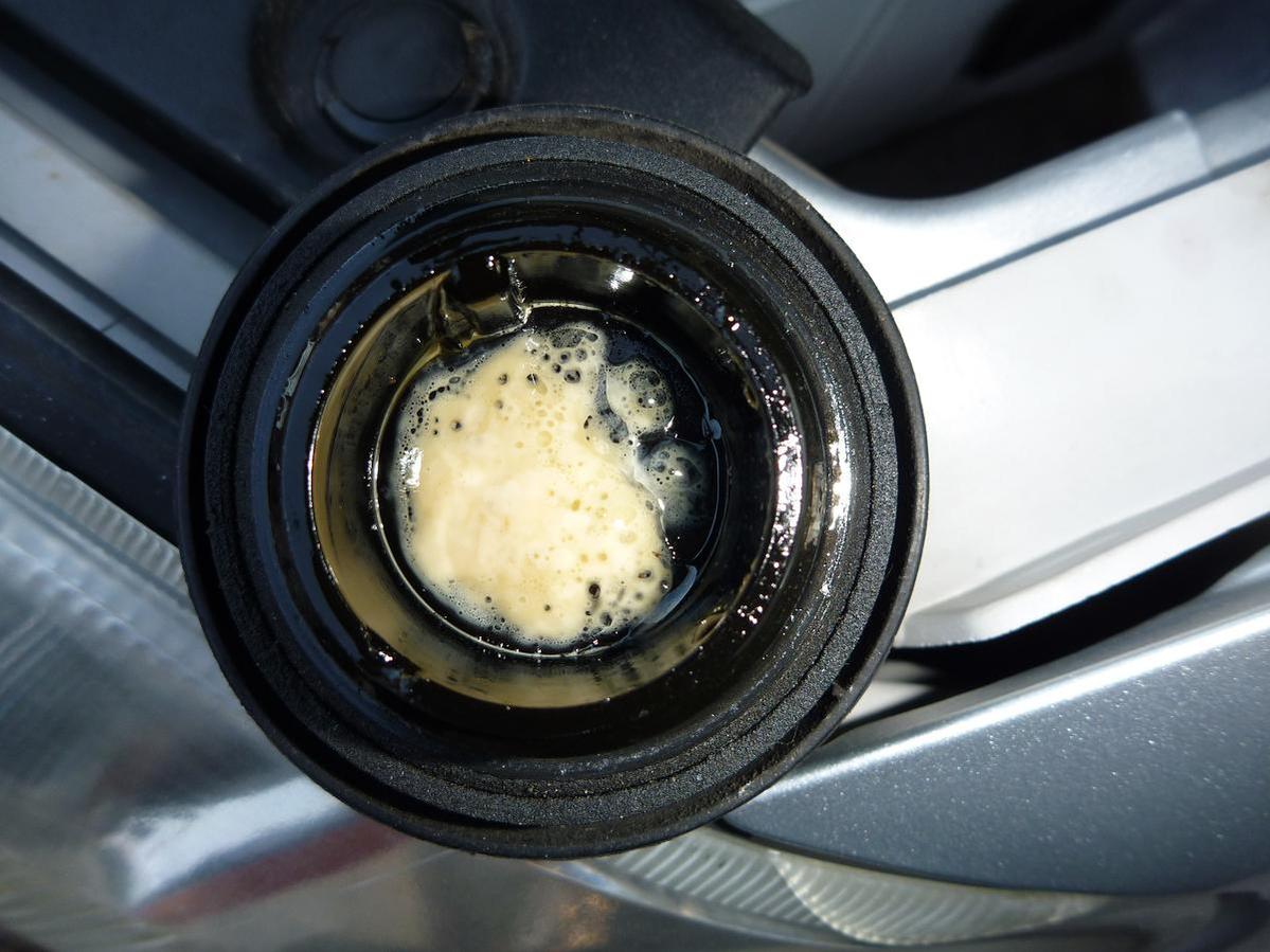

I noticed today that there's something weird under the oil filler cap, as shown in the picture.

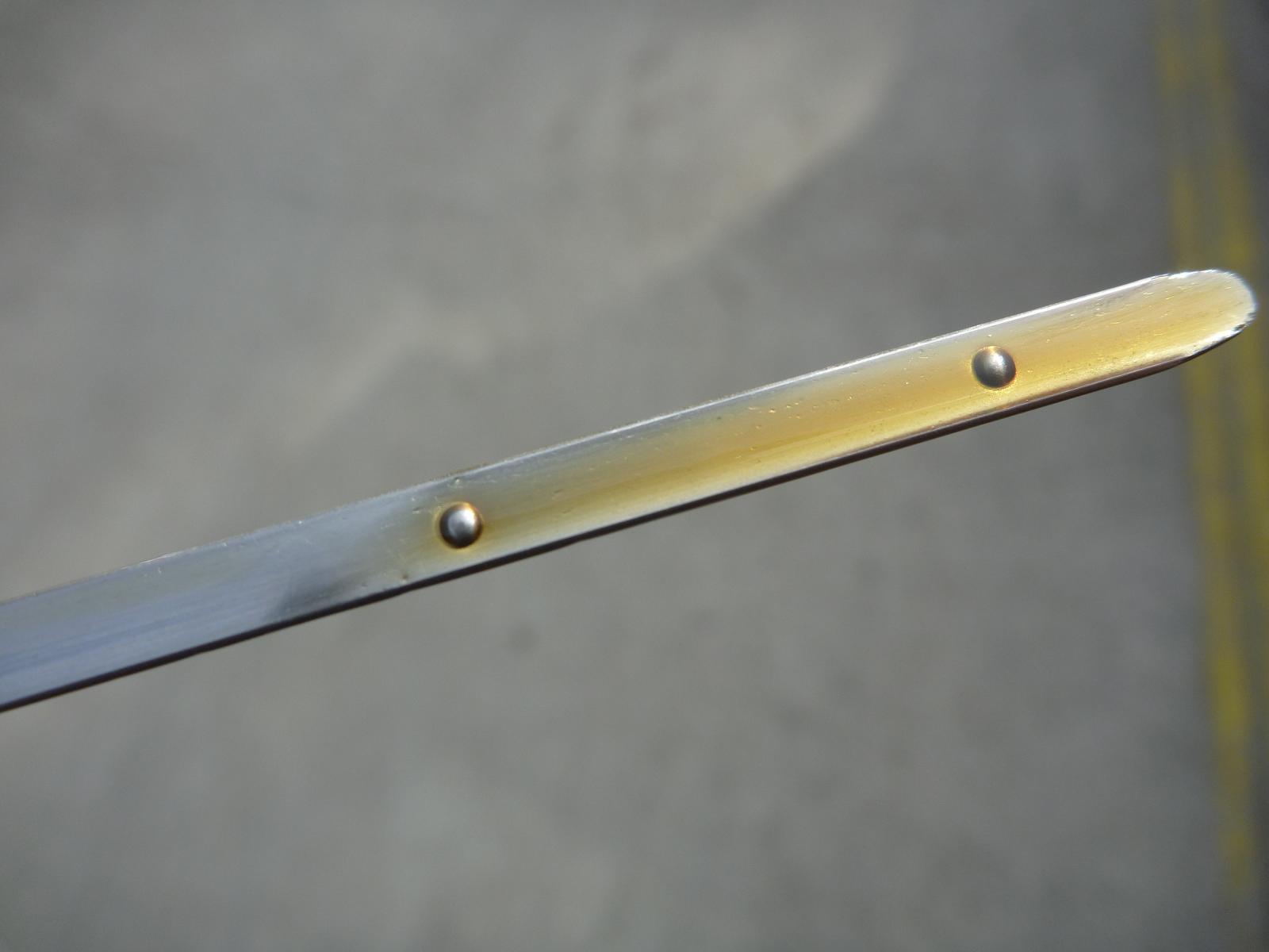

I then took the dipstick out, wiped it clean and then inserted again to check the level and it doesn't look very good as the level seems to be well above the MAX point. Tried a few times and the results are more or less the seem as shown in the second picture.
So does this mean that there's too much oil in the engine?

Cold weather + short trips = condensation buildup in the oil causing your white looking oil-fill cap.
Condensation means water. Condensation isn't going to raise the oil level. Water from the cooling system into the oil system will.
Do you know positively that your oil level was correct at some point?
You should do an oil flush and change as soon as you can. (1/2 qt of ATF fluid in the oil for 50-100 miles makes a great flush)
If you get the foaming again and increase in level, get a full compression test done. You may have a head gasket going out.

Is your coolant low? Does that foamy stuff smell like coolant. If so you've blown your HG.
edit: the fact that your oil level is "high" makes me lean toward HG. You can't get THAT much condensation to increase the oil level.
Thanks for the suggestion, I let the dealer changed the oil a while ago and didn't really check it, but I did notice that the coolant level was higher than it is now(it's now just at the middle point from Low mark to High mark but I seem to remember that it was higher than that earlier)
I'll change it soon but could you be more specific about "oil flush"? Does that mean I change the oil with 1/2 qt of ATF fluid+oil or does that mean I add some ATF fluid in the old oil?

Thanks for the suggestion, Coolant value might be low from what I could remember. I'll try to smell it tomorrow cause it's cold out now.
Since it is already high, add 1/4 quart to the oil.
So shall I just use the toyota type IV ATF?
:(I tried to smell it today but the oil filler cap just smells like oil and the coolant doesn't seem to have a distinct smell that I could tell under the cover of the heavy oil smell.

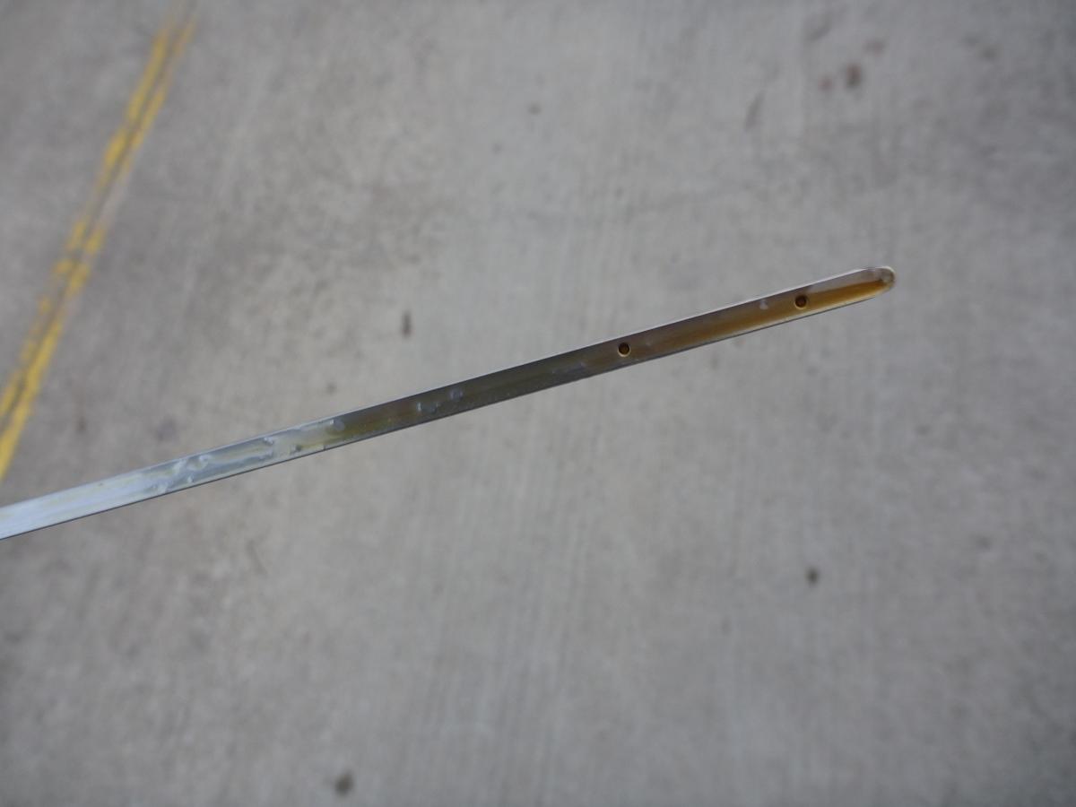

Pulled the dipstick again today and the result changed, as shown in the photo, I didn't do anything to the car(and didn't even start it), :confused:

may I ask how short is your commute? I also commute short distance frequently but do not have this problem (yet).
I actually don't drive along a fixed route, but the longest one is like 3 to 4 miles and sometimes less than 2 miles.
I did try to warm it up for like 1 minute or 2 at each cold start and the water temp will sometimes rise to 1/2 of the gauge when I arrive, sometimes close to that.

Change the oil and also check your radiator cap to see if it has the same oil/water look also.
The radiator cap with warnings on it seems to be very clean and the radiator is full so some coolant spilled out when I try to remove it.
Will do the flush and change asap.
