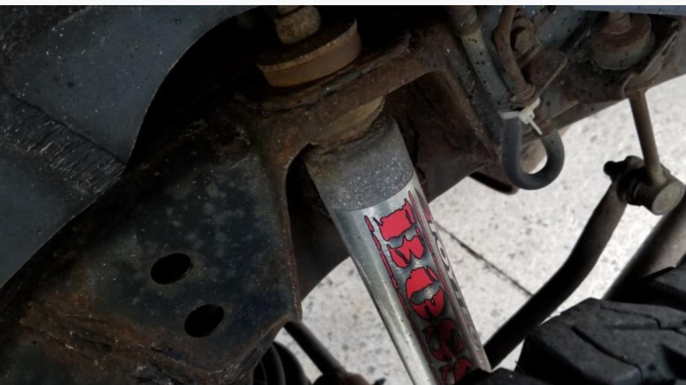

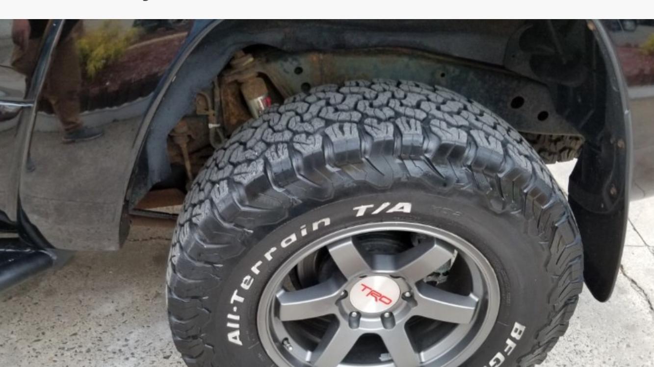

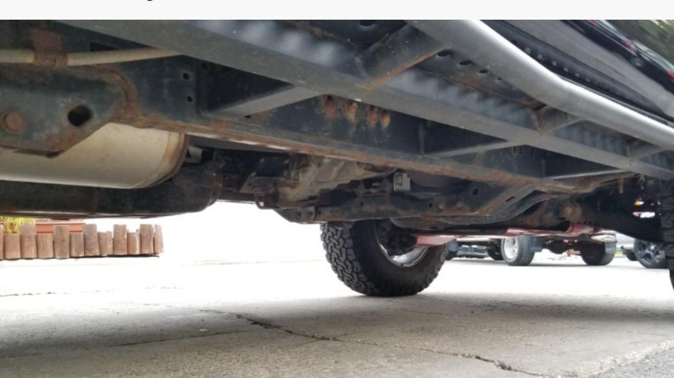

Looking for advice.
I’m looking to buy a 4runner and saw a pretty nice one online but it’s a bit of a drive to go see it so I would like your opinions about it before I go take a look.
My concerns: how old is the suspension (do you know if it’s an older model), is it a quality suspension, how expensive will it be to replace components of the aftermarket suspension if needed, is the rust on the components and frame something to be concerned about.
Other concerns is how beat up could it be as it seems to have been off roaded, the electrical as the headlights seem to have been swapped and I see switches and other components for things like a CB radio that was removed. Obviously it’s on me for the electrical but just want some opinions.

Toytec boss rear shocks and it is a good suspension (cant see the front so no telling what it has there) also has welded on sliders, so most likely was offroaded. The rust looks like more then I would like, but as long as no metal flakes are coming off and you can scratch it and see shiny metal underneath, you should be able to sand it to bare metal and just paint it.

Honestly, it looks pretty typical as far as rust goes, but I would pay someone to put it up on a lift so they, and/or you can look it over better for actual rusted through areas. Very difficult to spot from just the pics, or a quick examination laying on the ground. It has aftermarket rock sliders welded in, which definitely says to me that it was off roaded, as most people wouldn’t do that just for looks. There is nothing wrong with that as long as it wasn’t beat to death, but once again, paying a competent, independent shop to inspect it, would go a long way to making sure you aren’t buying someone else’s problems.

The pics of the front don’t show much so I’m not sure either. Thanks for the heads up about the sliders. Didn’t notice they were welded on. Yea that most likely confirms it was off-roaded. Ugh I wish I could find a truck that’s decent within 50 miles of me. This one is about 1 1/2 hrs away so I really have to think about making the trip just to check out the rust. Thanks for the opinion!

It has probably been "wheeled" given the CB radio but likely not hard due to the lack of skid plates, scrapes on the sliders, cuts on the tires, and scratches on the wheels.
Plenty of people add sliders as heavy duty steps.

You have a valid point. The rims have no scratches as I can see in the pics. Dealership says the tires are “new” so possibly they weren’t off roaded yet.

Your original post doesn't indicate the year, or model of the 4Runner. I am wondering if it is either a Sport, or Limited version which originally came with the Xres suspension system. I ask, because several of the pics appear to show hydraulic lines that have been cut and wire tied out of the way. That is pretty much how I handled the Xres lines to each of the 4 shocks on my '03 Limited, when my Xres suspension failed and I replaced it with standard shocks.

It’s an 03 limited. I figured the xres was removed after the suspension upgrade.

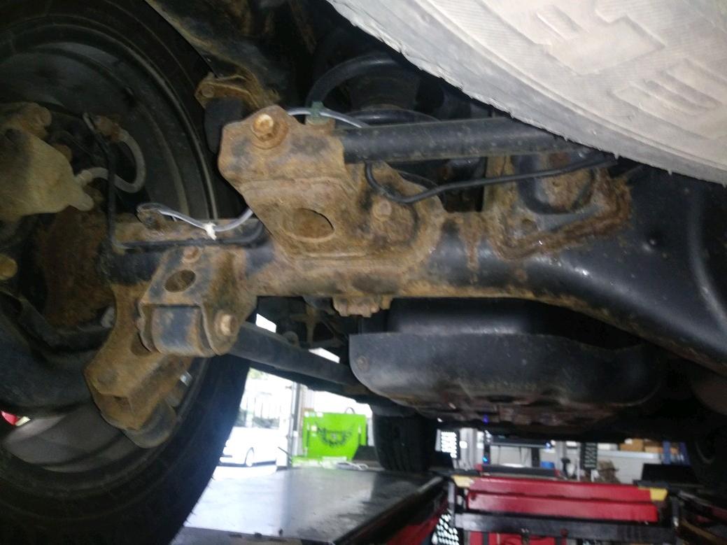

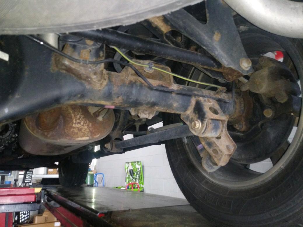

Not to hi jack this thread but what did you decide about the rust?

As for your rust... is it surface like can you scrap it off and see bare metal or can you put a screw driver through it?
