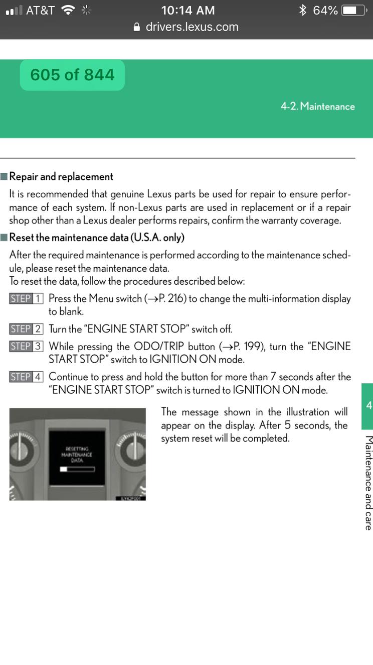

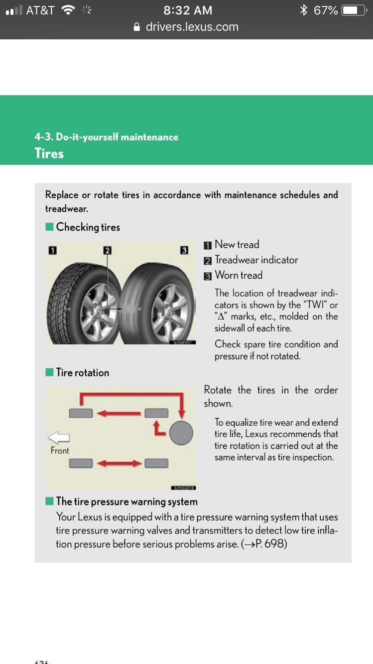

Also I’m attaching the recommended tire rotation as I had no idea what that looked. It’s interesting bc Jeeps recommend something different.
Second pic is how to reset the maintenance “data” reminder.
