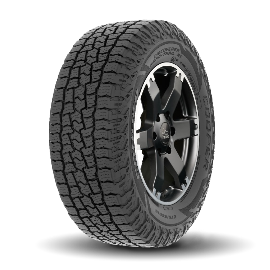

I ended up ordering these in 265/70R17, hopefully mounted tomorrow.
