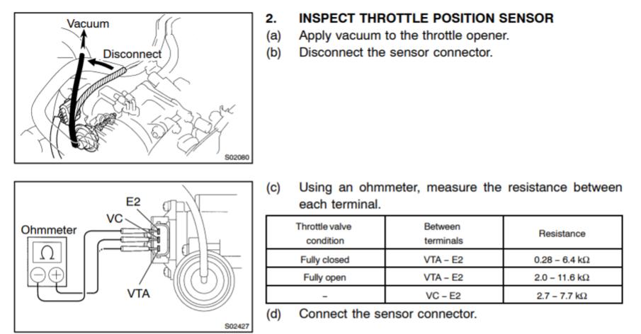

Well, if it were me, I'd dig out my FSM and DMM and test the TPS the old fashioned way rather than polling the internet about whether Torque works. But that's me:
I didn't think asking anyone else who uses torque a question to compare numbers was be a bad thing.
I also dont have an FSM, so thanks for the pic. ill do that check tonight

Threw my multimeter on the TPS and the first 2 checked out fine but the 3rd one (VC-E2) was not in spec. Threw on another TPS and all seems well. And yes, even on torque, the TPS signal is reading pretty much how it was before. At idle % is now 7.5 and WOT is 70 so, thanks guys.
