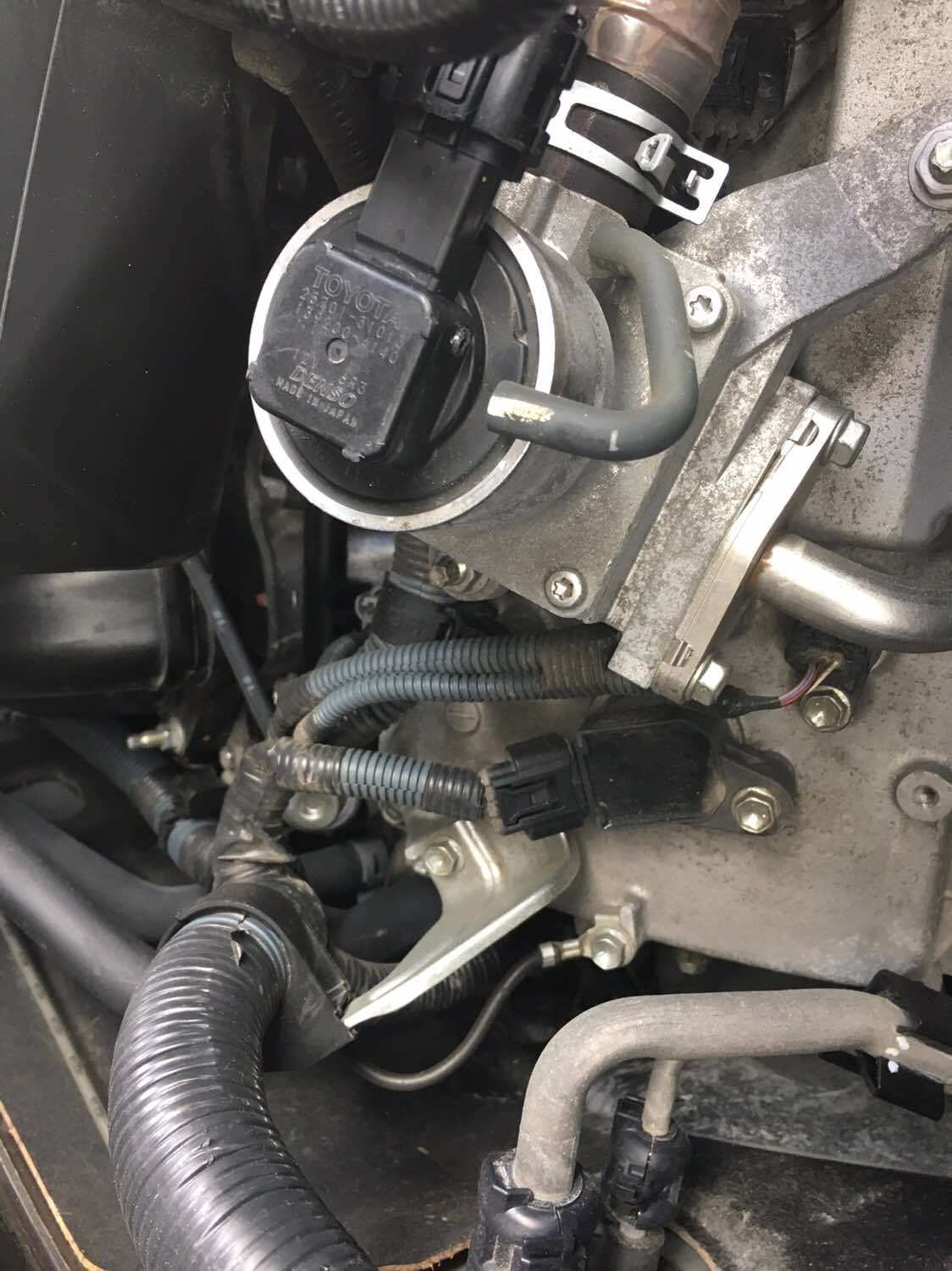

TerraCrawler New member Jul 11, 2017 #1 I need to replace my air check valance and was wondering if anyone knew the torque spec of the bolts holding it to the exhaust manifold? Sent from my iPhone using Tapatalk Attachments IMG_3067.JPG 131.9 KB · Views: 856

F fbksurferjoe New member Jul 11, 2017 #2 I broke mine in the same spot, I have a 1 dollar fix if you are interested Sent from my SM-G950U using Tapatalk
F fbksurferjoe New member Jul 11, 2017 #3 http://www.gravesrc.com/dubro-bolt-on-pressure-fitting.html Sent from my SM-G950U using Tapatalk
F fbksurferjoe New member Jul 11, 2017 #4 Purchase them at any rc store drill out and thread it in. No more check engine light Sent from my SM-G950U using Tapatalk
TerraCrawler New member Jul 11, 2017 #5 fbksurferjoe said: Purchase them at any rc store drill out and thread it in. No more check engine light Sent from my SM-G950U using Tapatalk Click to expand... That would have been the way to go......I bought a new valve, was like $280. I just finished installing it. BTW the torque of the 3 bolts that hold down the valve are 21Nm and the torque of the 2 exhaust manifold bolts is 10Nm
