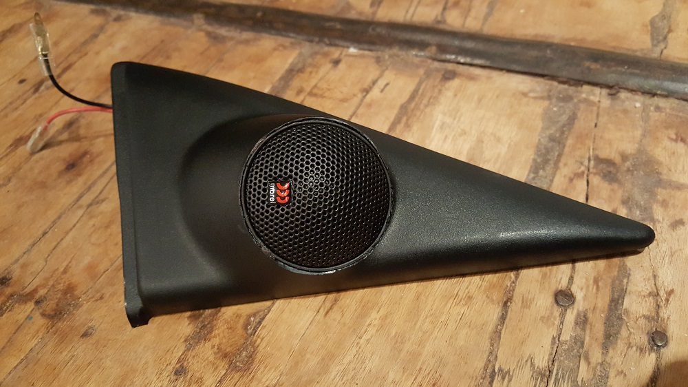

Mini update... for too long I have no tweeter pod cover, as I wanted a "spare set" to mutilate leaving a pristine factory set.
I can't seem to find any in the UK, so I figured I'd just go ahead and cut up the ones I have, to allow them to accommodate my Morel tweeters.
First stage was to trim down the Morel "surface mounts" so they were open backed. I then carefully trimmed out the factory plastic mesh to the tweeter surface mounts fit in snugly. These tweeters have no bezel whatsoever, so unfortunately there is no way I can really do this without having to sue filler and paint the lot. :( I know its a "visible mod" but I like things to look like "proper factory fitted" where possible, especially on the interior.
I fitted the tweeter rings, and help them in place with masking tape on the front, and mixed up some fibreglass resin and pouted a small amount around the back and allowed it to harden, fusing the parts together and making a solid seal.
It's not the prettiest finish behind but the resin will also add mass. The factory tweeters are bolted to the door, instead of set in the plastic trim, so making it a little heavier and stiffer will help. I then used fibreglass matting in small strips all around the rear side, and added more resin, (no pics yet I was "in the zone" doing it lol).
I thought I'd have a quick check to make sure that the tweeters still fit (and to give myself a sneak preview) They do.
Knowing that the filled area would be smooth and not match the textured plastic surface of the plastic I then set about both pods with 800 grit wet sanding paper to smooth them off, cleaned and degreased them and coated them with three coats of plastic primer, once that had dried I gave them 3 coats of high build filler primer which is currently curing for 24+ hours before I set about it with more fine wet sanding paper prior to final painting.
I'm still undecided what to use as finishing paint. I really want it to look exactly like factory, but think that surface texture will be hard to replicate. I'll probably just use satin black plasticote for now and see how it looks, and refinish with a specific plastic "texture" paint when I find one that I trust.
Silly little job, but all these things still require time and care.. It's not perfect either, but it will look a lot better than nothing! (something I'd got so used to I'd gone blind to it)

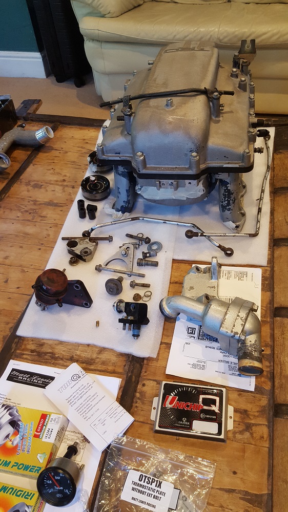

Which is handy as the FedEx man (eventually) arrived today with this...
Thanks to one of the guys on the 4GM Facebook page who knew I was looking for one (Are you on there Nathan?) who found this on Ebay for me. It's a TRD supercharger off a 4.7 2UZ.

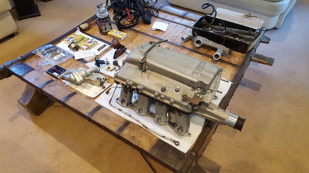

It comes with nearly everything I need top hook it up, including the 9th injector, extra pulleys and brackets, and a Unichip to help with the management side of things.
It looks like it has been painted blue, (with red pulleys and bypass actuator) then stripped. I imagine it'll end up Red and black ;)
Unichip and P&P loom (for a Tundra lol) I've not checked the plugs and pins yet... I imagine I'll need to hard wire it in (I don't think I have room for the P&P kit!)
I also picked up some fuel rails from a Landcruiser Amazon (Petrol ones are rare here in the UK, and I have found one being broken.... just after ordering the oil filter housing from the US lol (still not arrived) I might ask if they want to sell me the sump...
The circuit board is a Bluetooth serial port. Yup... I want to be able to map my gearbox shift points by Bluetooth! :reddance:
It's not all great news... It had a long way to come from Hawaii.. unfortunately, even though it was very well packaged, the Bypass actuator mounts have taken a pounding (hopefully straightenable) and worryingly the Pulley has a slight dent that I didn't see in the Ebay listing, so it must have happened on the way. The belt still fits without touching, and turning it everything sounds smooth and even, and carefully looking at the pulley there is no lateral movement at all to suggest that the shaft is bent. There is zero noticeable play in the snout! so hopefully that will be ok... I am known for being a bit fussy though.. so It's going to bug me. (Maybe I'll ask the 3th gen V8 guys if anyone has one that has upgraded to a smaller pulley?).
I also have a Fresh TRD Thermostat (71 degree.. still on the way from the US) and Denso IK22 Iridium cooler plugs ready to fit as recommended by TRD/Unichip.
I now need to decide if I want to run the 9th injector and get that mapped, or not bother and uprate the other 8. I have heard that with a modest upgrade (say 315cc, I'm 250ish now) the Factory management will cope at everything but full throttle in closed loop mode, then (safely) over fuel slightly at WOT, which will in turn be dialled out by the Uni chip as part of a complete map... Alternatively I can use the 9th Injector, so "off boost" the ECU map will pretty much run as factory, and kick in that when needed...
The other issue I have is SPACE!

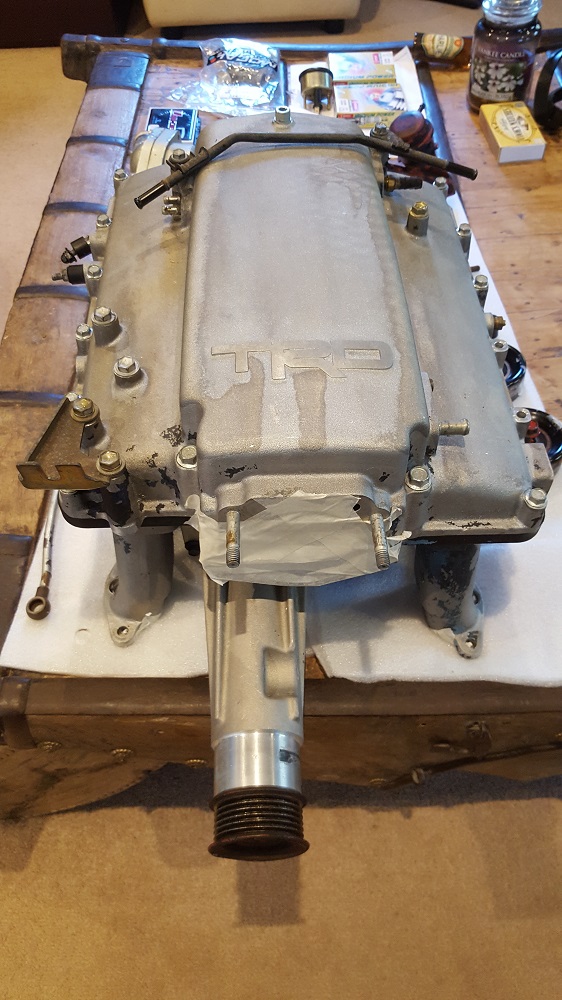

I specifically wanted this supercharger kit, as I know I had no hope of fitting anything else. I needed to retain the front intake as My intake tract is set up to go to the wrong side (because twin batteries and right hand drive) and this setup is pretty clever in how it runs the charger "upside down" in the V, to keep it as compact as possible.
That doesn't totally cover it though, as it IS taller than the factory intake, and I do have my "ram air" scoop feeding the airbox which hands down.
I measured the factory inlet to the top (not including the air feed) from the TOP of the bottom Flange, The supercharger in the same way, then the Supercharger from its highest point (annoying bolt near the back.. grr) and the clearance at the lowest point from my intake.

So starts the next phase... with more bits of LandCruiser, and a bit of Tundra from Hawaii!
The question is... Shall I do it "crinkle red" like the existing inlet manifold... or gloss enamel red?

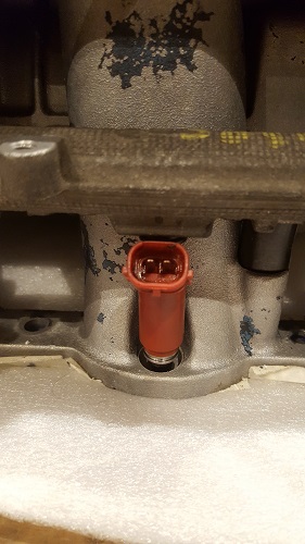

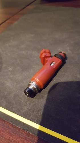

I've been scratching my head about management... as I'm running 10.5:1 compression ratio.. It might be asking a bit much of the piggyback to keep a firm hold on ignition advance at boost, to stop it knocking (and spitting rods). The *UZ forced induction lot are recommending I go full standalone... not something I've wanted to do as I like the all weather rock solid driveability of the factory management... not to mention the issue that the 1UZ - VVTi is a flyby wire throttle...and FBW control is something that standalones try to shy away from (I'd imagine because of legal implications if it goes wrong!). a couple cover it, but its very spendy. (Haltec, etc). the obvious choice is to switch to a full cable throttle.. but then I lose my idle control, as the engine I use manages idle control through the FBW throttle.. and adding an external idle control valve is messy.. and I hate messy.
Either way, I needed new injectors... the 1UZ - VVTi ones were pretty fancy "Air Assisted" injectors.. - they had their own air feed plumbed into the inlet manifold that allowed them to sucked air in using a venturi effect for more efficient carburation (Atomization). Result: better fuel mix, less lost on the intake walls, and in theory better economy.
The 2UZ didn't have this ( at least the Pre VVTi didn't) so it was a feature lost with the super charger.. so I had to go to regular style injectors.
After lots of research on sizes, I realised that my old pink "Air Assist" once were 250CC, as were the Tundra dark blue ones. Further research gave me the hunch that RX-8 injectors might fit.. so I ordered a used one, and it does. The rest are now ordered!
These have a 12 hole spray pattern, as opposed to the previous 4.. no clever air assist but the nozzle is meant to be a lot more efficient than previous designs, if I run them at the factory fuel pressure (call it 43 psi) they are rated at about 350CC... But the RX-8 runs them at 56.5 psi, and rates them at 495CC (source, various Mazda forums and supplier websites). At the higher pressure they'll atomise better too... In reality 350cc will be plenty.
