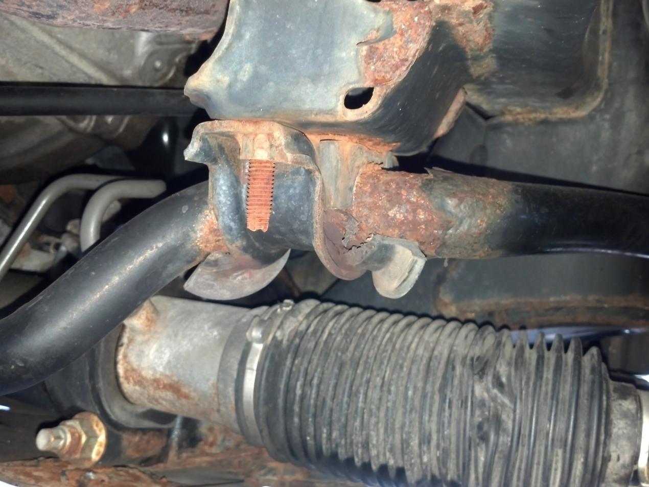

Motor mounts look good.... Transmission mounts look good... Do not believe there is an upper control arm for the back wheels... just an axle??? not sure to what you are referring?????? steering rack bushings seem fine... got a pic of stabilizer bar bushing that looks toast? I find it hard to believe this could be the problem of so much torque? feels like something is BROKEN it's torquing so much.... but maybe it is just this????

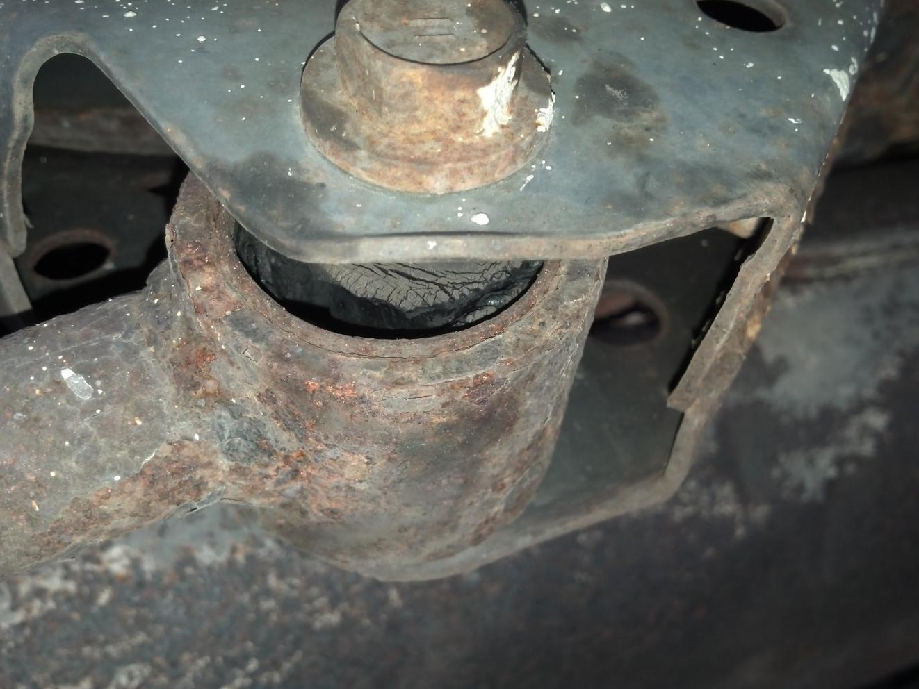

welp, y'all are right... I finally found it! had to look hard to see inside the control arm pivot points at the bushings but yep, one definitely looks SHOT! Thank you so much for insisting to keep looking at suspension stuff in the rear... the aha moment finally happened... :bravo:
