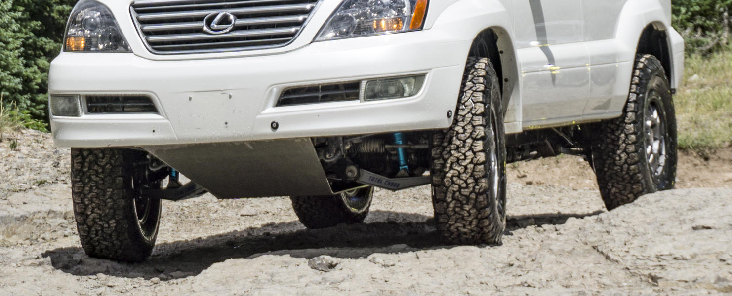

Awesome! If you can keep the factory lines of the OEM bumper but keep the protection, that's a win win. Is this something that, if someone was interested, could be built out and shipped to bolt on or is it something that is welded and built on the GX?
Nice GX, I'm in for this build thread. Build information would be great since I have no experience in off-roading and I just acquired my first GX about week ago....

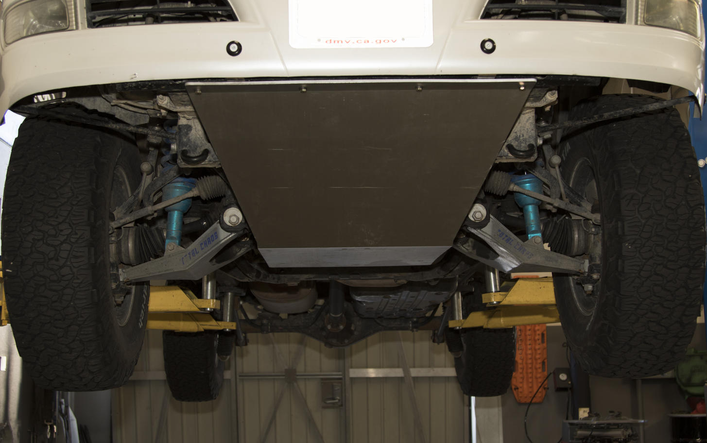

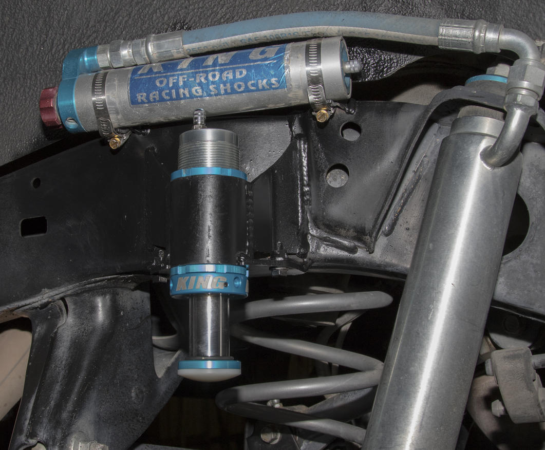

Unfortunately the GX has been out of the shop and will be until after the Rebelle Rally. We did make a custom skid plate and trimmed up the bumper a little. We added supports to keep the bumper from flexing. It isn't quite as detailed as you might think :)
Here is a close-up. You can kinda of see the support sticking out from the inner tie rod area.

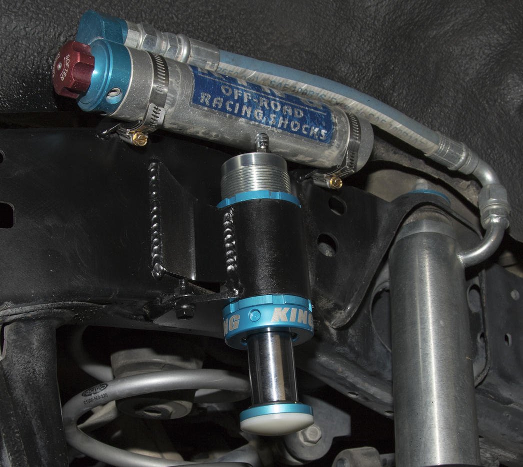

More photos :)
