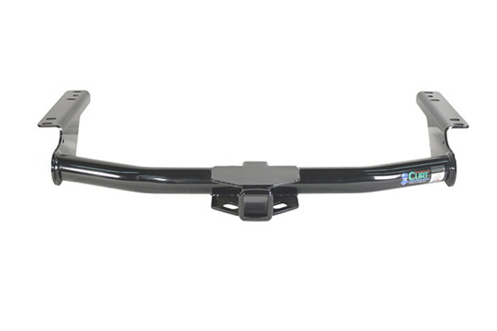

Ok I need to set something straight here. When I think of WDH I think of the gadget that attaches to your already installed aftermarket frame mounted receiver which extends outwards towards the trailer and comes with 2 bars and chains for sway control.
For some reason people keep calling just the aftermarket frame mounted receiver a WDH. I think they mean it distributes the weight to the frame instead of just the cross member but its not a hitch and it's certainly not a WDH, it's a receiver. Sorry not directing that to you it just reminds me of that inconsistency.
I was thinking something very similar, I have the stock V6 hitch and using it to pull a boat very near the capacity of the 4Runner. I really feel the load, especially in turns how it pushes the back of the SUV and was considering upgrading to a frame hitch. Is it worth it even though my tongue weight isn't substantial? (more dead weight rather tongue weight)
i totally get what you're saying
attached: an example of a weight distribution system, followed by a hitch receiver

It would be a tad safer as it transfers the weight to the frame rails versus just the crossmember. I am not confident that you would notice a huge difference but the truck would appreciate it.
