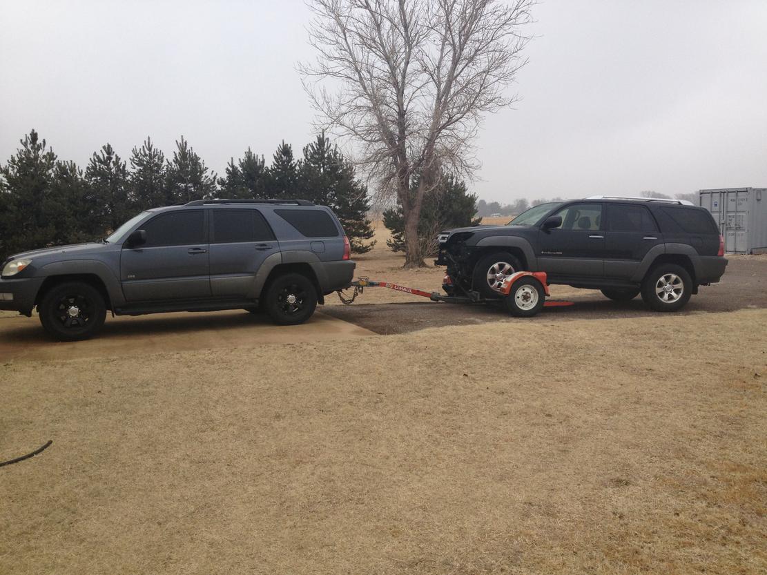

Here is my SR5 with my project Sport #3. pulled it 150 miles no problem.
