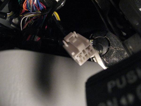

mine had the tow package but no frame mounted hitch, still had the wiring in the glovebox when i got it. it plugs in somewhere under the dash, i can't remember exactly, it was the very first mod i ever did about 4 years ago lol. someone probably knows more than i do, but its possible to get a plug and play unit from etrailer
You should see the plug for your controller. My 2007 came with the factory tow package. The plug for your controller sits just above the driver kick panel.
Martin - mine did not have the tow package either, but the plug was under the dash. Staceman posted the pic of the plug. I used the Protegy P3 controller and the plug in harness. Bought from Amazon for cheap. The P3 worked awesome! I just received my Protegy RF (wireless) that I am using in my new Touareg.
You know what, I think I DO Have that! I remember seeing a connector down there and not knowing what it was for.
So I just buy the controller and plug it in? Do I need to set it or calibrate it or anything?
Buy the P3 controller ($130-ish) and the connection harness ~$17 and you are all set. When you first tow you can set the gain. Pretty simple.
