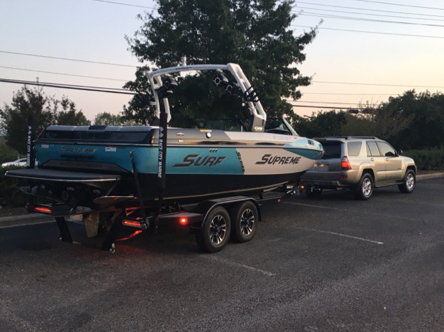

V8 does fine towing this boat 6 or 7k lbs. At the end of the summer I found out the Trailer brakes had not been working at all during the summer. I thought the pedal felt a little stuff but wasn’t alarming enough for me to do something about it or think something was wrong. I have airbags in the rear but no weight distribution hitch.
So I think you’ll be fine either way but I’d use it as an excuse to upgrade to the 8 cyl.

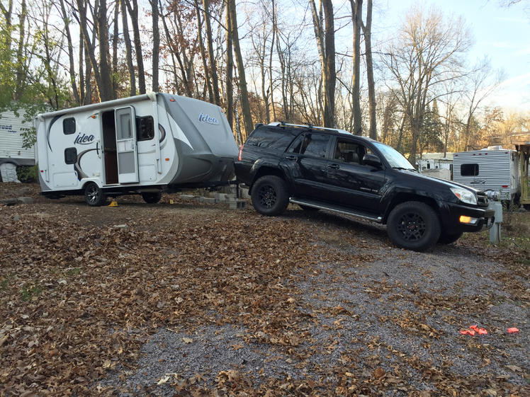

V6 - FJ rear springs with airbags, Bilstein 5100's on all 4... Crucial component is the airbags w/ stiffer springs. Also 100% without a doubt purchase and install an EBC.
I have been saved from accident almost every time I've been out because of the EBC. I recommend one that you can manually squeeze to control the brake in an emergency.
I pull from IL to the Smokies in Tn at least 1 to 2x a year. 3k+ loads...
