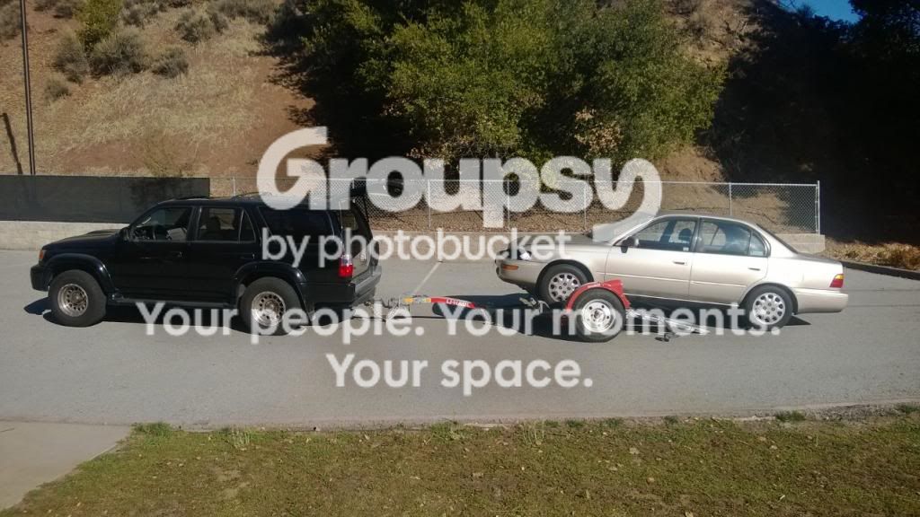

I've pulled a car with both a dolly:
WP_20131222_005_zps8ec68804.jpg~original
And a flatbed:
20141111_105417_Android_zps3d25cc75.jpg~original
Neither car being quite as heavy as a 4runner, I can still recommend the flatbed over the dolly. It feels easier to control plus, has its own brakes. Both were pulled pre-transmission cooler, with care and attention to the fluid temperatures. The Jetta was pulled 110 miles both way with zero issues, and made 11mpg which is not horrible I think.
A 3rd gen probably has 1000 lbs over a Jetta. I have pulled lots of cars on a dolly, once from SL to NM with no problems. I had all my upgrades then. I never wanted to tow with the flatbed because according to Uhaul, the trailer weighs 1800 lbs empty plus 3,xxx of a car. Puts you right at the limit of 5,500 lbs.
