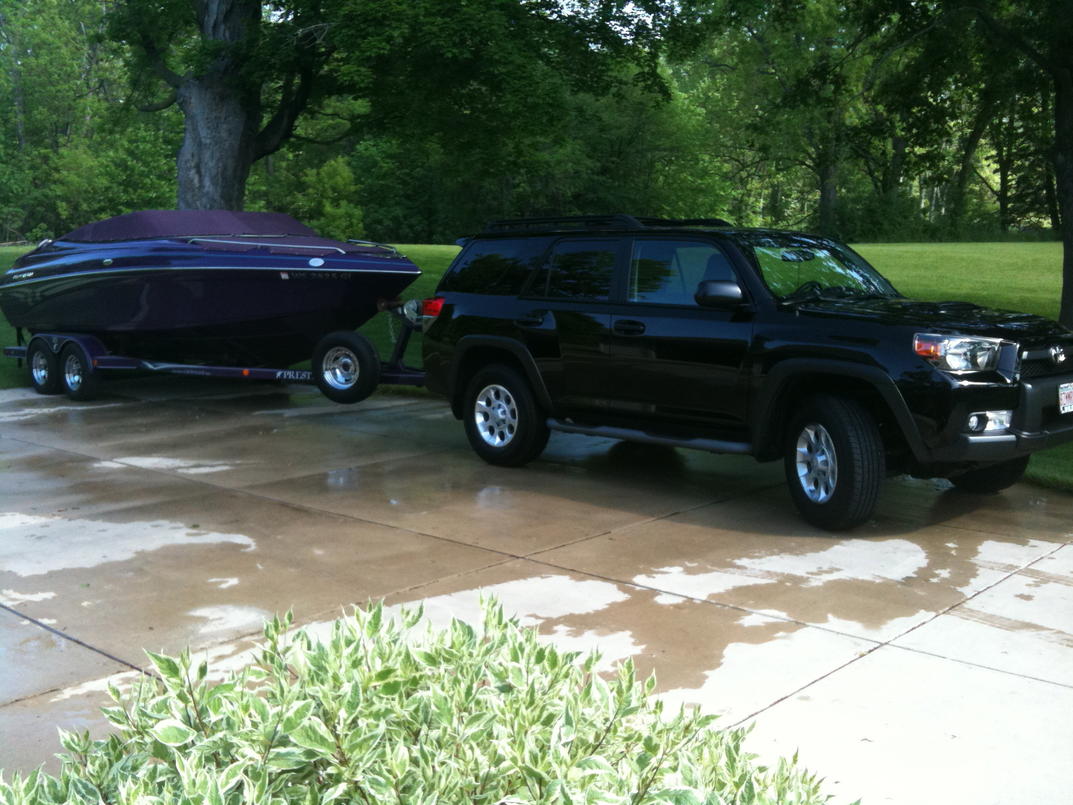

I have towed our 22.5' Crownline boat (around 4000lb) with gas, trailer, and loaded with stuff. The 4runner did just fine although not as great of acceleration off the line as my 2006 V8 but once going just fine. Braking was adequate and as others mentioned, if hills are involved, its best to keep it out of 5th gear. All in all, I was satisfied with it and it probably towed as well as my 2003 4runner with the non-VVti V8.
