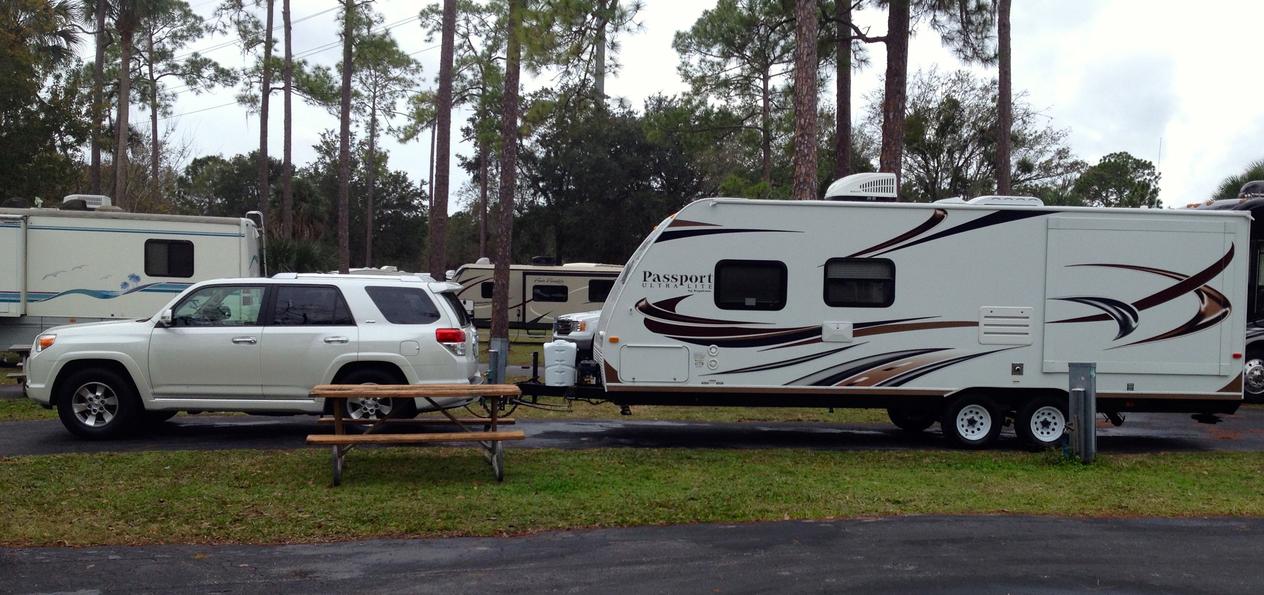

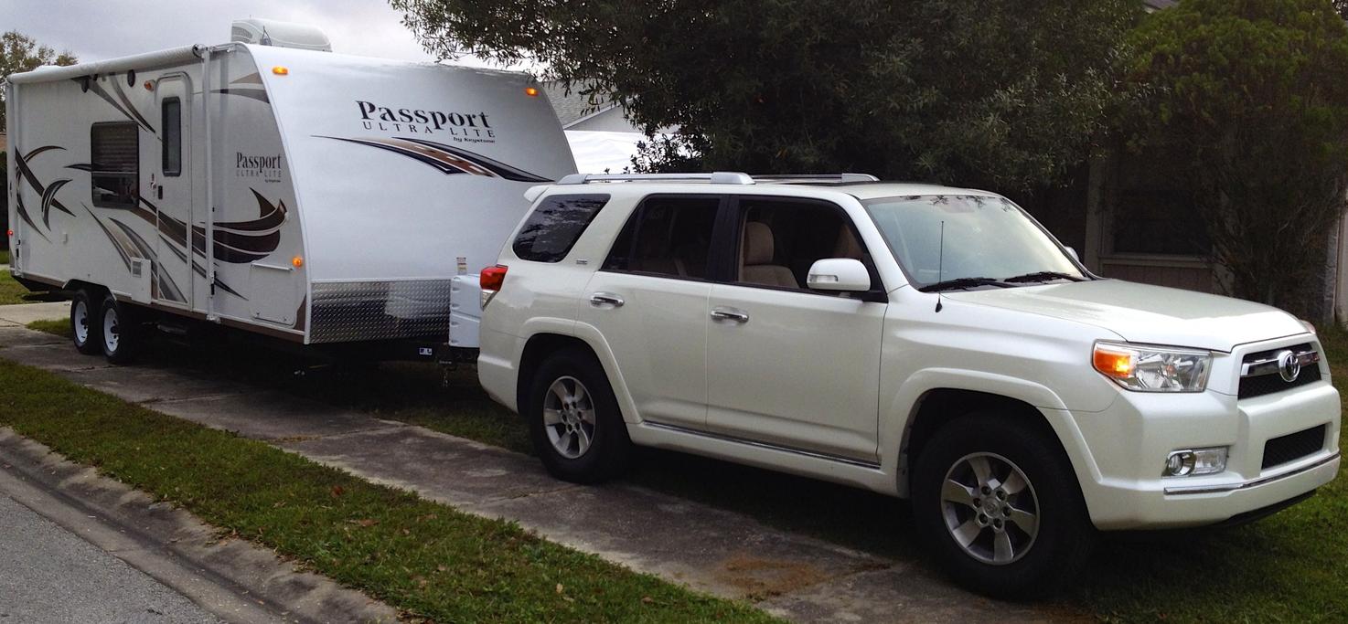

I've been towing my 2014 Keystone Passport Express 252BH (4200lbs dry) on the back of my 2011 4Runner 2WD SR5 all over FLA for the past couple of months with a Blue Ox and a P3 break controller. It does GREAT! Wind, hard rain, horrible Tampa and Orlando traffic, hills (for FLA anyhow), 6" of water… doesn't seem to matter. I did have to adjust the weight inside the trailer (after I put the 2nd battery on) a time or two so that my tongue isn't over loaded but it seems like pushing heavy stuff (like our clothes) to the far back until we get where we're going does the trick. I mostly leave it on cruise control about 70 or 72 MPH and it stays in 5th with the eco light on as long as it's flat. I've learned to run the throttle myself if there's hills because I can "see" them coming where the cruise can only "sense" the speed loss and by then it's too late and it wants to jump to 3rd to make up the lost speed. 70 - 75 MPH seems a little "fast" compared to the 26' class C on the Ford E350 frame I used to run (at 60MPH MAX) but I've decide that I like running fast enough so that I'm not getting "pushed" when the semi trucks pass. They still pass but the speed difference when I'm running 70 is smaller so their effect on me seems minimal in comparison to when I'm going slower. All in all so far I LOVE my 4Runner and I feel like it's much more capable on the road than my e350 was when towing a car behind it.
BTW, if any of you are having bad luck with keeping your battery charged while the trailer is in storage I've found pulling out the fuse for the LP / propane detector does the trick (my old camper had a switch to turn it off and I'm thinking of adding that). I added a 5W solar panel to the A in front of the propane tank and it's parked facing south… my battery is staying at 13V with no problems. With the LP / Propane detector plugged in the solar panel can't keep up with the load and the battery dies. You just have to remember to plug the fuse back in before you use the trailer. :)

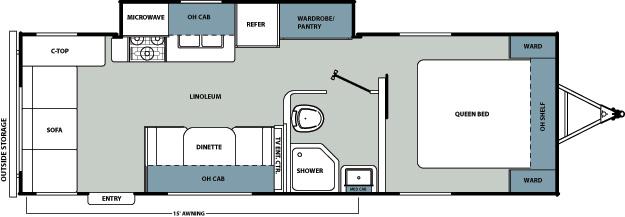

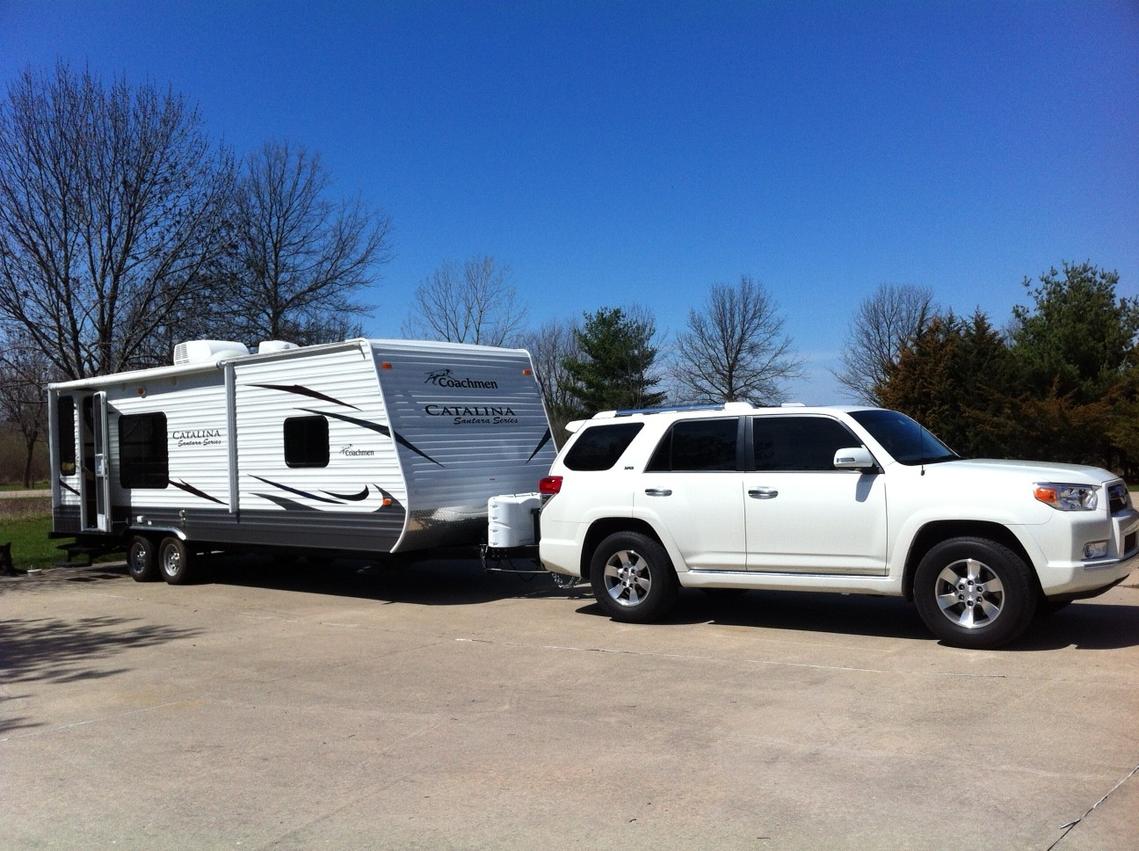

That things looks huge! 262RLS?
Yes - 2012 262RLS >4800 lbs. new (we travel without water) pulled with a 2012 SR5.
Living in the Midwest we have hauled it over some narrow winding roads.

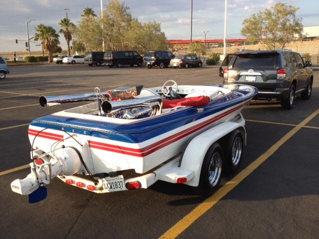

Took this pic in 2012 literally 1 week after getting my SR5 My 19' jet boat is pretty light, but once the tanks are full of gas and all our gear is inside both the boat and truck, the extra weight is noticeable. I've towed the boat about 50 times since then (8 times thru the Mojave desert in the summer) and my T4R has never let me down. I've also towed my 1961 Morris Minor truck, 1986 Corvette, 1970 el camino and a 1966 Mustang. Hopefully pretty soon I'll be bringing home a Delorean from Reno using my 4Runner.
