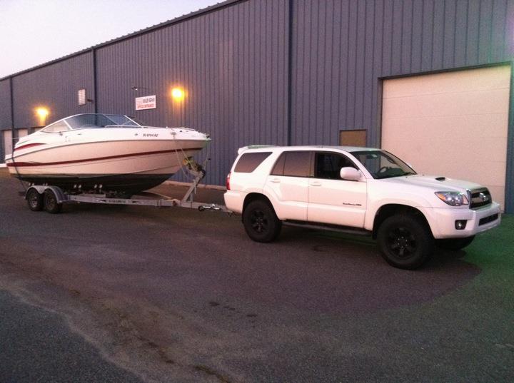

Just go with the Firestone Air Bags. Extremely easy install of about 45 mins to an hours and cost about $70. here is a pic of my 4runner with about 6300lbs of boat, trailer and fuel behind it. I get a 1" sag with only a few lbs of air in the bags. (dont mind the slick roof, i was working on my roof rack lol)
A TV (tow vehicle) and trailer leveled with air bags on the TV will appear almost the same as the same rig leveled with a WDH, but it's just not the same animal, as quite a few folks have found out the hard way. In the case of gusty winds, or a rapid or evasive maneuver, they will handle completely differently. Using a WDH to level your rig distributes most of that weight that was sagging the rear of your TV, to the front axles of the TV, and somewhat less to the axle(s) of the trailer. This results in far superior and safer handling under duress. Adding sway control further improves safety and handling.
When you accomplish the same leveling with air bags, though not noticeable now, that weight is still on the rear axle of the TV, and is therefore still making the front of the TV somewhat lighter in comparison to the rear of the TV, which negatively affects handling.
Therefore, if you just need to level a vehicle with a load on it, air bags are a great way to go. If you are trying to level a TV + trailer, use a WDH. You and your passengers will be much safer, and so will everyone else on the road you encounter.
