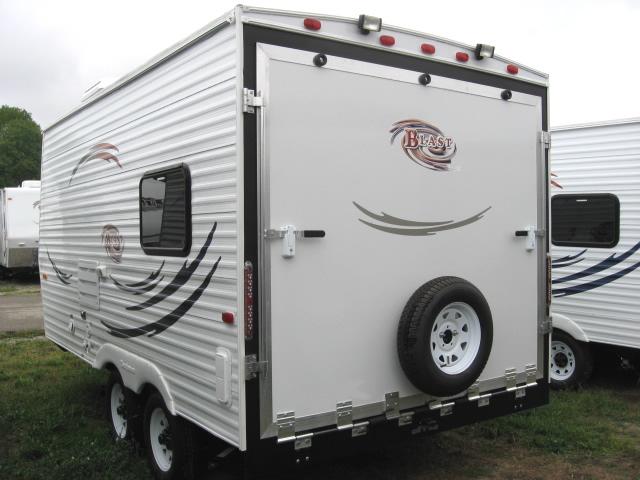

What hauler weighs 3400 lbs, and that's not including the bike? That sounds sick. Photo?
I was told the factory towing package included, beefed up transmission - which I presume includes the cooling package. I know this is on there because when I changed the fluid I had to specify the heavy duty transmission filter because the std didn't fit. Also, it is supposed to include better cooling system and something else - suspension, brakes?
The Coachman Blast 150 weighs only 3400, Sweet! I've been waiting for this cos I wasn't going traveling without my bike. Here's a link to check it out
