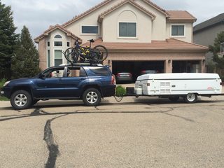

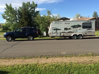

This is How I sit with a 5000 lb travel trailer, a WDH, and Toytec 2.0 RCC HD Springs with OME struts (Full OME 885 in front).
This is how I sat with 3000 lbs and Airlift 1000 air bags.

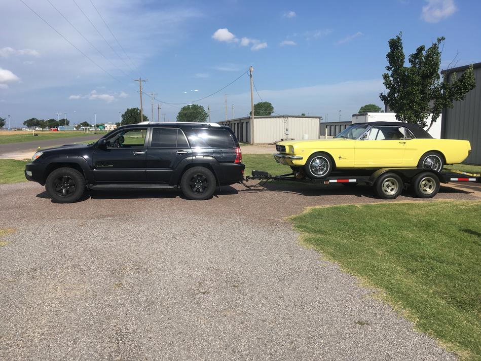

This is a stock V8 with my 64 1/2 Mustang. Notice the trailer is center axle and the T4R is slightly lower in the back. I should have moved the mustang back about 6 inches.
