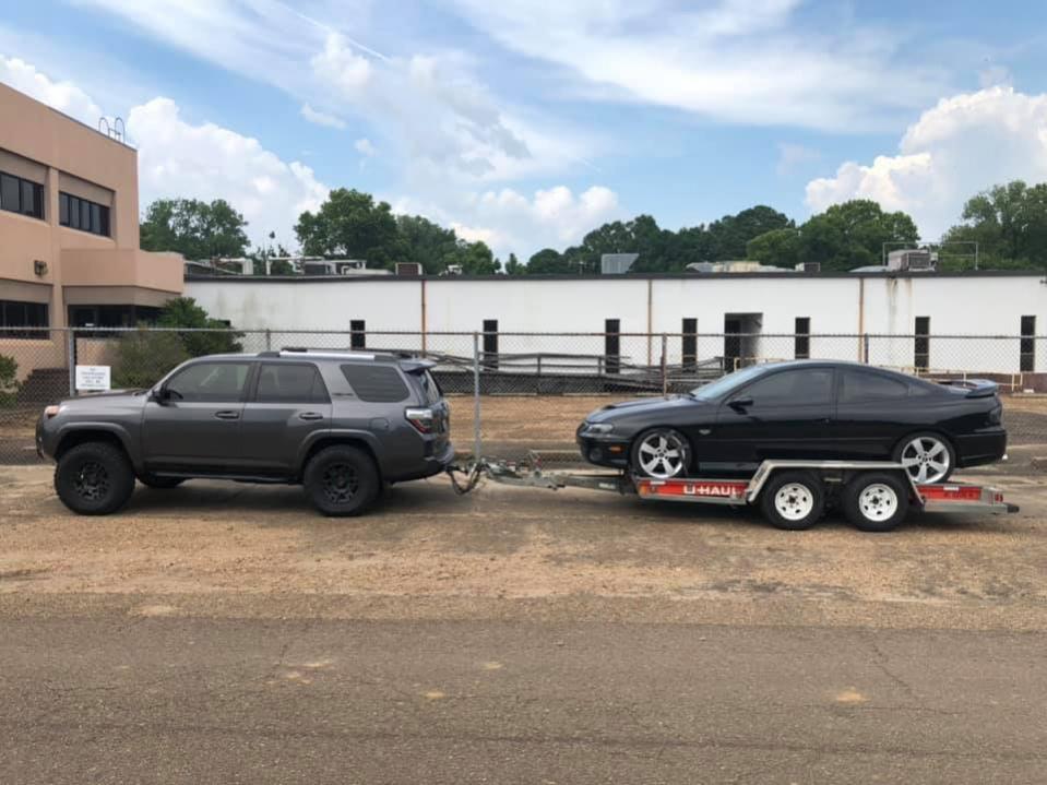

Saw this on one of the FB pages...I have the same car. 3725lb car on a 2200lb U haul trailer puts it at almost 6K. Uhaul gives it the ok on their site. I'm sure it wasn't fun towing.
