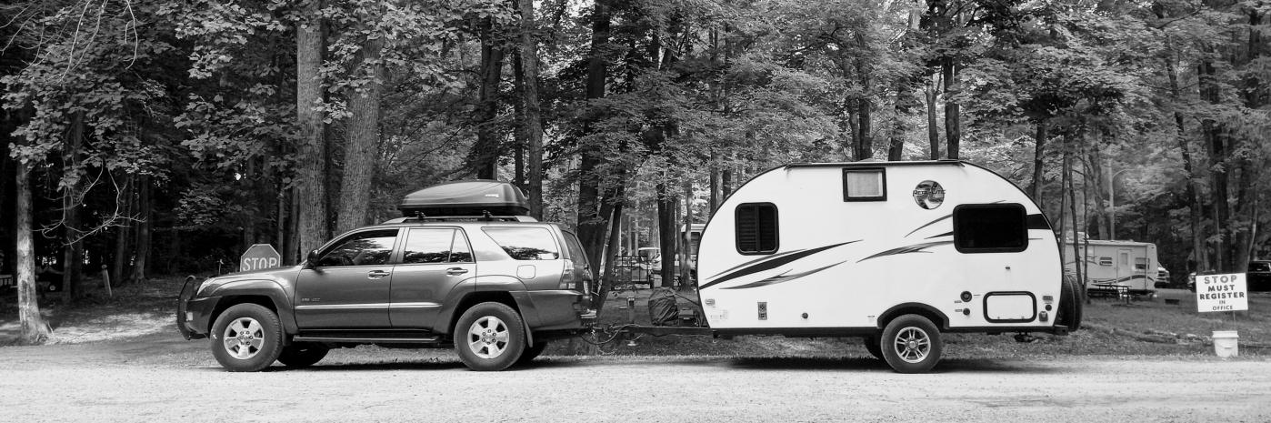

I tow with my V6 2WD just fine.
I'm not sure exactly what this home-built trailer weight, but being all heavy steel I'm sure it's at least 2,000lb, and the Corolla on top of it is another 2,200. Add in an interior packed full of tools, spare parts, and camping supplies and you have a VERY loaded-down vehicle. However the V6 handles it just fine. I leave it in 4th and have to get a running start to go up some hills but overall it's just fine and it still gets 14mpg while hauling. All the mods I have done are to make it a better towing/camping vehicle.
Frame-mounted hitch
Trailer brake controller
Transmission cooler
AirLift rear helper airbags
Bilstein 4600 shocks
Goodridge stainless brake lines
Motul RBF600 brake fluid
PowerStop Z76 heavy-duty brake pads
Limited model "13WH" front brake conversion
CSF aluminum radiator

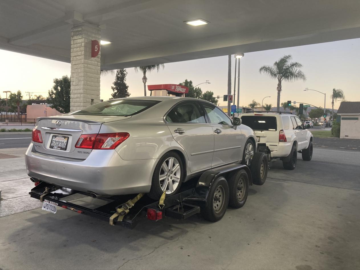

This is the most I ever towed with my truck, as we made a big move in 2020. Towed in 100 plus degree weather over 150 miles. The 3600lbs Lexus was loaded up with personal belongings as well as the truck, on top of the 1850lbs car hauler. Probably just over 10,000 in gross vehicle weight and payload. You can see the rear squat is almost none existent with the air bags!

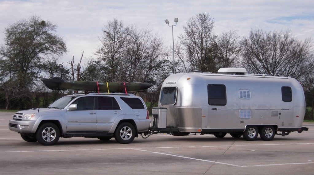

I pull a 6500 lb. Airstream and the 4Runner handles well. I still have the X-REAS shocks which are great for handling. Air bags do nothing for you in the way of support. You don't say what the size/weight of the Casista is. I use an Equalizer weight distributing, anti-sway hitch. It keeps my rig level. In the driver's kick panel there should be a connector for the brake controller (since you have the OEM frame hitch I assume you got the towing package). I use a Tekonsha Prodigy P2. Check their website if you're looking for something more current.

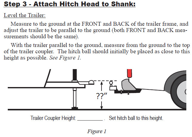

For anyone using a WDH, are you having to raise up the tongue really high to get the sway bars connected? In my case, I'm having to lift the car up pretty high when connected to the hitch ball just to wrestle them in place. The previous owner installed oversized tires (32.6" - Destination AT P65/70R18) and didn't modify the suspension. Is it possible this is part of the issue? I don't love the tires - noisy and they rub the wheel well.
Should I be changing these, or doing something else to get this to be a more tow-ready ride. I've got a break controller and the Equalizer anti sway. I believe my Xras is still working so I'm not if I'll benefit from bags - I've seen comments that with the WDH they won't help much, but I'm open to advice.
Are there any other suggestions for easy items, short of upgrading my suspension so I don't run this thing into the ground?

I pull a 23' Airstream. I get 9-11 mpg, depending on if there is a headwind or tailwind. I'm very pleased with the way it handles.
I have original size P265/65R17. I do have to raise the rear end up high to connect to the Equalizer L brackets but I can get it high enough to just slide them on. When you have everything connected, road ready, is it level or is the trailer nose up? It's important to be level. Maybe your Equalizer ball is too high off the ground???
I have the original X-REAS shocks; no leaks and control is very good. Bags do not increase your bumper or towing capacity. They will level the rig but if you use the instructions in your Equalizer owner's manual, you can level it that way.
I have not altered my suspension in any way. It's possible the tires are causing your problems. SUVs are already top heavy and you have better control when you're closer to the ground; lower center of gravity.
I'm level - I went through hours of adjusting and tweaking this to get it to where it is. My tires have 8 years/50k on them and I hate the road noise so I'm planning to change them to the smaller size, then I'll redo the setup.
What's the weight on the Airstream? Beautiful trailer.

The AS is about 6,500 lbs. when it's loaded. the unloaded tongue weight is 730. It rides very nicely, very good in the turns. Original X-REAS shocks still holding steady. I've been 4900 miles to Oregon and back, Dumfries, VA 1K miles, and down to FL, LA, MS, AR, TX; no problems.
