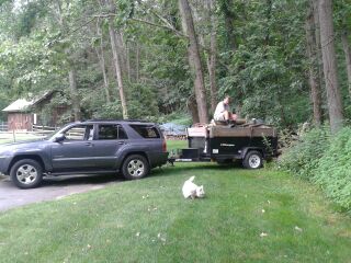

ive put more than 3,500 behind my 4runner in cut trees, fine on power, some float in the front, nothing terrible, but brakes fade like you wouldnt believe. if your trailer has brakes and you have an electronic brake controller, i wouldnt sweat it for short distances.
