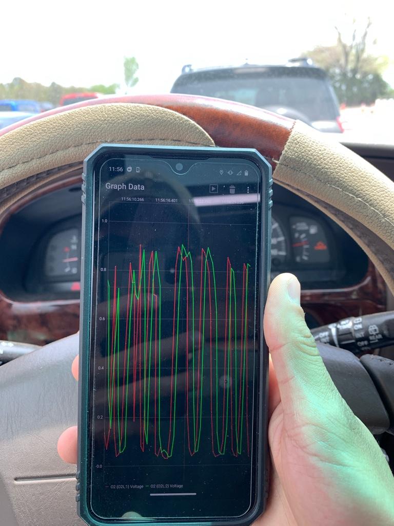

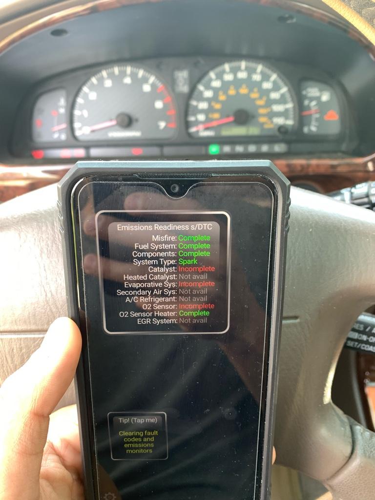

Hey everyone, another weekend another chance to work on Frank the Tank! Finally got a new OBD2 reader. Trying to figure out my P0172 code. I replaced the o2’s as I was getting a P0141 code before now am getting P0172. Any ideas?

All that pic shows is that your emissions tests are not complete. You need to perform a complete drive cycle (city/highway drive, then 8-hour rest, then city/highway) after resetting the ECU or clearing codes.
Make sure your fuel tank is half full (30-70%) for the evap test to complete.

Start by checking all the hoses for cracks, dry rot snug fit etc. It could be a simple vacuum leak. Also What are your fuel trims if they are negative 30s or so then you might have a leaky fuel injector or a FP regulator. purge valve for thé gas tank etc.

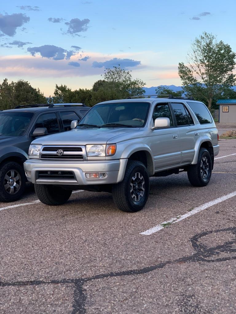

Here’s my current Frank picture. Fading paint had me considering raptor lined fender flares and maybe respraying the body. Not sure but definitely needs spacers and a 2” lift
Another update, got a cheap second hand roof rack, added some wheel spacers, now looking at lift kits. Chasing some silly maintenance items currently but hopefully will get them ironed out soon. Also thinking a summer project will be painting this old sun faded truck. Can’t decide if I want to go easy raptor liner or full blown paint matched look. Either way hope everyone is doing well!
