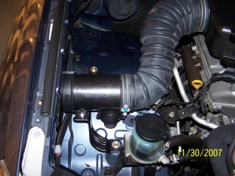

Saw this on a buddy of mine's FJ...one of those "WTF?...why didn't Toyota think of this for all of the 1GRFE engines".
This is a factory pre-cleaner box that replaces the OEM air box for the 1GRFE engines.
What it does is help remove dust by spinning the incoming air into the chamber...and that dust settles into a cup for easy removal.
I spend some time on some pretty dirty/dusty roads and get tired of vacuuming out my filter every time I get home.
(Yea, I cleaned my engine last week...and knock the dirt off it regularly.)
This is just like the cyclone gizmos some guys attach to the top of their snorkle rigs.
What it is NOT is a throttle body gizmo...it only removes dust.
Cost was $116 from my local dealer...it took two days for them to get it in. The part number is 17730-31030.

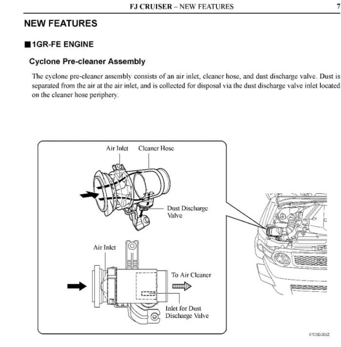

Photo from toyota manual that helps to describe this as well.

Can you take another pic directly from the top because I want to see if there is anything protruding forward (like the dust cup)? I have a second battery right where the power steering reservoir used to be and it is a tight fit. Just want to make sure I have room if I do this mod.
KMVRETER,
This thing is physically smaller than the old box and uses the same mounting holes...so I think you should be in good shape.

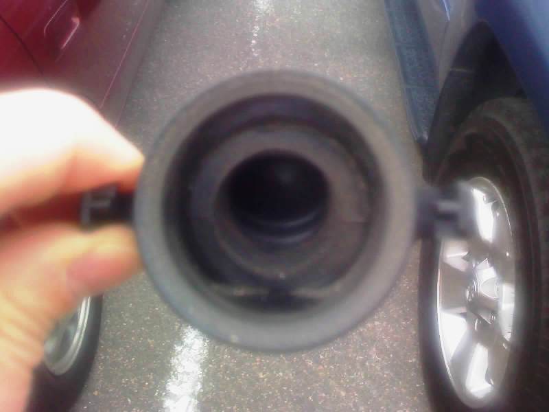

KMVRETER,
as for the amount of dirt...I haven't had to any off-road driving the past few weeks...just city driving. But even with that...there is a fair amount of crap in there already.
Not sure if you can see it well in the picture though...it's not like there's a sand storm in that cup.

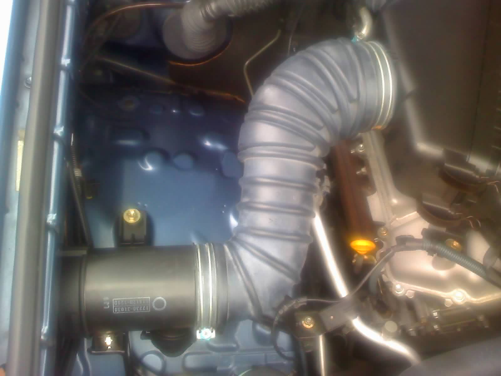

Yea, it's just a dirt catcher and so far seems to do that part well. I will take some more pictures in a few months to show what effect, if any, it has had on the filter itself.
