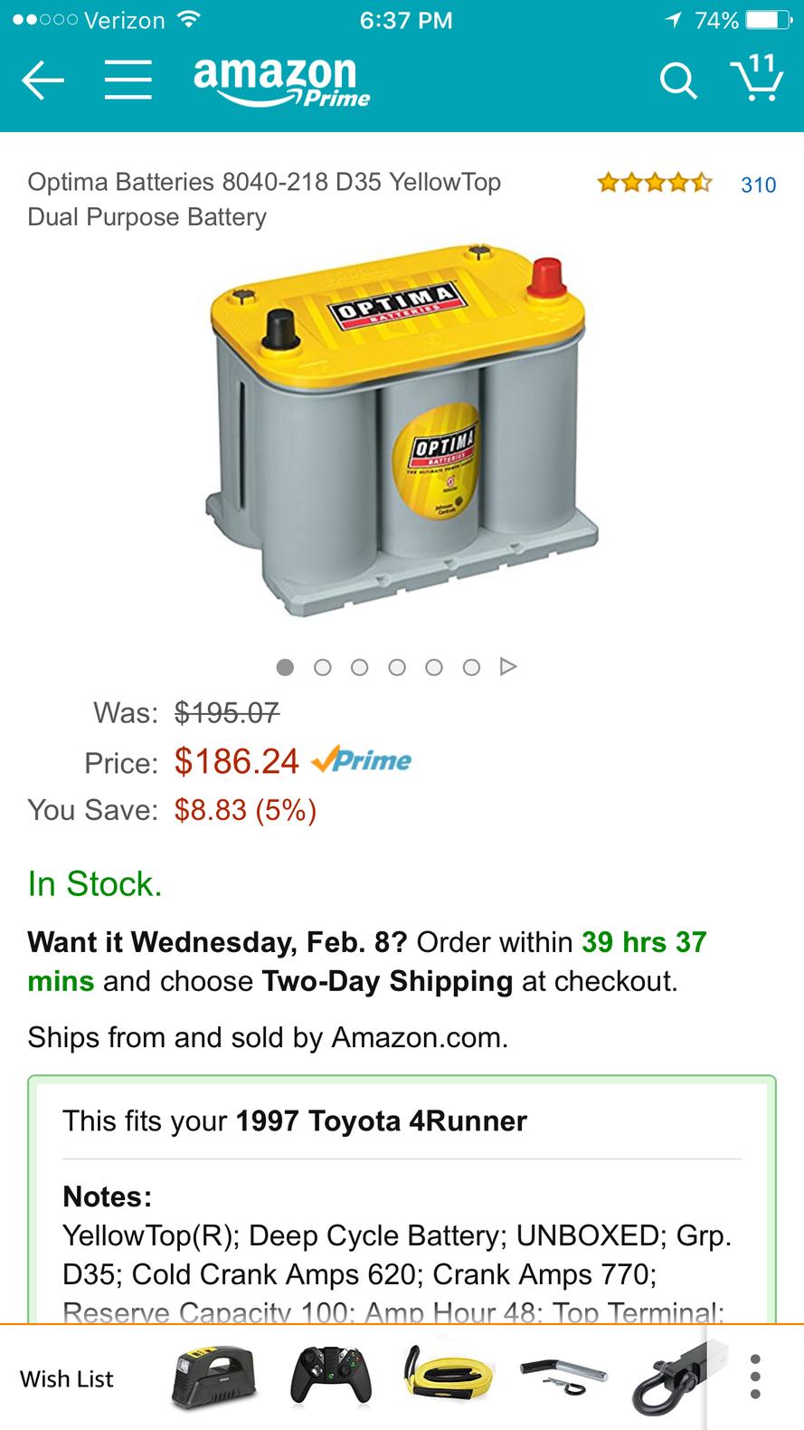

I can not figure out what we should get to upgrade battery wise. We have a 1997 4runner limited 4x4 v6. Currently we are running a 24f interstate battery from Costco but it's on its third year almost 4th. We want to upgrade, allowing us to use a portable air compressor on it and possible light bar in the future or if we need to tow. We would still like to have the same height battery (just dropped $60 on the bracket from the dealership), but be able to have a lower drainage and if we are out camping be able to leave a led light on for a while. Anyways I can't seem to chose which is the correct size for my 4runner, 24f or 35 group. What's the difference between OEM and AGM. And also what would meet all the needs we have. Optima I heard has gone down hill and lost quality control. Odyssey doesn't have that great of reviews that I have seen versus the optima. Or is there something better? Thanks! :yield:
