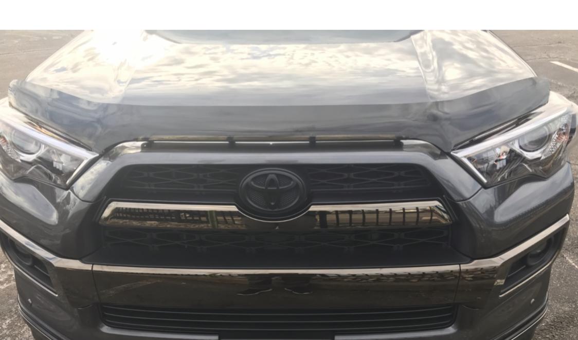

So i got and the hood protector was already installed which i didnt even want but they said they couldnt remove it so i said screw and took it.

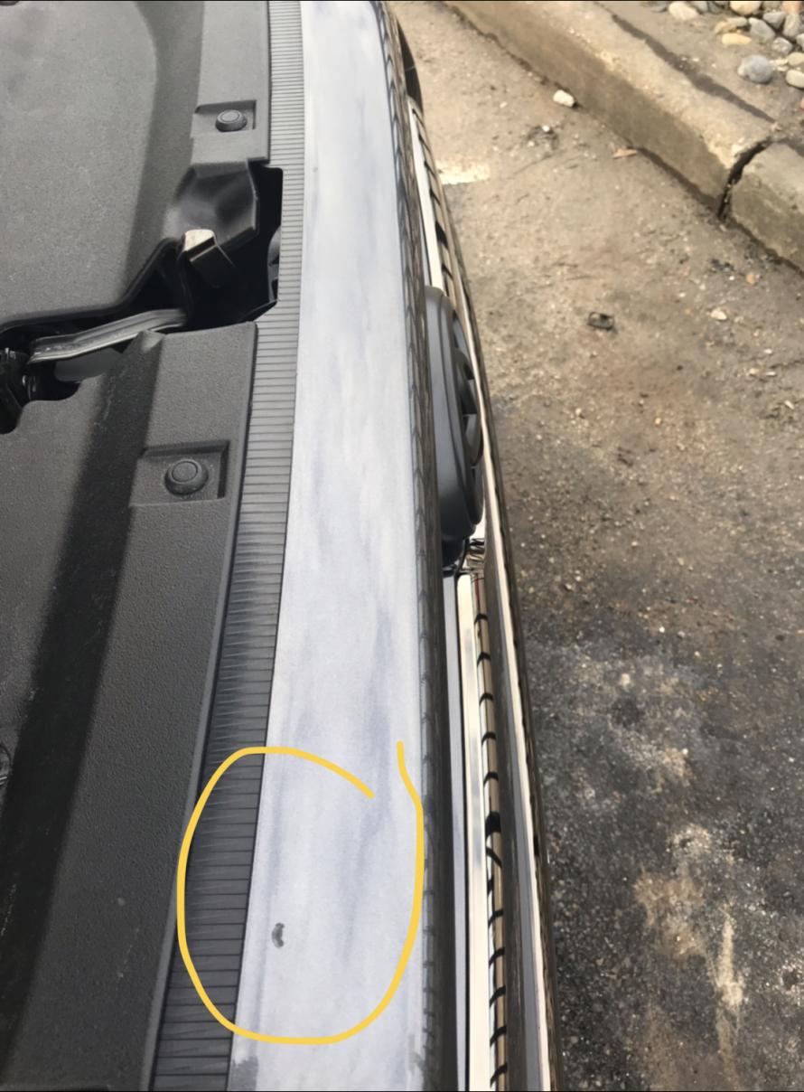

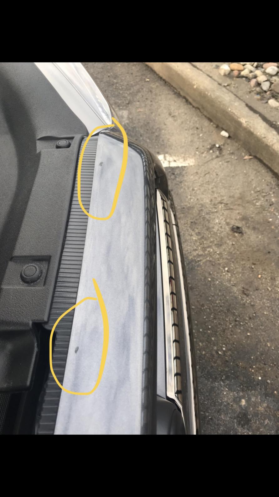

I popped the hood today and noticed the screws from it caused paint damage.
Toyota said they will replace the part but im still damn upset because any body work never lines up right and just principal.
Any ideas why this happened, improper install ?

Yep they do that, had the Weathertech one and it did something similar. Just use a bit of touch up paint, you won't see it when the hood is closed anyways.

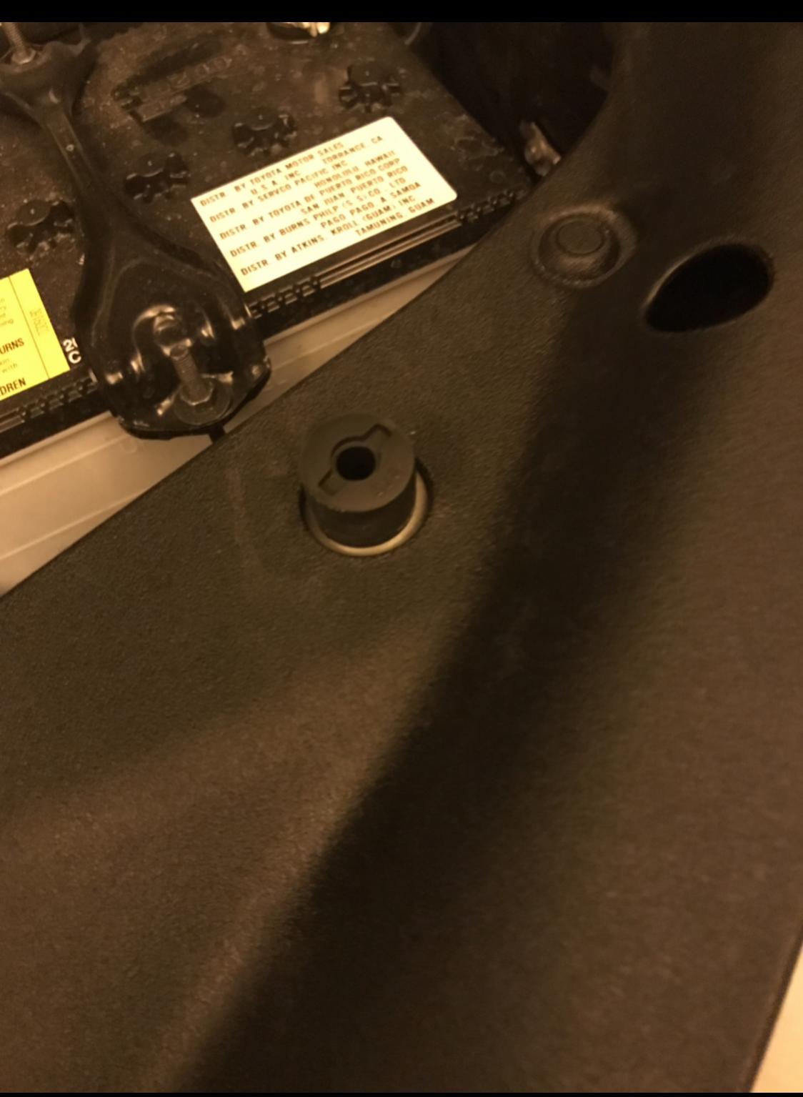

I figured out why this happened whoever installed was first a ass,
I see theres two rubber stops that are adjustable and i adjusted them to be higher and its no longer touching
Those stops are going to raise your whole hood though, so check to make sure you're not making larger gaps along the fender, since you would see that easier than chips beneath a closed hood.
