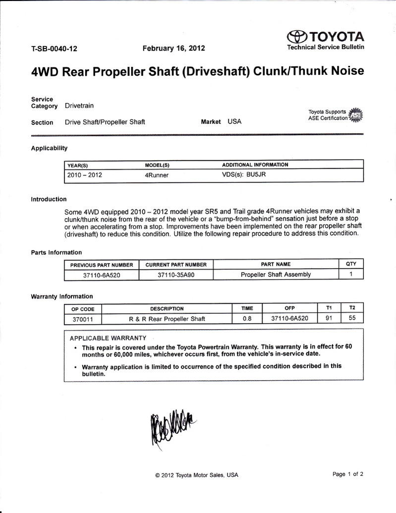

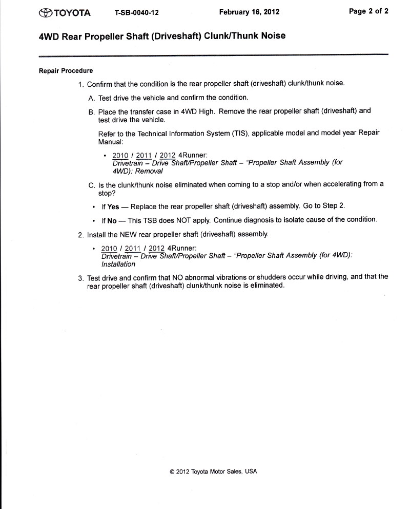

* UPDATE * Toyota issues TSB for axle wrap / driveshaft clunky-thumpy
Evidently, Toyota has recognized this as a problem and issued a TSB as Harper7 posted in another thread.
Went to my dealer today and obtained copies of the TSB and the "Repair Procedure", which you can read below.
They're replacing the rear propshaft, IF a tech confirms the condition. My appointment with a Tech is next Wednesday. I'll post results as they happen. I asked, and was told "the parts are available".
We'll see.

Mine does it at nearly every stop - the more abrupt the stop, the more pronounced the "thump". I do not hear anything, I feel it, it's exactly as described in the TSB; "feels like a bump from behind" as soon as I begin releasing the brake.
The Service Manager was very intent on knowing my mileage. I said "doesn't matter, I have the EW". He said "the EW DOES NOT cover TSBs, this is covered by the 60/60K powertrain warranty". I chose not to discuss this as I'm well below that mileage. Those pushing high mileage might consider this.

I've noticed the described symptom when making as abrupt stop, holding brakes for a bit then releasing them. Thunk!
I thought this had to do with brakes or suspension when the tension was released from the system. Guess not...

42k miles never had this problem. I have been greasing the front/rear shafts every 5k miles though. Wonder if keeping the shafts full of grease reduces the chance of running in to this issue.

Just got mine done. Amazing what they charge for that sucker. $721, of course it cost me nothing and was under warranty but still that is a crazy number. I wonder if they would let me keep the old drive shaft. I am going to call back and ask if I can have it.
P.S. mine started about 3,000 miles. I too thought it was just a rough downshift after stopping, but I can't tell you how many times I looked in my rear view to see if someone had tapped my rear end.

I had the exact same problem with my 2002 Tundra. It only happened when the slip yoke on the rear driveshaft wasn't greased properly.
There's a zerk fitting so it was pretty easy to hit it with lube. Everytime I lubed it up no problem. But just as others said it feels like someone taps the rear end of your truck. Mined happened at stop lights after hard breaking.

Toyota partszone shows retail price for new part # $641 plus 0.8 hour labor.
tpz selling it for 471.hereMIne doesn`t do it yet at 2300 miles. I``m wondering if mine has new part already. too bad there is no way to find out. or is it?
