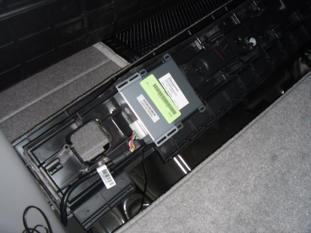

-Since I have that double floor thing, I cut out some of the extra plastic, and stuffed the Sirius tuner in there.. Perfect fit.

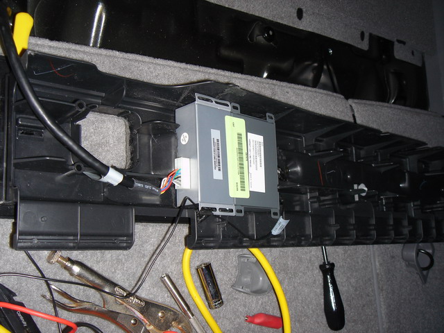

Pic 3
BTW! You will need a Toyota Y adapter (which was not included)

j0mama,
Thanks for the pics. I did my install exactly like yours and it worked out great. I only have on equestion. What did you need the Toyota Y adapter for? In my setup, I just plugged the Sirius wire to the Nav unit and everything worked.
