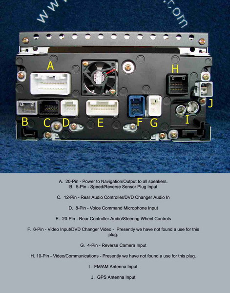

Where does the satellite receiver plug to?

Taking the Factory radio out?
To the guys that did this install with the factory nav radio, what is involved in getting the factory radio out to get the plug in the back? Is it just the silver trim around the radio that needs to be removed and what is the proper way to get it off? Man, I love working on cars but I just hate dealing with interior trim as it's always so easy to destroy if you don't yank it apart properly! Any tips appreciated!
Bob
