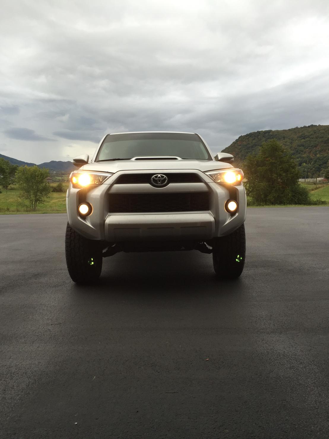

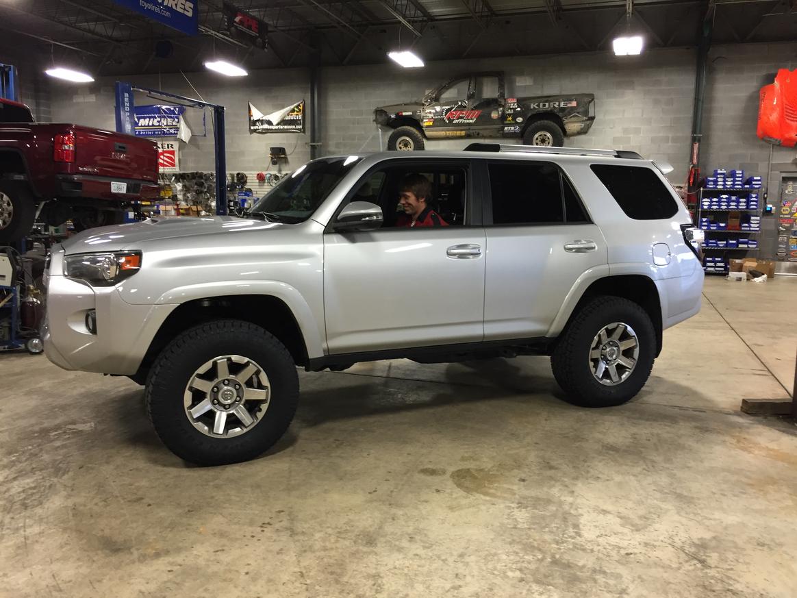

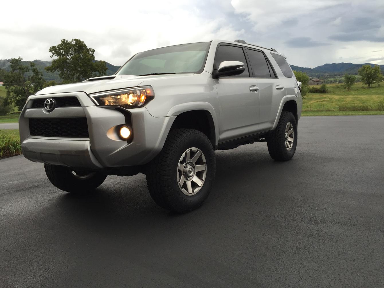

Hey all, I am new to this forum stuff but I'm looking for some insight. I recently got a 3" level & bigger tires 285/70/17 on my 2014 4runner trail. Has anyone had any problems with the steering wheel having a little shake to it only sometimes, no specific thing causing it but just a little movement in it?

1.Did you get a front end alignment? A must do with a lift

shaking is more than likely from the alignment. There is a limited list on what it could be but that will be the likely culprit. I suggest browsing the classifieds and see what other people are selling their stock rims for and competitively price yours out.

Yes! I've had it aligned twice I believe, it's weird it only does it ever so often so I don't know if I should be concerned or not. But thank you for the info on the wheels and tires! I'll definitely look into all of that!

rotate the wheels. put the front on the back and back on front, might be a balancing issue.
I agree with KneeCaps... I'm guessing it is a balancing issue. Did you have your tires road-force balanced?
Alternatively, does the shaking occur at the same speed everytime? Or on the same road everytime?
If it's at the same speed, it's your balance. If it's on the same road, it could just be the pavement. There is a ramp in the parking garage that I use when I go to work, and it gives feedback in my wheel every time. It happens on my truck and my car. The ramp looks perfect, so I have no idea why it happens, but it happens. Maybe something like that is happening to you too?
It's really no certain time that's why I'm having a hard time trying to figure out what needs to be fixed, sometimes it can be going on an incline and sometimes it can be just on a flat road. Not frequently just once in a while!
i recall some thread mentioning a special "plate" or something toyota uses for balancing their wheels. since your still using the stock wheels now, i guess another question would be who mounted/balanced the 285's? toyota service or other?
