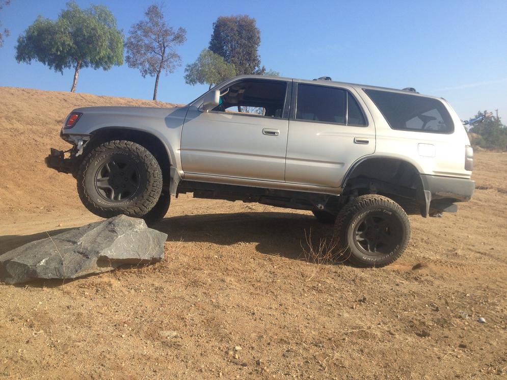

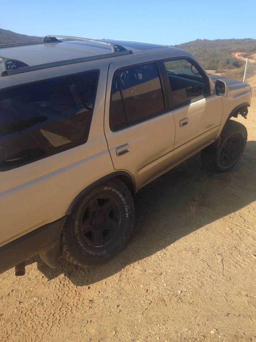

I just got off the phone with toytec and with the ICON 2.5 he wasn't positive if I needed them. pretty much I purchased them without the bump stop ext. my tire size is 265 75 r16 (31"). if they ended up rubbing then ill get them. my whole reason for this is I bottom out bad with the set up I have now. without converting to long travel I want to push the limits where I can.

hm, with 265's you may be ok. My truck was fine until I tossed on the 285's. I could fit the 265's all the way in at the rear to the bumpstops and they didn't hit the firewall in the front.
