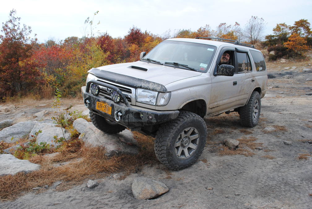

There may be some more truth to this when we're talking about the axle compressing at an angle (flex) vs the axle just going straight up and down. But at the end of the day, extending the bumpstops by the amount of lift is not the correct way to do it.
