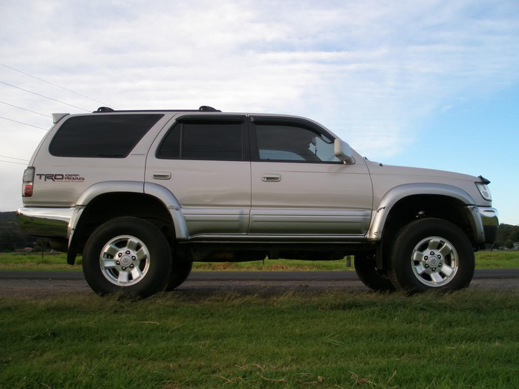

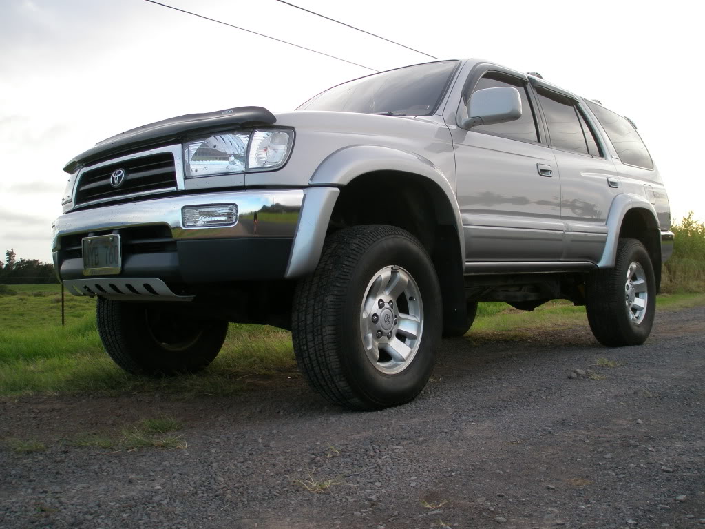

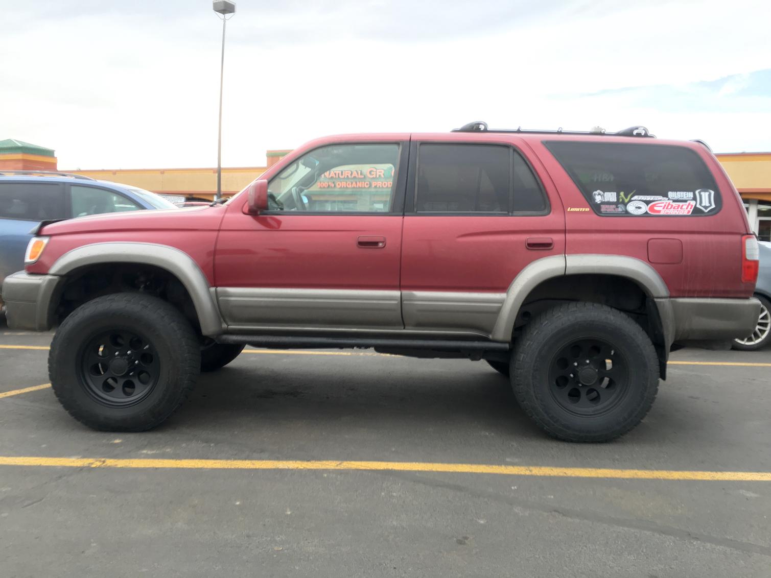

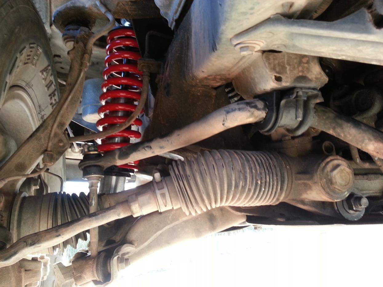

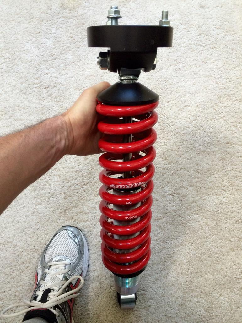

I'm running the Toytec 3" BOSS with 650lb coils. I also switched out all the usual bushings, including the power steering rack, when I installed mine. It's cheap and fairly simple to do while installing the lift. You can see the new black bushings in the 3rd pciture. I can say with absolute conviction that the ride is completely different; it's vastly improved. However, having the 650lb coils makes the ride noticeably firm. I did this because my long term goals for modifications are going to add weight. I also pull a trailer on occasion. It's not uncomfortable but it is certainly "1-ton truck like". Regardless of the setup you choose, you're going to have a nice ride and a nice look!
Here are a few before and after shots with stock wheels and tires. Also a shot of the coilover new out of the box. The last picture is with the 33" Nittos on 17" wheels.

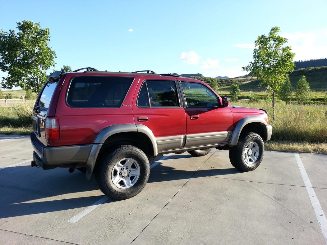

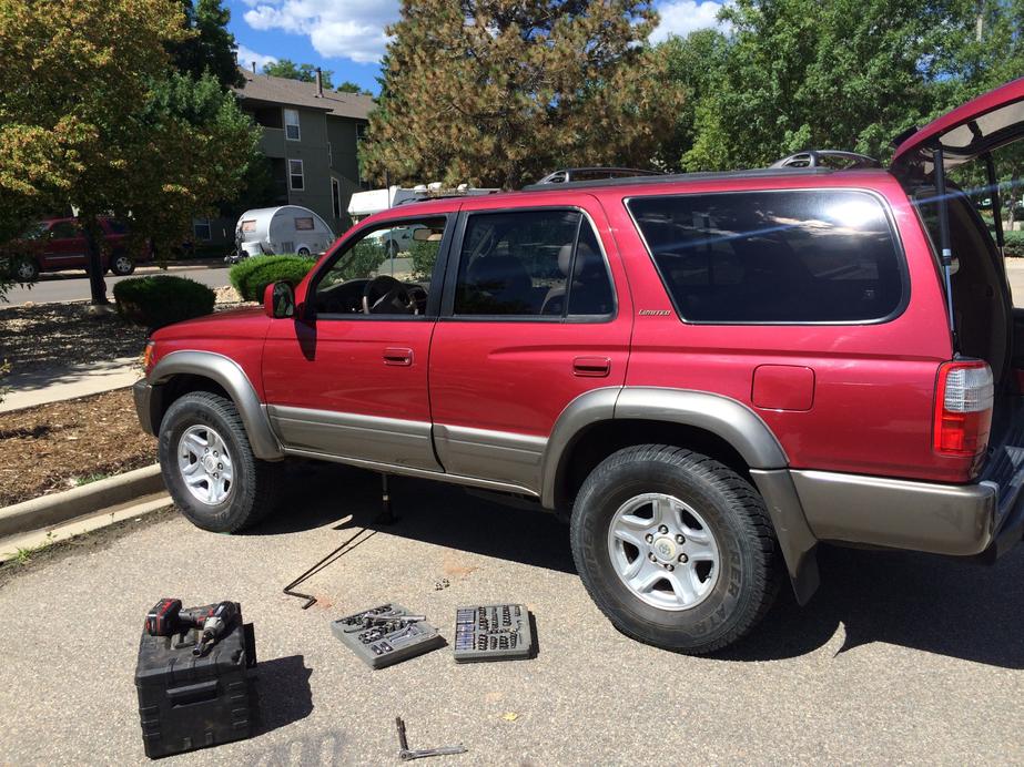

Your lifted 4Runner looks really good. I know with the coil overs it is really easy to get the truck to sit perfect. I would still like to see a gen 3 4runner with the bilstein 5100 toytec lift installed. Thanks
It'll be virtually the same. The only difference is how you adjust the spring perches on the front shock. If I understand correctly, you'll choose the highest perch on the shock assembly for your 3" lift. There should be 3 perches to choose from. The rears are not adjustable for height. The highest perch should get you level front-to-back.
