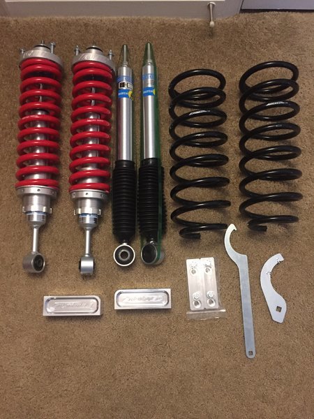

Good day all,
I have a 2017 Sr5 that i installed 5100 all around with The Toytec 3" coil kit up front and 2" Springs in the rear.
Also have the JDA UCAs.
front
521600 Toytec Coil Spring
Bilsten 5100 ( Set at lowest setting as per Toytec instructions)
and a 1/2 Toytec spacer to achieve the full 3"
Rear
2" Toytec SuperFlex
My questions is... what would be the best way to get another 1" lift for a total of about 4"? didnt want to do body lift but if its not that big a deal willing to do it.
The rear i was thinking ICON 3" coils or 1" poly spacers.
The front i need some recommendation/advice with...
I already have 1/2" metal Toytec spacers in the front and on the driver side i added a 1/4" spacer for the lean.
This kit with top plate: https://www.toyteclifts.com/521600-kit-toytec-3-lift-front-coil-spring-kit.html
what would be the best way to get another 1" upfront? I know the 5100s have 3 settings upfront but the site said the recommend only installing with clip on the lowest setting..

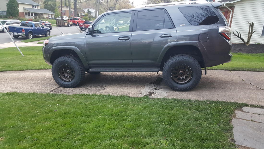

I have the same kit, Ultimate kit to be exact. I thought about the same thing so I got in touch with ToyTec. Not only will it lead to terrible CV angles, you will also likely damage your shocks. From what I was told, the 5100 they use is not designed for anything over 3" on the 4R Going higher will likely lead to bottoming them out and damaging them. What I did was add a 3/4" spacer to the back and i'm running a 295. Really no need for anything more IMO

Thanks for the info man. Your ride looks great.
