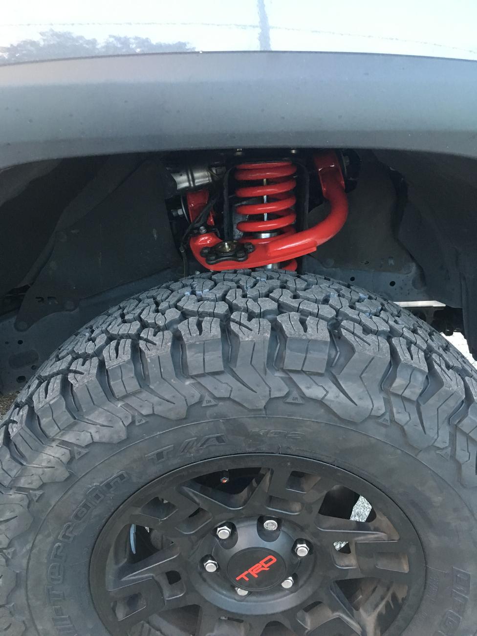

My toytec ultimate's which I believe are the same as that kit has 600# springs. Call toytec and ask if they have options ! Oh and mine has kdss so no radiator or swaybar drop.

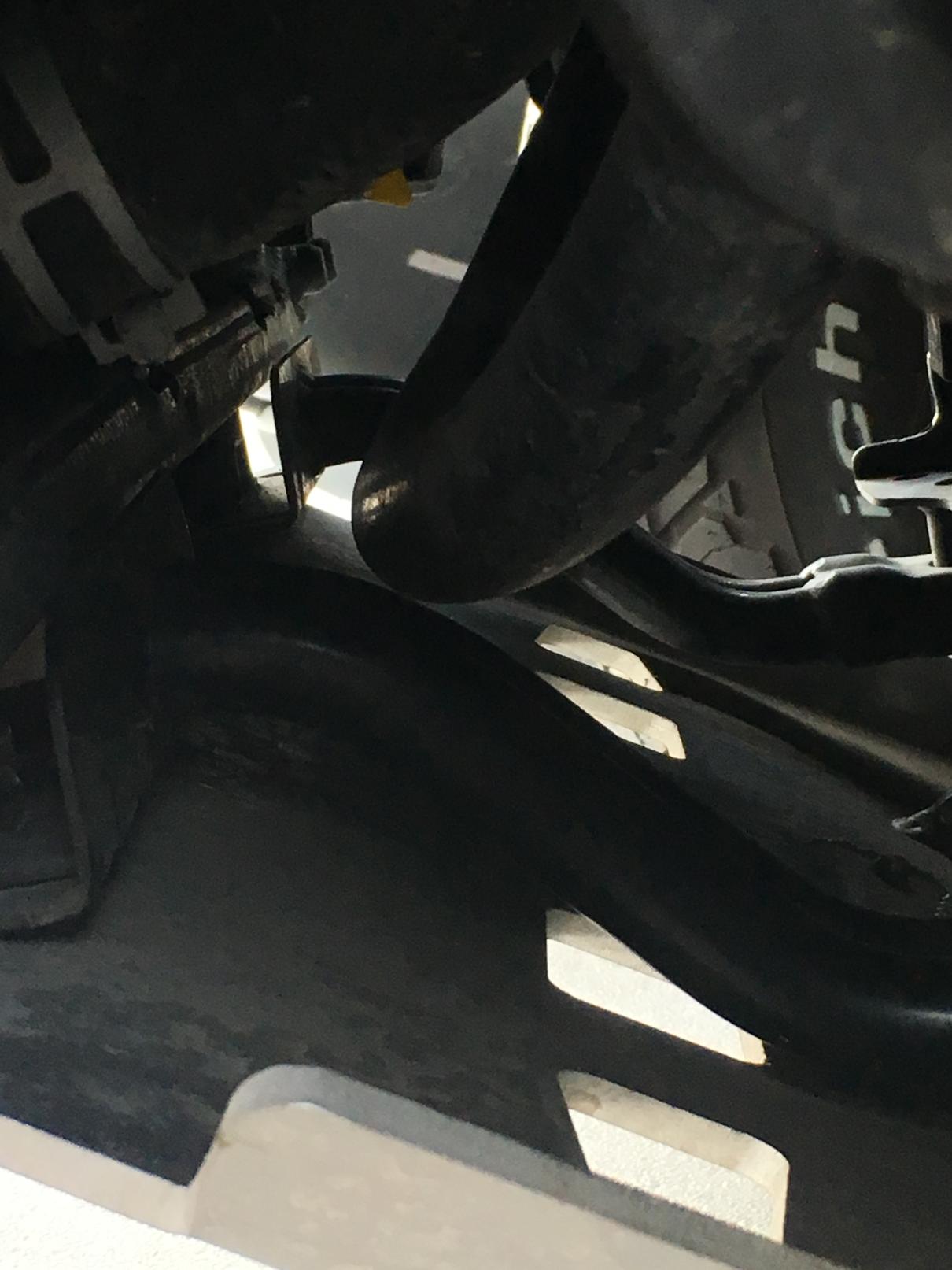

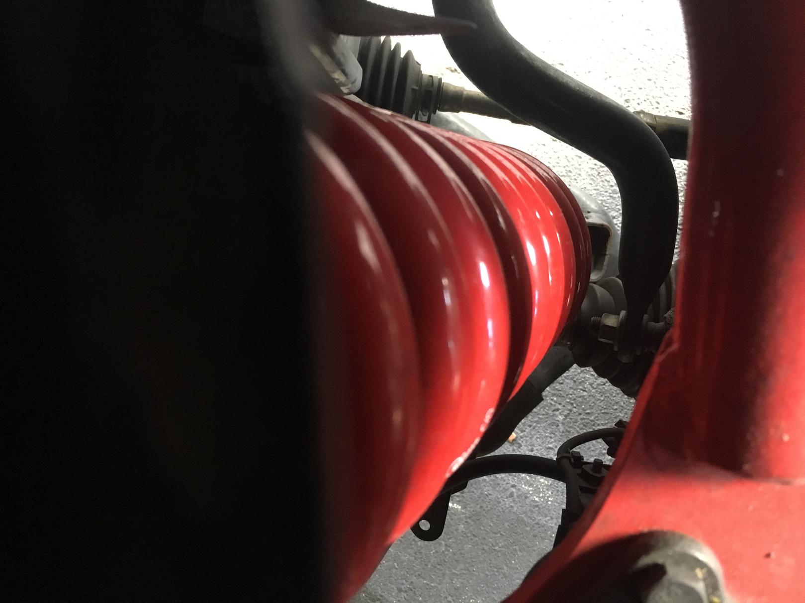

i found that the sway bar relocates were pretty much a requirement to keep adequate spacing between the springs and sway bar (could this be mitigated with extended sway bar links?) Once that is relocated forward the driver side radiator support bracket (which mounts closer to center than the passenger side) did come into contact with the sway bar and actually has just enough clearance with them installed.
discussions with toytec indicated this is an disassembled version of the Ultimate kit without the new top-hat. springs are the same.

How close are your UCA's from the tire? I had my Toytec lift installed with the SPC's and one side has an inch+ but the passenger side has maybe a quarter inch. It rubs in reverse so I have to go back Monday for them to re-adjust the alignment.
