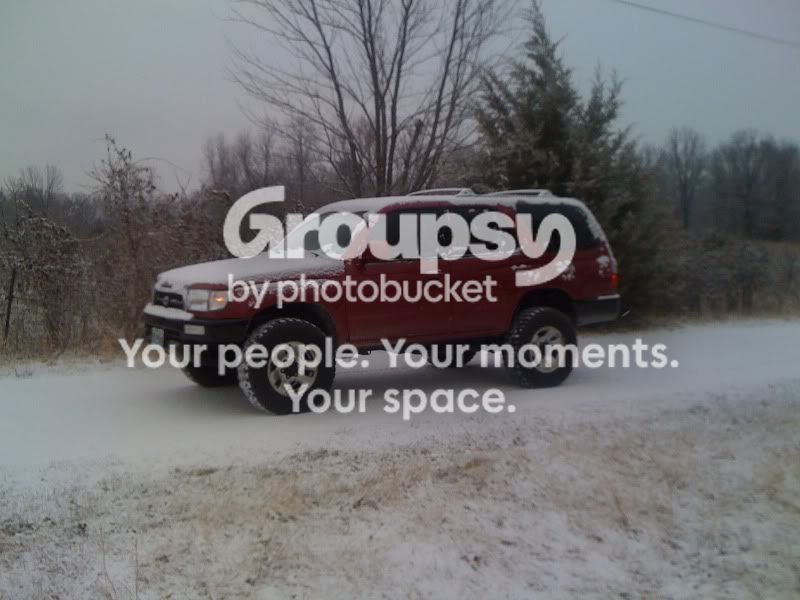

3" lift on 265/75/16's, so they're just under 32".

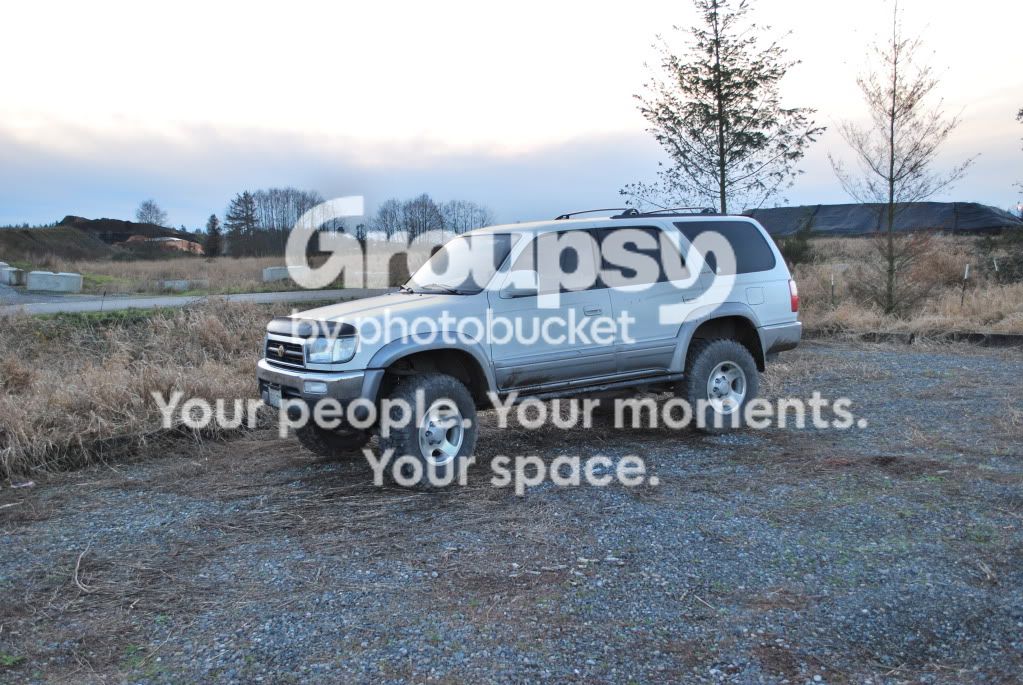

Sometimes I wish I went with a 33 but for me the cons out weighed the pros.
Possible rubbing of the a-arms unless your running different wheels or spacers. Which I didn't want to do at the time, but ended up doing any way for the wider stance.
Regear might be needed depending on your stock gears and location and driving stlye. Loss of pep and mpgs and the fact I havn't got stuck with the 32s make me happy with them.
Sure 33s will look cooler but there will always be bigger tires. haha

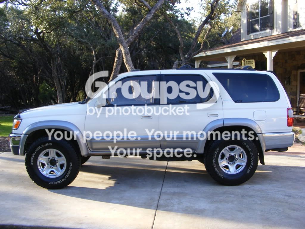

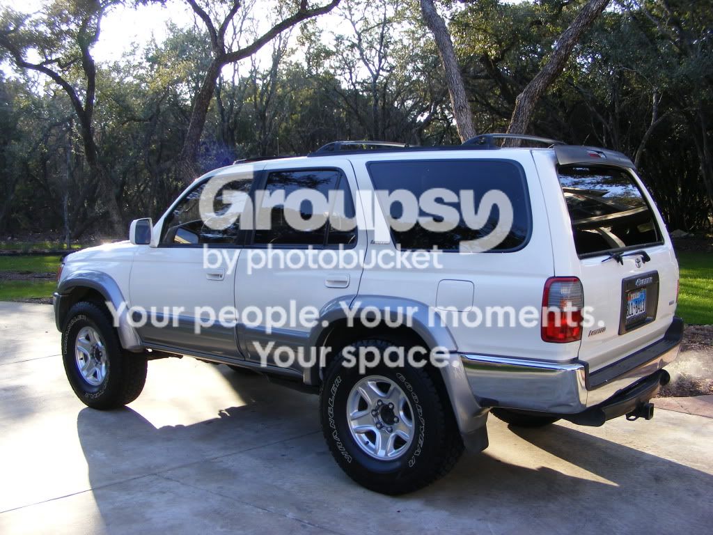

Here's mine with 245's. The guy at the speed shop told me they just to say smaller then the 265's. When I took this picture, I was running the Toytec 3" Spacer in front and 890 coils in the rear.

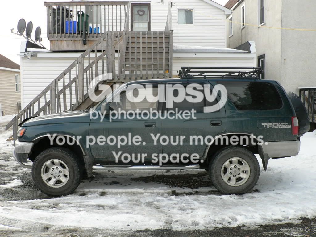

I run these in the Winter months.....they are 245/70/R16.

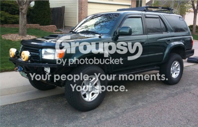

265/75's. Only have the 891's on rear, but I'm going to continue running them, even after lifting the front 2". Too many people are having to get wheel spacers and body lifts with 285's while offroading, which is more money and stuff I don't wanna bother with. Also I think it's harder to tell it's lifted with 33's after 2-3" lift. And I want more flex/tuck while offroading.
