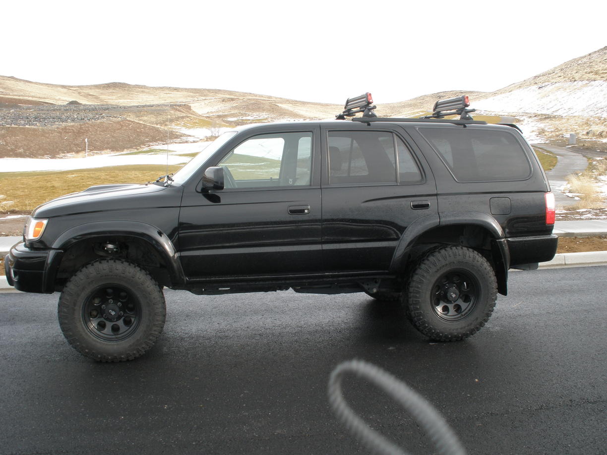

I don't have a 3" lift, so my 32's look good to me. If you're going with coilovers in the front, and you give yourself 1/2"-1" of rake (front lower than rear), the 32's will look great. I see no reason to go bigger except for the 'big tire' look....which you can kind of accomplish just by getting an aggressive A/T or M/T tire....

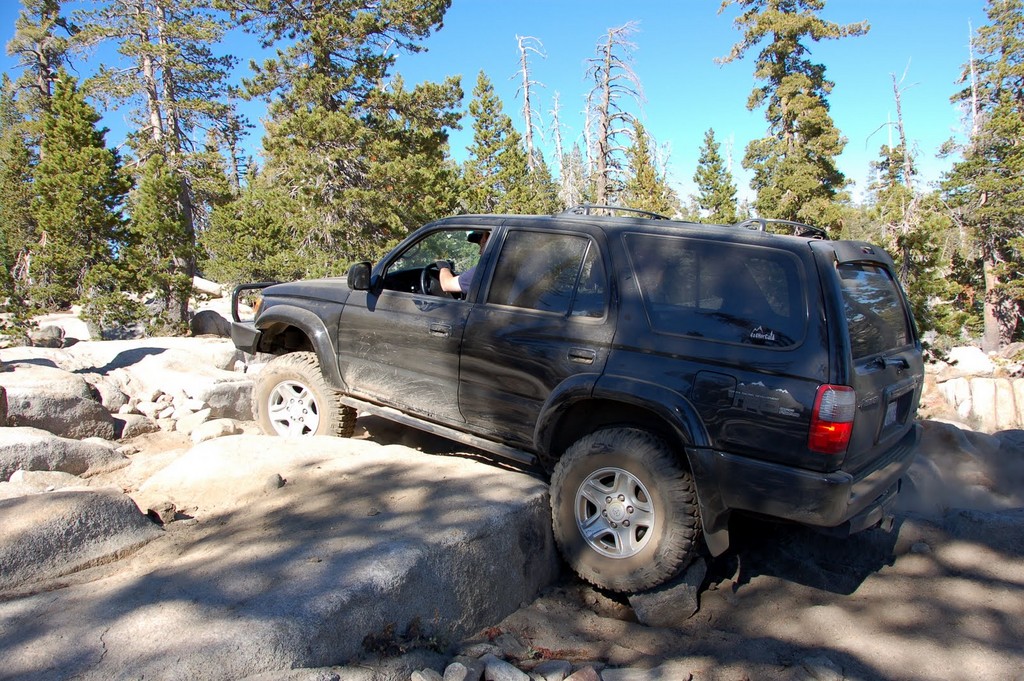

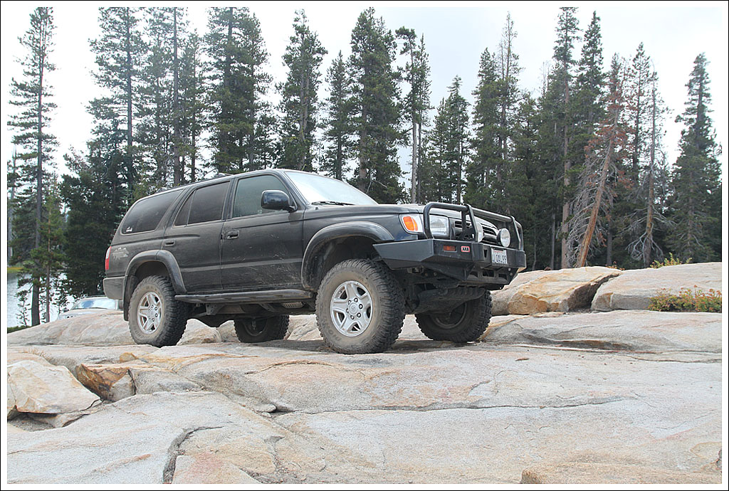

I'm running 265s with a SS1.2 lift and am very happy with this tire size. They are tall enough to provide clearance under the axle on the trail, but not so tall that I have to re-gear.
