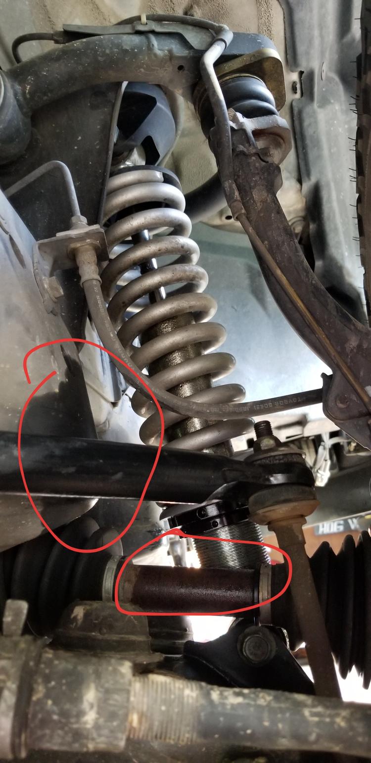

Bought a set of the Toytec Boss coilovers in July of 2015. Noticed a leak the other day coming from passenger side spring. Called and they said a tablespoon of grease could leak if a seal fails, however this is way more. Cleaned up and checked it again today and it has leaked quite a bit. Not sure how long it has been leaking bit can't feel or hear difference in ride right now.
I have only put 18k miles on 4runner since the suspension was installed. It's a daily driver and doesn't leave the pavement. Not super impressed. I can spend $300 and get a new shock, but wanted to see if there was a better option and if this is a common occurrence?
