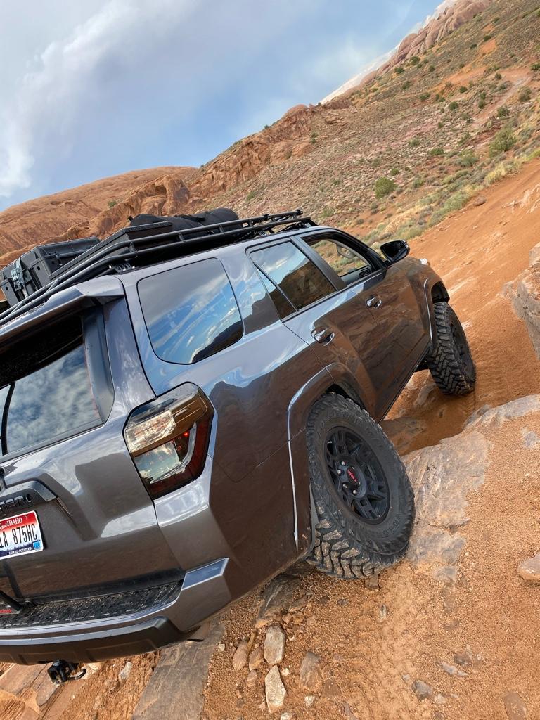

My recent experience in Moab on my 34 in tires proved that I need to do something ... so bump stops were the obvious choice ... as I won’t or don’t plan on doing full suspension until sometime next spring or summer

Attached is one pic of that tire just too tucked up in there ... causing my fender liner to wanna buck off due to rubbing ... (toytec blocks were NOT installed in the first pic)

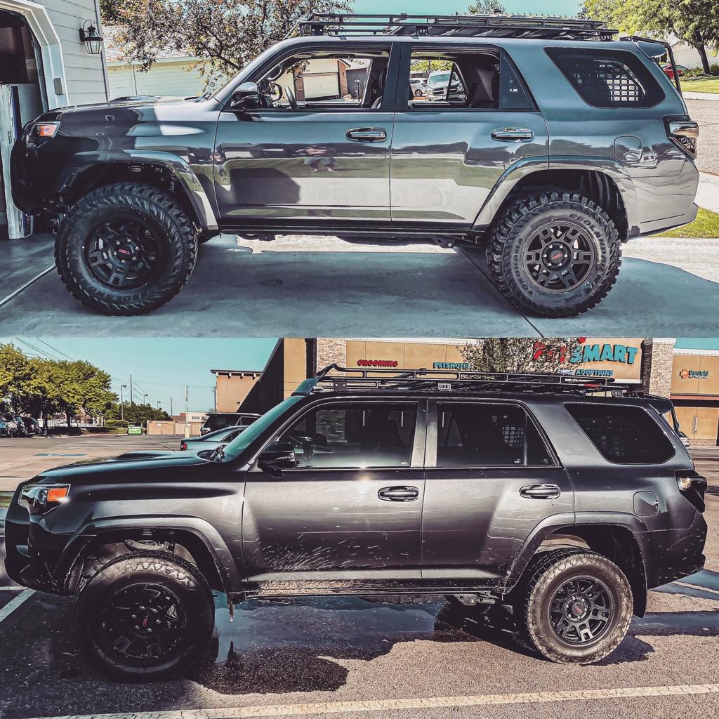

I am running a revtek leveling kit (so no suspension upgrade) ... 2in rear and 3 in front with a dif drop ... nothing else as far as UCA’s or anything ... I was planning on doing a full suspension upgrade sometime next spring or summer ... but for now ... that’s her!
Attached is what it looks like now @trdyotarunner in IG for more pics in case you wanna see some articulation pics of any kind and the runner in varying degrees of ‘stress’ ... lol
truck looks great man.

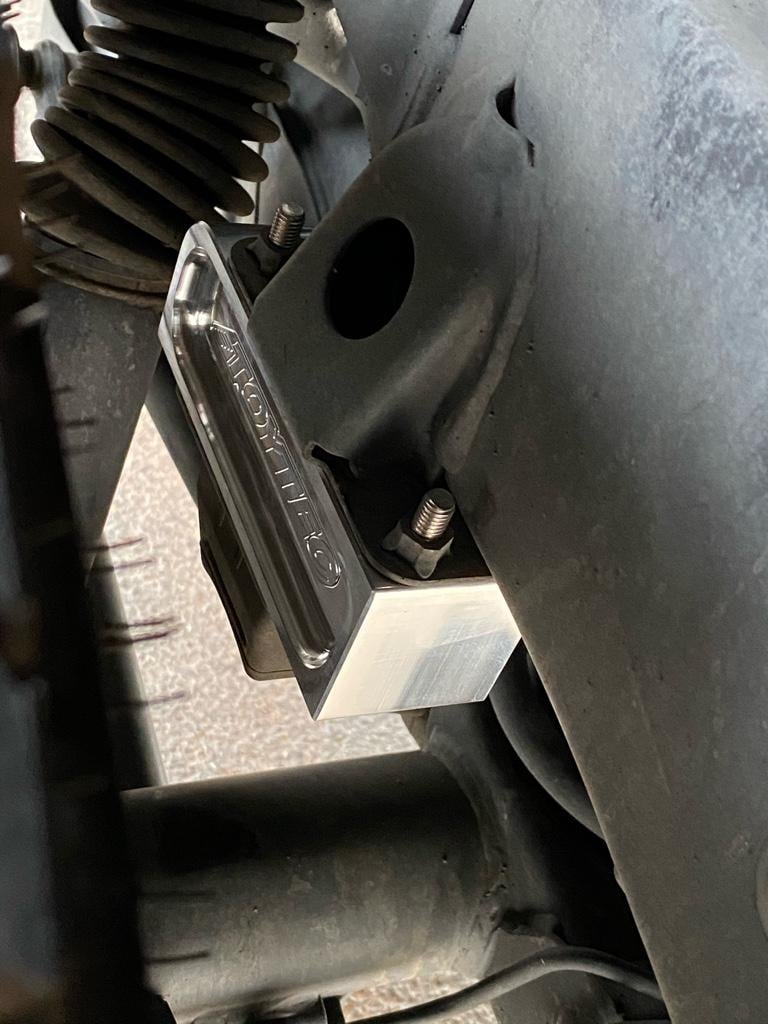

I have the energy suspension bumpstops on my fronts and they've worked great. I'm currently running the toytec bumpstop extensions in the rear which resuse the stock bumpstop as shown in the picture above. 2" lift in the rear. They work great limiting the uptravel of the tire into the wheel well, and limiting the suspension from overcompressing. I have hit them through some dips and they are not soft though because you're still hitting stock bumpstops on an aluminum block. So durobumps probably provide a cushier hit.
