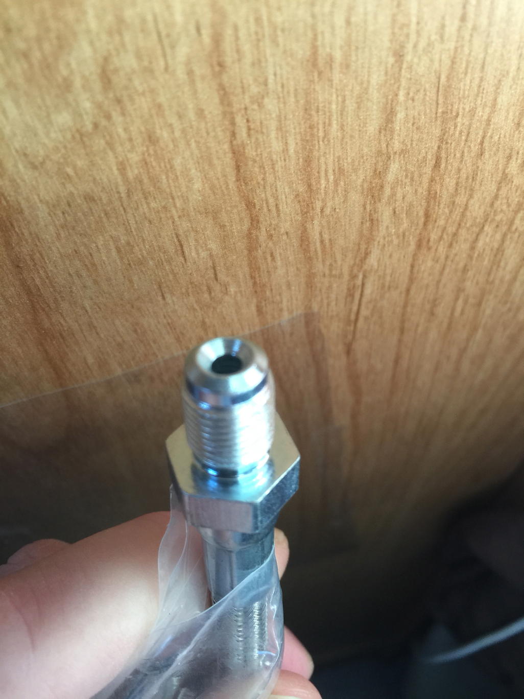

I got the rear extended brake line for Christmas and I was going to install it today. After I got the OEM line off I noticed that one side of the line is different on the toytec line.
On the OEM line, the axle side of the rubber brake line is concave ===<
On the Toytec line, the axle side of the brake line is convex ===>
I felt inside the hardline fitting on the axle and internally it is convex which matches with the OEM line. I would have expected the Toytec line to be concave like the OEM line. Based on pictures on the web, it looks like the Wheelers offroad line has a concave end just like the OEM brake line.
Am I missing something with this or does this seem wrong?

Sorry it took me so long to get back to this. I went out and took the brake line off again to verify the problem. I snagged a picture of the stock line vs the toytec line. This picture is the axle side of the brake lines.
If you look at the ends of each line, the stock line has an inward cone and the toytec line has an outward cone. I was under the impression that with brake lines you want to them to match correctly. If I use the toytec line I think it will reduce the amount of sealing surface area. What am I missing here?

OP, you have a line that didn't get all of the required machine work.
That fitting is an inverted flare and should be the female side of the cone and look like infamousRNR's is.
