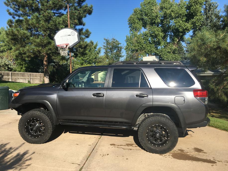

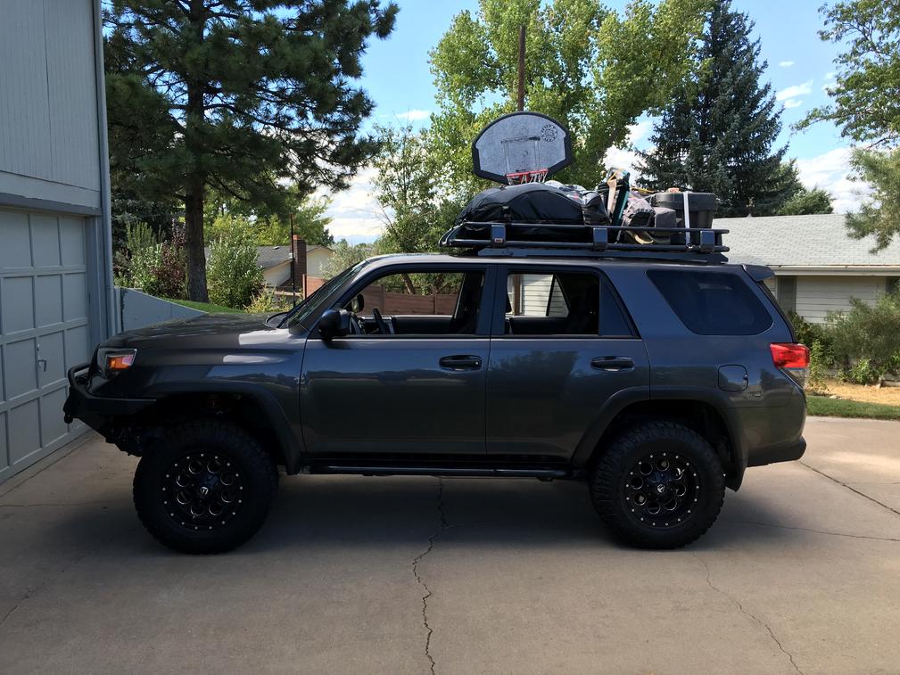

I installed the Toytec HD coils a few months ago on my 4Runner. I went with Toytec because of the claimed "2.5 inch lift with 150lb-200lb additional weight" since it was the smallest lift I could find with a HD coil. But despite having sliders, a roof rack, a completely full drawer system, a 50 liter fridge, and a heavier 285 spare, it ended up giving me a little over 3" of lift. I'd estimate I have 500-600lbs of added weight back there, so their 2.5" with 200lbs claim is way off.
I still think it looks pretty good though... I added 1.5" spacers in front (because I was expecting 1.5" in back with all my weight), so I still have quite a bit of rake. Here are some photos:
Before:
After (HD coils and front 1.5" spacer, same weight in back):
